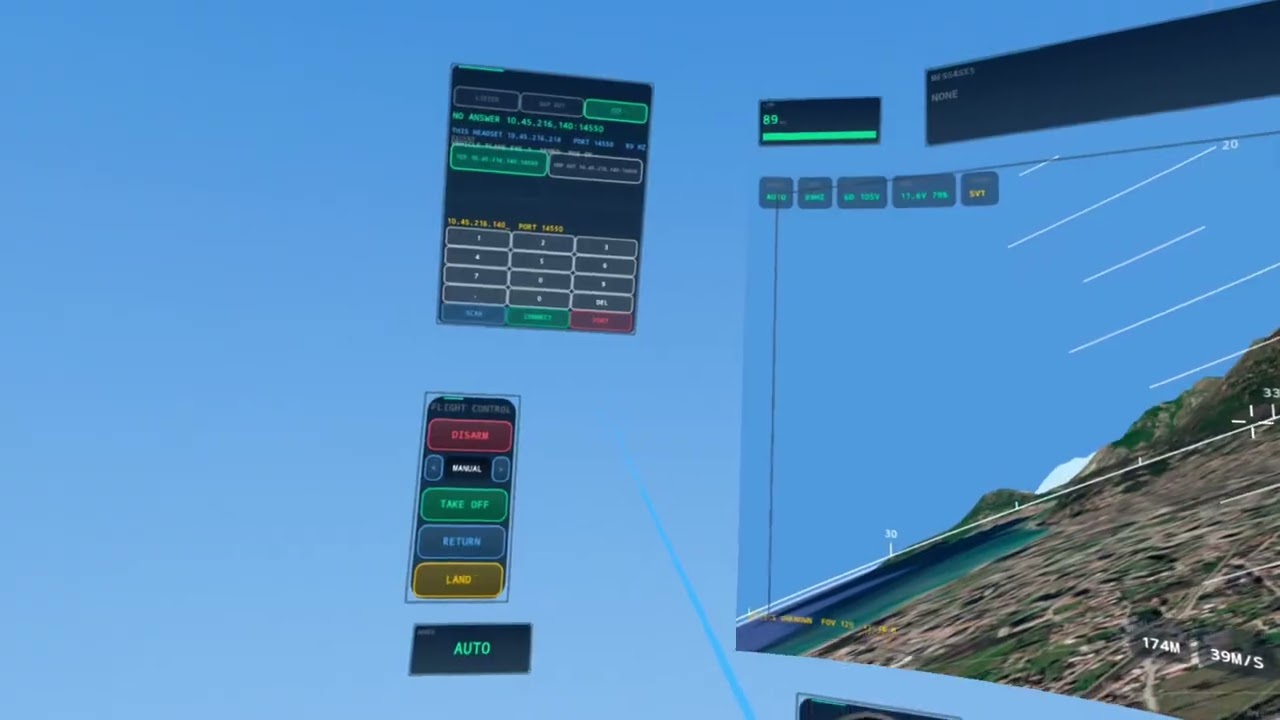

I must admit , i dont have proper fpv gear , so i made one from what i had :slight_smile:
