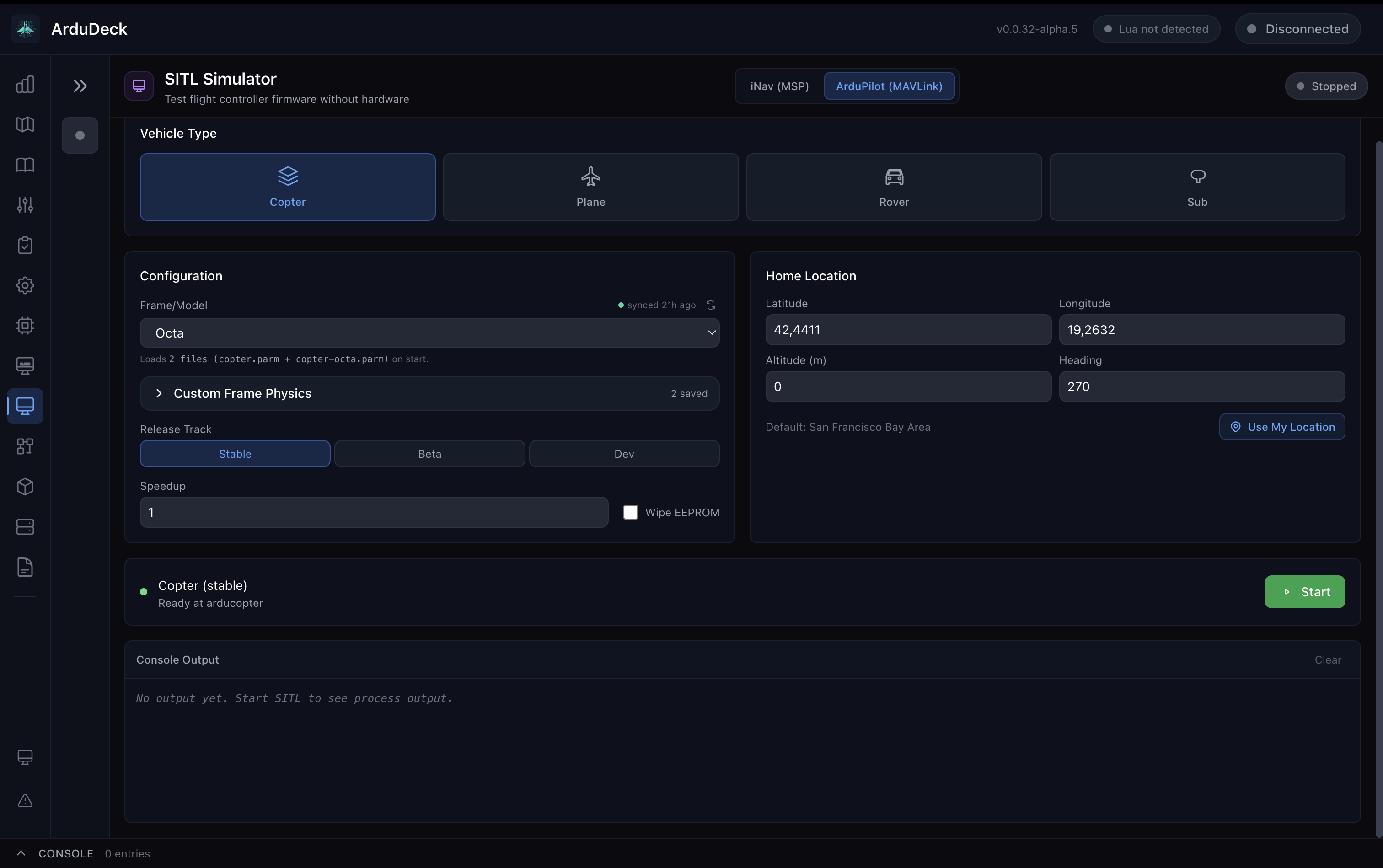

Is there a way to set or change the simulator home position?

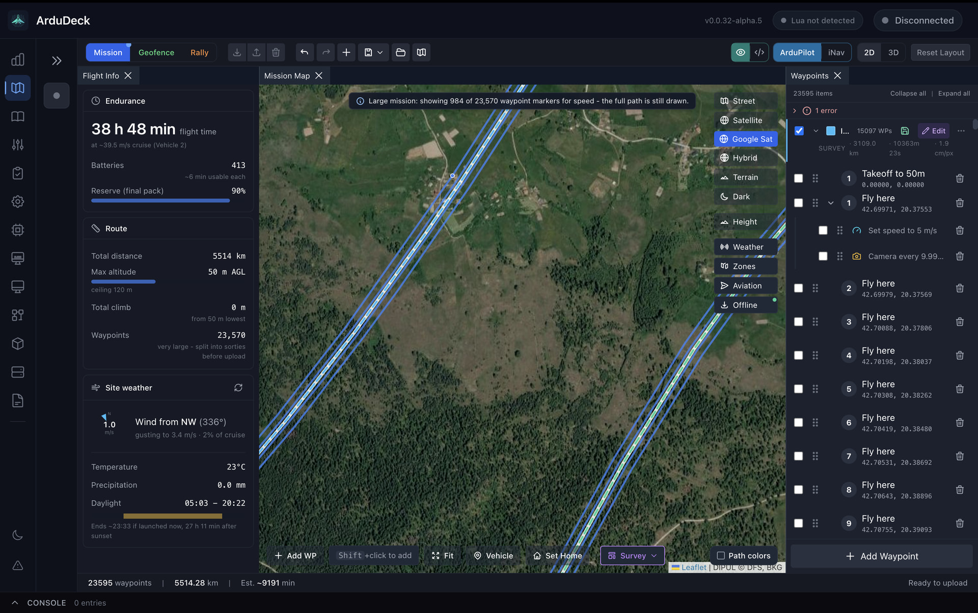

ArduDeck Alpha 32.5 is out
A small release this time, focused on planning performance and a new pre-flight briefing.

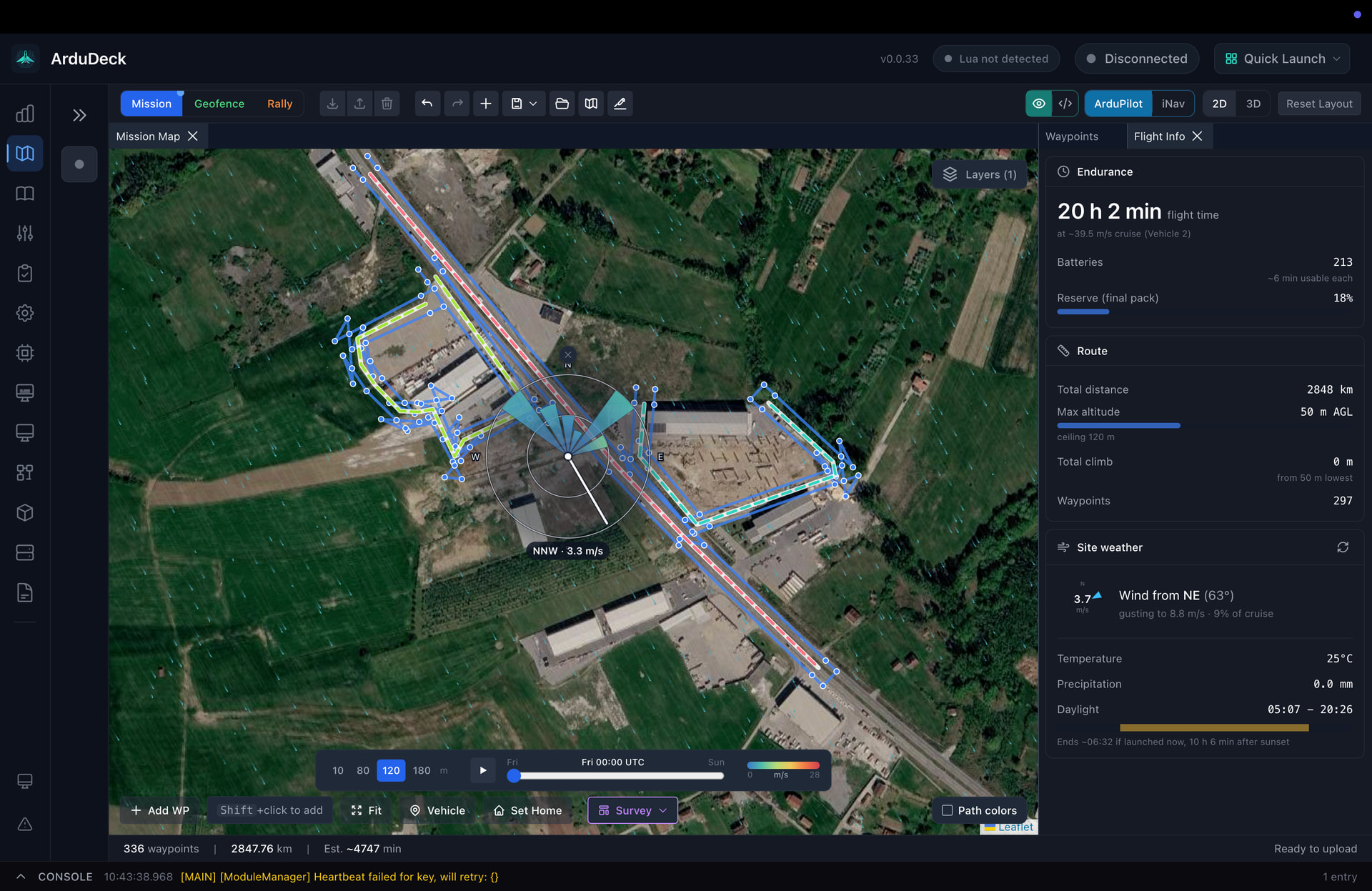

New: Flight Info panel
A live briefing for any mission or survey, built from your vehicle profile:
  • Flight time and battery count needed, with reserve on the final pack
  • Distance, furthest point from home, altitude range and total climb against your ceiling
  • Live site weather, with wind drawn as a compass and gusts shown as a percentage of cruise speed
  • A daylight bar that tells you whether the flight lands before sunset
Mission planning performance
  • Telemetry map no longer lags during live flight
  • Large missions and surveys render much faster
  • Waypoint markers reworked into clear start, end and key-command pins instead of plain numbers
Also
  • Survey and Corridor are now one button with a dropdown for the pattern
release Release Alpha32-5 Survey Optimization · rubenCodeforges/ardudeck · GitHub

I think reserve should be applied to all packs.
Hold that thought for the next release , im brewing something that should be very interesting for survey planning :smiley:

What am I missing?
I also tried the update button (V.32) but it was the same as before that it didn’t recognize the latest version (V32.5).
Edit: Tried 32.5 and the sim page is stil blank.
Can you please open the console , see if there are any errors ?
Found it , your are not going insane and you are not missing anything , my fault , the new version will have the fix , its coming soon. Thank you for the finding.

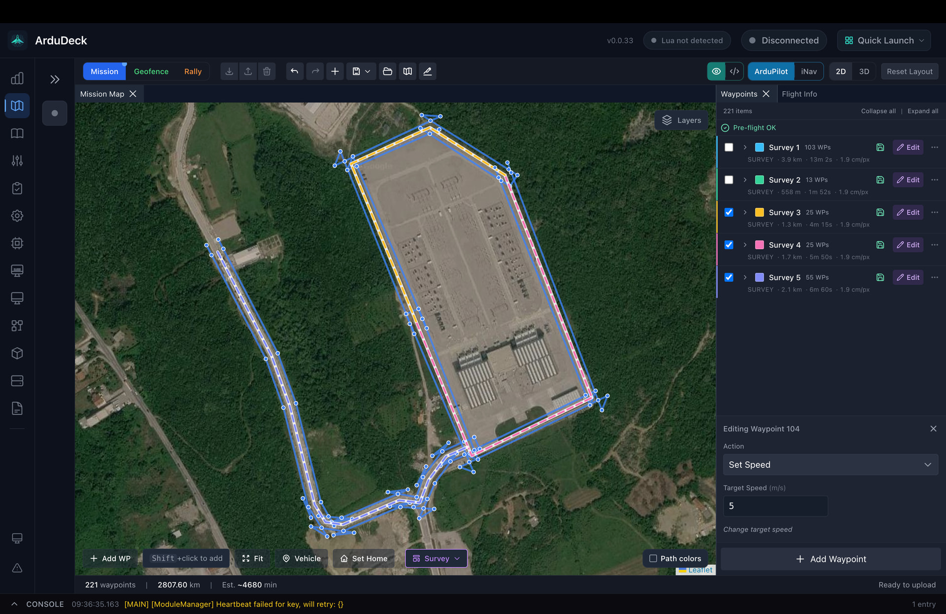

Alpha 33 of ArduDeck is out. This one came from a contributor who flies commercial surveys, and it focuses on the part of the job before the mission: drawing the area you want to cover.
What’s new
  • Area Editor - a dedicated full-window map for survey areas and corridors. Draw areas as polygons, rectangles, or circles, draw corridors as a centerline with a swath width, add as many as the job needs. Cut
no-fly holes, split an area, grow/shrink a boundary by a margin in meters, and measure distance and area as you go. Import and export KML / KMZ / GeoJSON.
  • Live flight briefing - covered area, flight distance and time, batteries needed, GSD, photo count, and data size, based on your active vehicle profile. Hectares/acres and meters/feet toggle that sticks.
  • Send to mission - hands the planner exactly what you drew as survey groups, carrying the editor’s survey settings across (a corridor stays a corridor, no re-derivation). From there it is the full planner: tune, split into battery-sized sorties, check the terrain altitude profile, upload.
  • Forecast wind overlay - animated wind across the telemetry map, mission map, and Area Editor, with altitude pills (10/80/120/180 m), a forecast scrubber, and a click-to-place wind rose. Open-Meteo data, no key.
  • Quick Launch - pop the Area Editor, MAVLink Inspector, and Telemetry Dashboard into their own windows for a second monitor.
Full notes and screenshots: https://ardudeck.com/blog/ardudeck-alpha-33-area-editor/
Source / releases: Release Alpha33 Area Editor · rubenCodeforges/ardudeck · GitHub
Feedback welcome in any format.

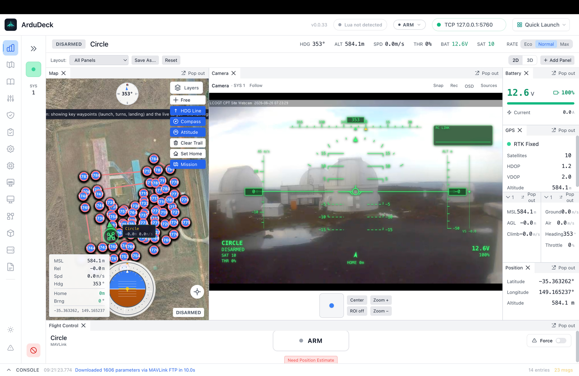

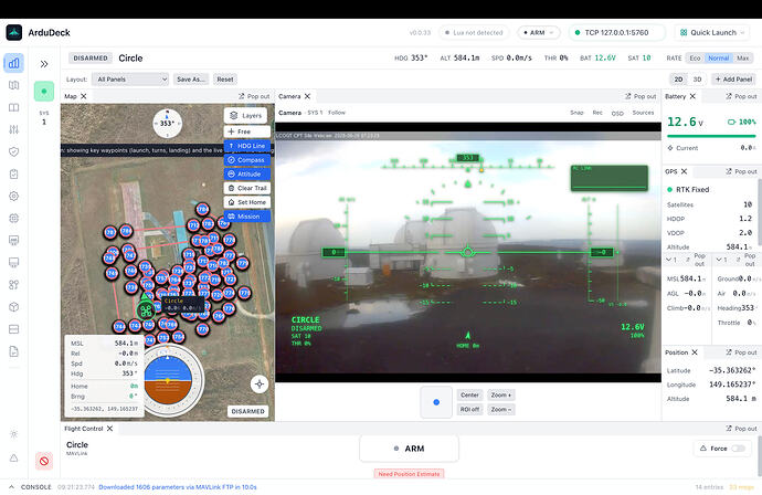

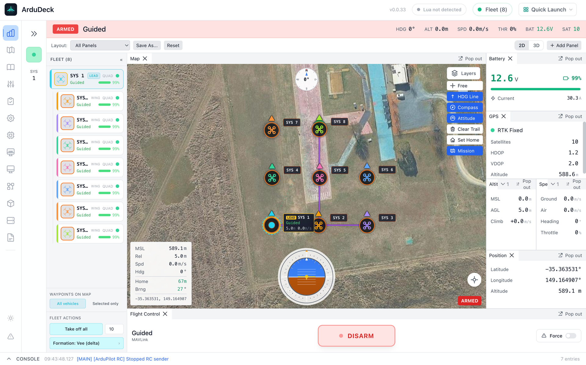

Some one asked for a Camera panel , done
comes in next release.

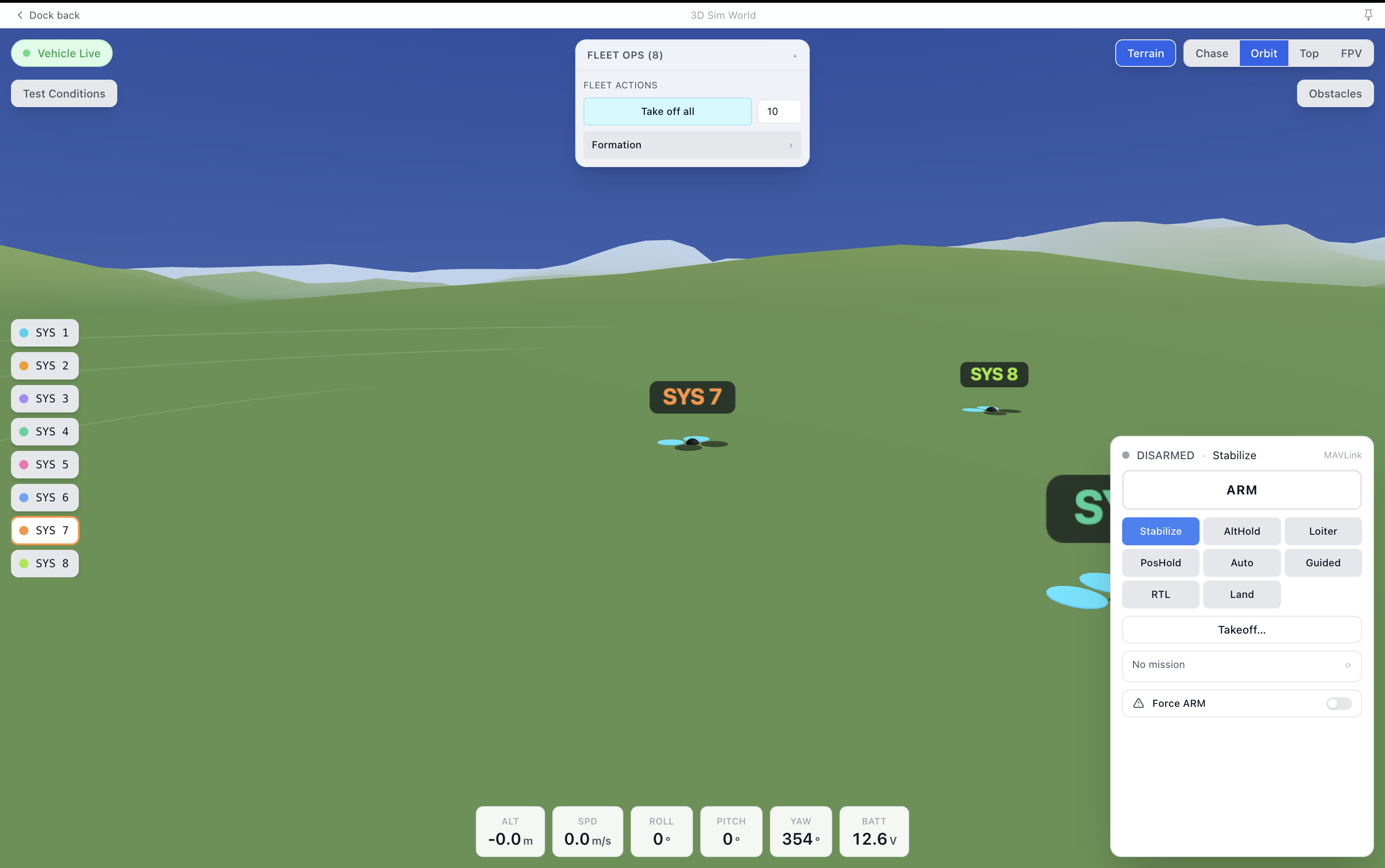

Also gues guys what the next release will be heavily about ?
:wink:

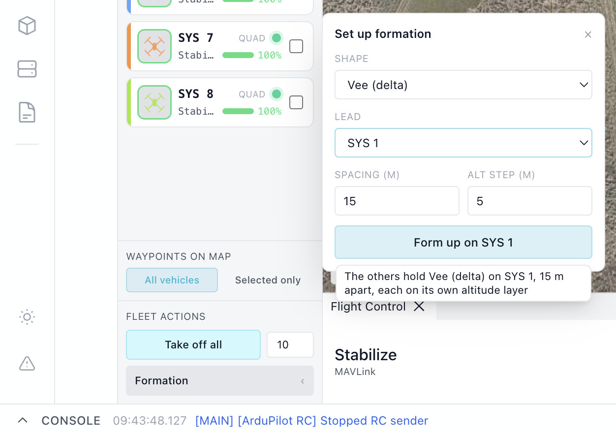

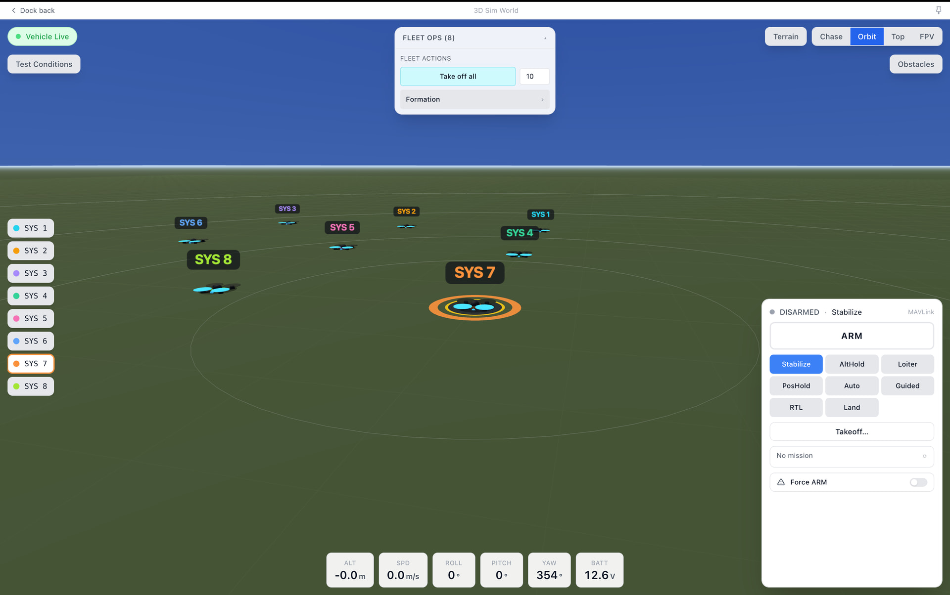

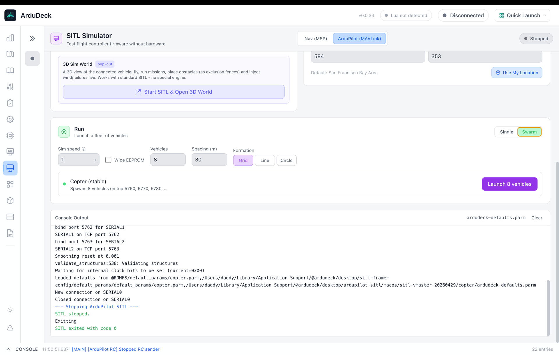

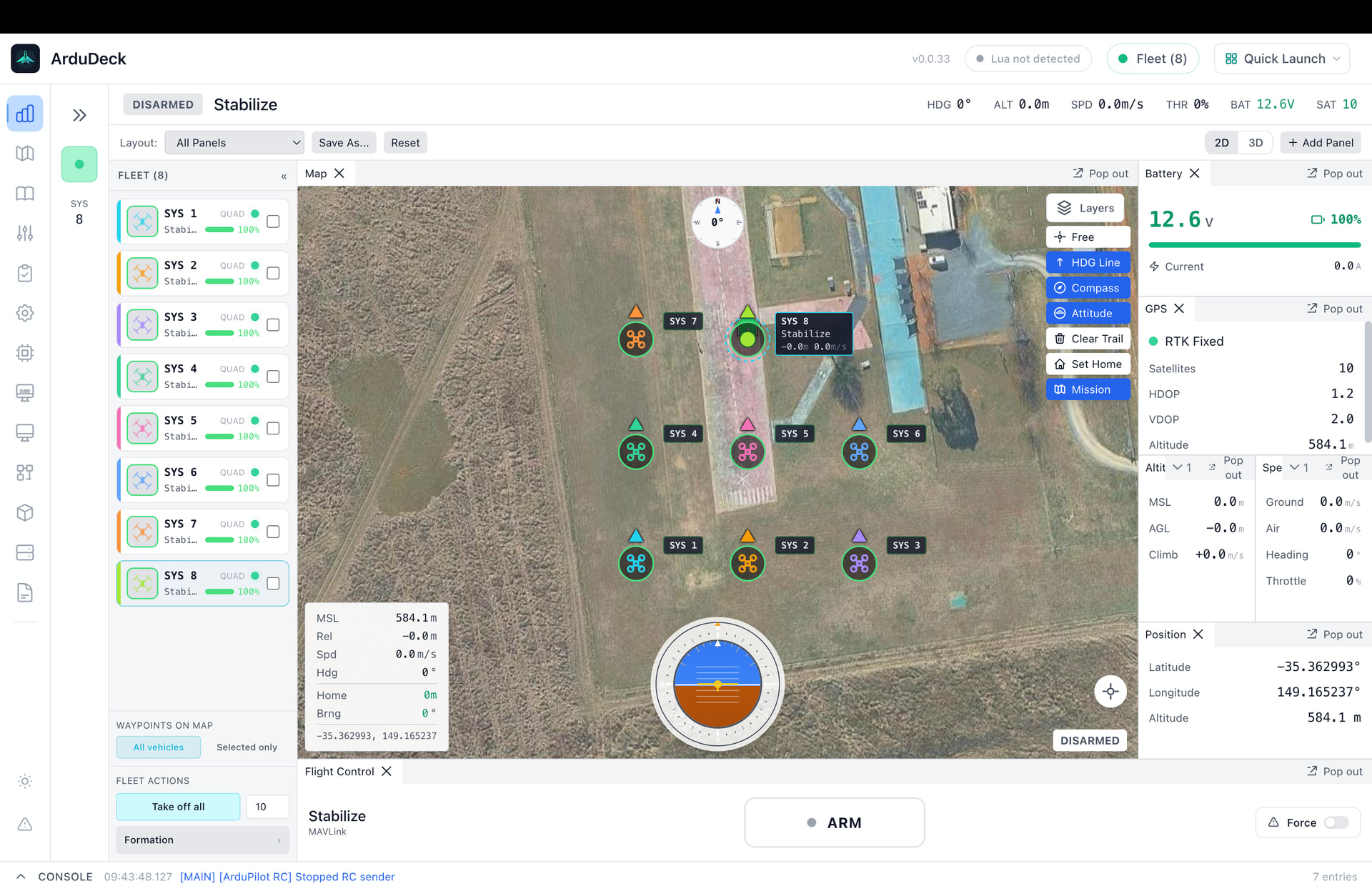

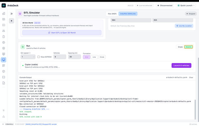

Great, can the swarm be tested in sim? Waiting for build to test.
In sim , in 3d world (whoops spoilers :D)
Sitl has now swarm spawner
synthetic view also support (svt)
