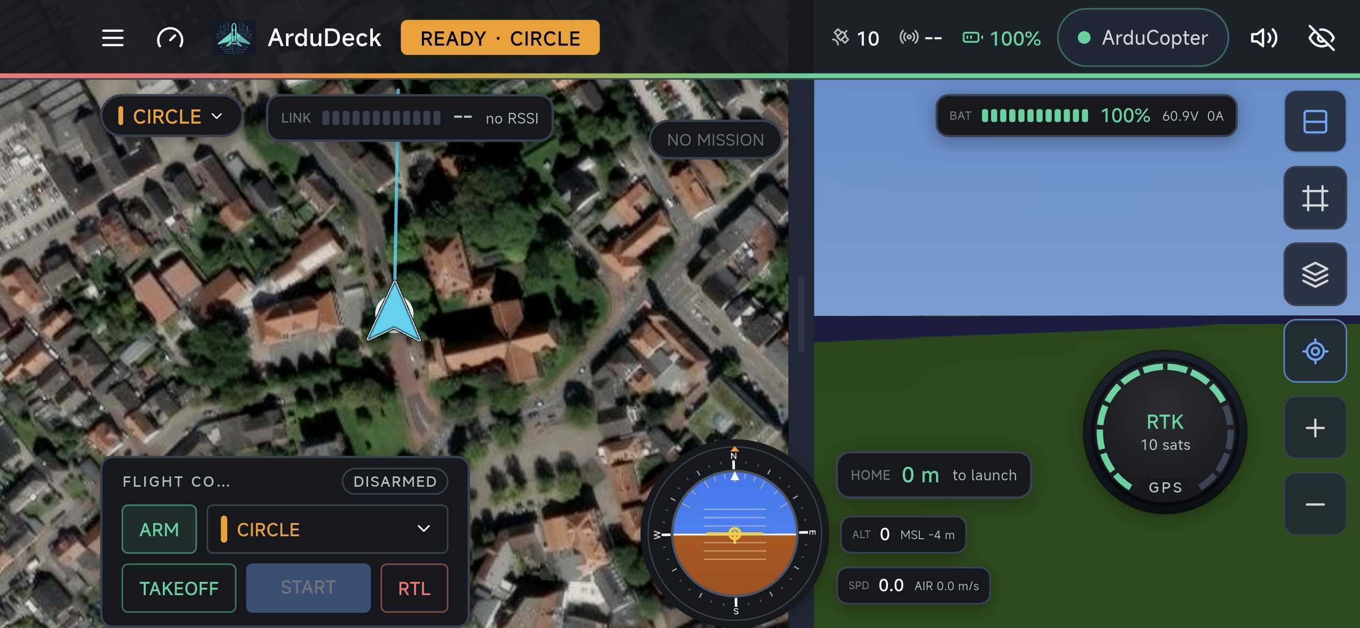

What it is

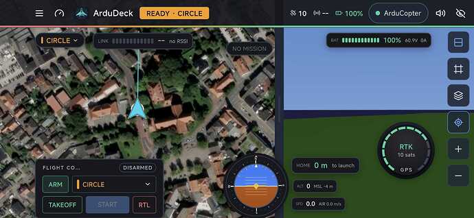

A map-first ground station meant for the field rather than the desk. The map fills the screen and the instruments sit on top of it, placed where you want them instead of in a fixed sidebar. Split view puts the map on one side and a video feed on the other. Video mode gives you the full HUD over the feed.
The FPV image in the clip is not a real camera. It is streamed from a flight simulator I have not talked about publicly yet, which is also being built here. More on that another time.

  • Connect over UDP, TCP or USB serial

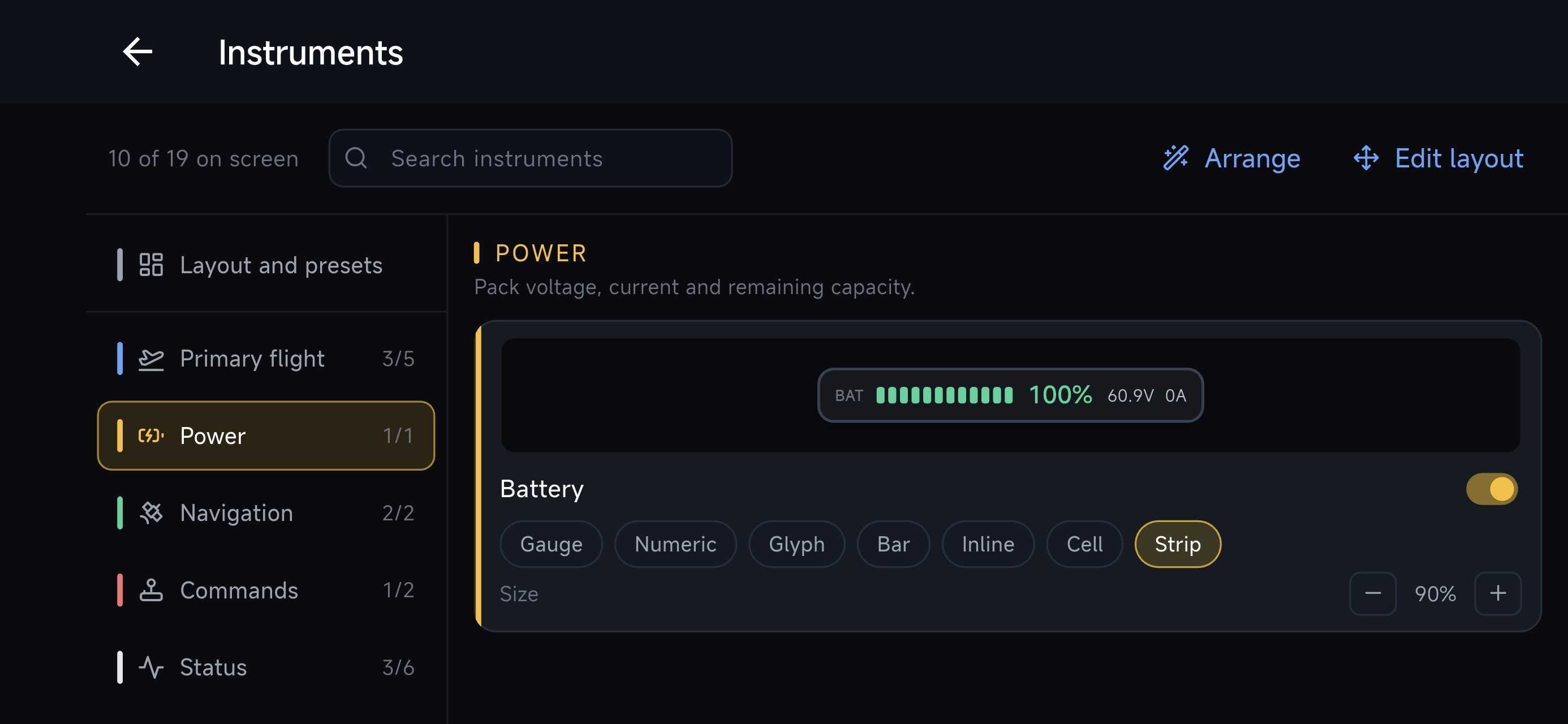

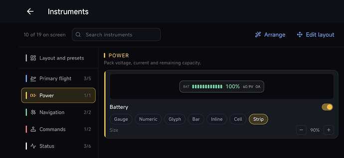

  • Telemetry instruments you arrange yourself
  • Split view, and full video view with the HUD
  • Arm and disarm with a two step confirm, take off, land here, return to home, and the flight mode picker

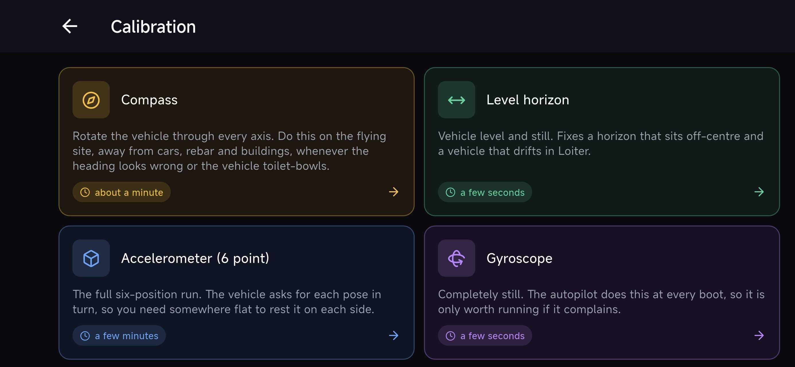

  • Compass, accelerometer, level and gyro calibration. The compass run draws a live 3D coverage sphere built from the same 80 section grid ArduPilot uses internally, so you can see exactly which directions the vehicle still has not been shown instead of watching a bar creep along
  • Spectator mode, which locks the layout and every command, so you can hand the phone to someone who wants to watch
  • Synthetic terrain view
  • Voice callouts and alerts

Anything that behaves differently to what you expected, especially around arming, mode changes and the calibration flow. Also tell me which instruments you kept on the map and which ones you dragged off. That decides what gets built next.

Is there a way to get the battery voltage to be calculated to per-cell voltage?

Re bats , yes absolutly this is exactly the feedback i need , will add it for the next update.
