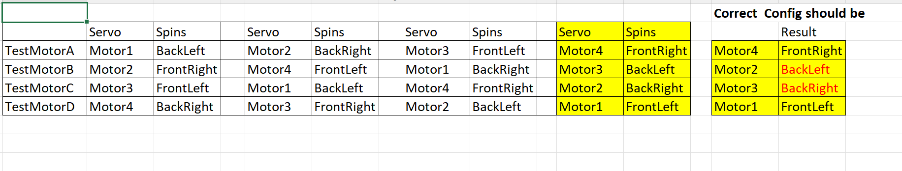

Hi Yuri, I cannot reproduce the servo settings use for my testing, so I did it all over again.
The result is : I am unable to find a correct working combination.
I tested all 16 combinations, see uploaded file.
From the test I would expect that the 5th motor configuration (motor 4 2 3 1) should give the wanted result, but the spinning rusults are the same as the last testsetup (motor 4 3 2 1).
Second thing I noticed is that on the motor test page the displayed motor configuration is not in line with the servo setup…
As a former software developer and tester I would suggest Bug?

Exactly what procedure are you following when you change the configuration? Are you moving wires? Just changing parameters? Which parameters are you changing? The chart you show doesn’t make much sense.
Also, what are the FRAME_CLASS and FRAME_TYPE parameters that you’re using?

All you need to do is run motor test and note which motors spin when pressing the A-D buttons and then refactor the servo output parameters to fix it if it’s wrong. Reverse motor directions as required either in the ESC firmware config or swap a coupe wires. That’s it. It is no more complicated than that.
Again, what exactly are you doing when you try a new configuration? Are you moving wires AND changing parameters? If you’re doing both, that’s the root cause of your issues.

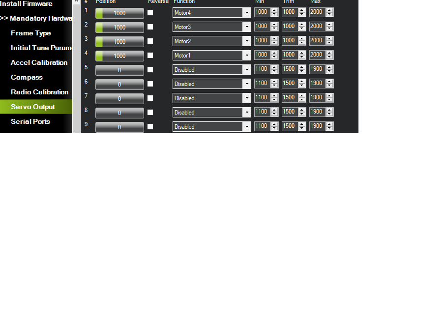

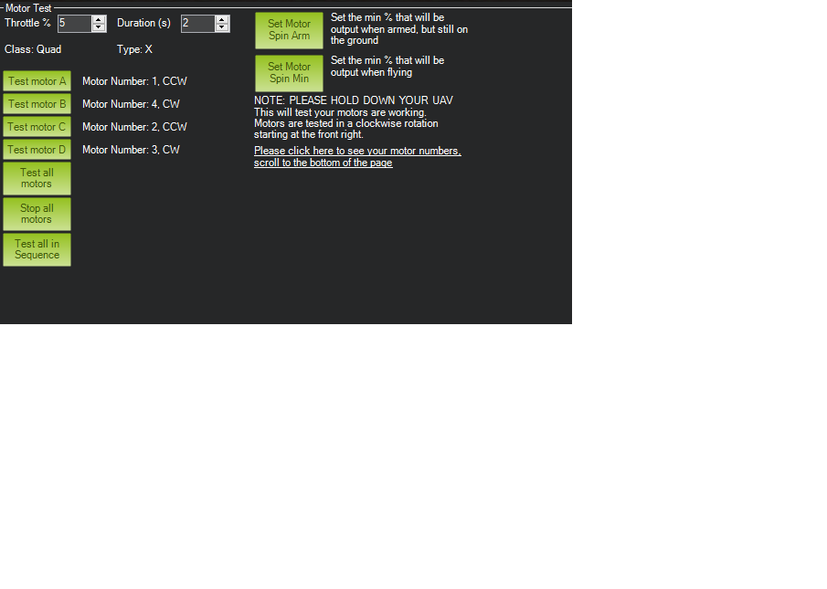

Servos setting to 4 3 2 1, resulting in reported sequense on motor test page 1 4 2 3, and spinning result 1 2 4 3…

Nothing you have reported so far is a bug or incorrect behavior.
This never changes unless you change frame type or class (and at this point you shouldn’t bother trying that):
Test A spins the output wired to Motor1
Test B spins the output wired to Motor4
Test C spins the output wired to Motor2
Test D spins the output wired to Motor3
So, for example, if you have things configured as in your image, and when you run Test B, the back left motor spins, then you know that SERVO1 is your back left motor, and as such, it should be configured as Motor2, and so on.

SERVO1,Motor1
SERVO2,Motor2
SERVO3,Motor3
SERVO4,Motor4

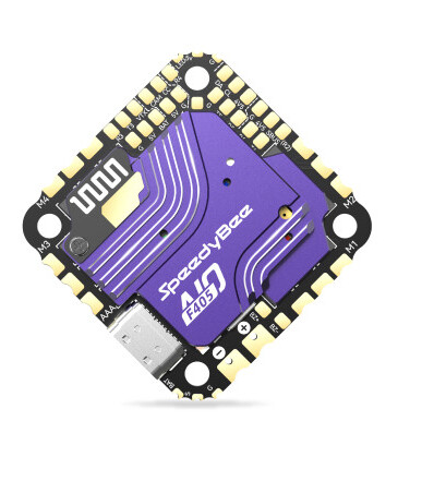

Is this the FC that you have?
If so you need to rotate the orientation. Thats how I fixed mine.
Changing the orientation of the autopilot is entirely unnecessary to fix the issue at hand and very likely counterproductive. We have already addressed the AHRS_ORIENTATION parameter.
That’s what I meant, when I read back over my comment it looks like I meant physical change.
The AHRS_ORIENTATION parameter is required to properly orient the IMUs and internal compass (if present). It has ZERO effect on motor order/numbering.
