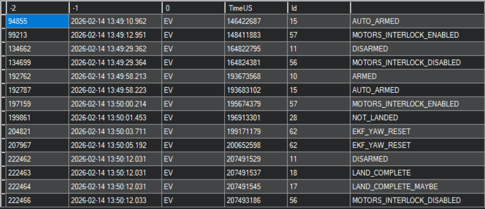

Running Arducopter 4.5.5 on quad. copter Auto armed automatically without user input either from RC or GCS.
Flight mode was seems guided and when pilot trying to arm from RC log file shows Prearm:Mode cannot be armable,but still armed and flipped in the ground itself.
i have checked paeameter ARMING_CHECK = 1 and GUIDED options everything is fine for me.
in the onboard log file data table page i have seen that its armed.
kindly help me to find in which way copter was armed either by RC or GCS or Forced ARM from GCS.
How to know that from the log if its command excuted from GCS?

Then your operator switched it to GUIDED mode, armed, and issued a takeoff command via the GCS.
Yep there’s an arm command at 08:19:10 and 08:19:57 which arms the aircraft.
Yes this is what one option probably but in the flight log there is no evidence that it’s triggered from GCS.
I seen all RC channels for arming by the pilot but it’s not armed by the RC sticks .. either pilot was tried before arming using RC sticks but it was in RTL mode and throws prearm :error that mode not armable.
After that mode changed to guided and armed.
Arm command by RC or GCS? Guided mode in QGCS definitely need swipe to arm it from GCS right?
What is difference between armed (id-10) and auto armed(id-15) in the data flash log under data table.
Since it’s a telemetry log, it’ll be through the GCS.
Which message is this?
Telemetry’s will log all the information even-though it’s armed by RC right ? How we conclude it’s from GCS.
The telemetry log includes all information about incoming/outgoing mavlink packets from the GCS. Thus if there’s a command long being sent the telemetry log will record that, and the only way that’s being sent (if it’s in the log) is if the GCS sends it. Telemetry Logs — Mission Planner documentation
