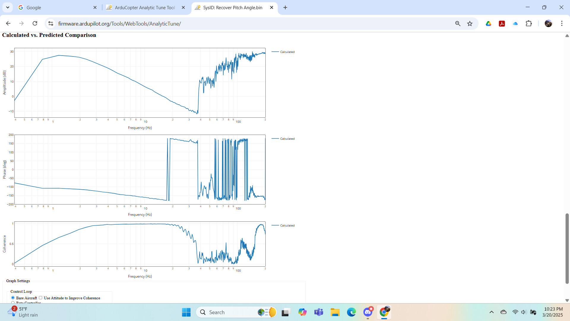

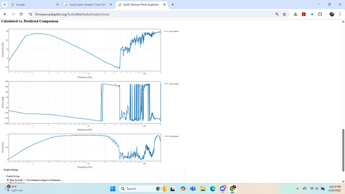

@Allister As Leonard mentioned earlier, the noise in the control signals is a very important consideration when tuning. In looking at your data, I was very impressed with the highest frequency you were able to achieve with excellent coherence. In the plot below, you can see that you are seeing excellent coherence out to 22 hz and good coherence out to 33 hz. Most of my data of a multirotor using throttle based notches hardly gets above 8 hz.
I looked at your INS notch filter settings and it appears you were filtering each motor based on the ESC RPM. So I believe this really helped with the clean data.
After looking at logs using this tool, I am beginning to equate the max frequency with good coherence with limitations due to noise. I have seen other logs where the data was noisy and the frequency sweep was unusable to tune because as you pushed up the rate D term, the drop off of the gain plot started to exceed the frequency where there was good coherence.
So in your case, I was satisfied in removing the D term filter and tuning with out it. I would recommend that if you do this, that you want to fly with the new tune and filter and look at the time history of the RATE.ROut, RATE.POut, and RATE.YOut signals with the fast attitude logging setting to ensure that the noise is less than 0.05 which is what I believe Leonard uses as his metric to judge low noise in the control signals
