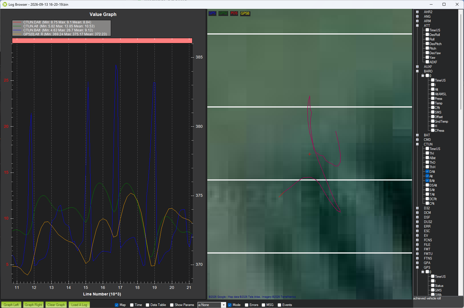

Hi @Sokerer,
Txs for the report and the logs. I’m afraid that I don’t have much experience with these types of frames, @andyp1per is the expert in this area.
I think the core issue is that the barometer is getting a lot of interference when the throttle is raised and it’s the opposite of what we normally see. So normally as the throttle is increased, we see the barometer altitude fall (e.g. higher pressure from prop wash leads to lower altitude reported). In these logs though we see the opposite - the throttle is raised and the baro altitude jumps 3+ meters.
In the graph below the barometer altitude is blue, the EKF’s altitude is green and the GPS is yellow. I suspect the EKF and GPS are actually correct which means massive barometer interference is happening.
I think the best solution is to try and resolve this perhaps by changing the vehicle’s frame design or possibly enabling the barometer is the GPS unit if it has one (the Here4 has one for example).
The vibration compensation feature is there to catch and try and handle bad altitude estimates that are normally caused by high vibration. It can be tricked though and in this case I think that’s what’s happening - the baro is bad but it upsets the EKF enough that the vibration compensation kicks in.
Another possibility is to not use the barometer for height - so you could change the EK3_SRC1_POSZ = 3 (GPS). It will still fall back to the barometer if the GPS fails for some reason.

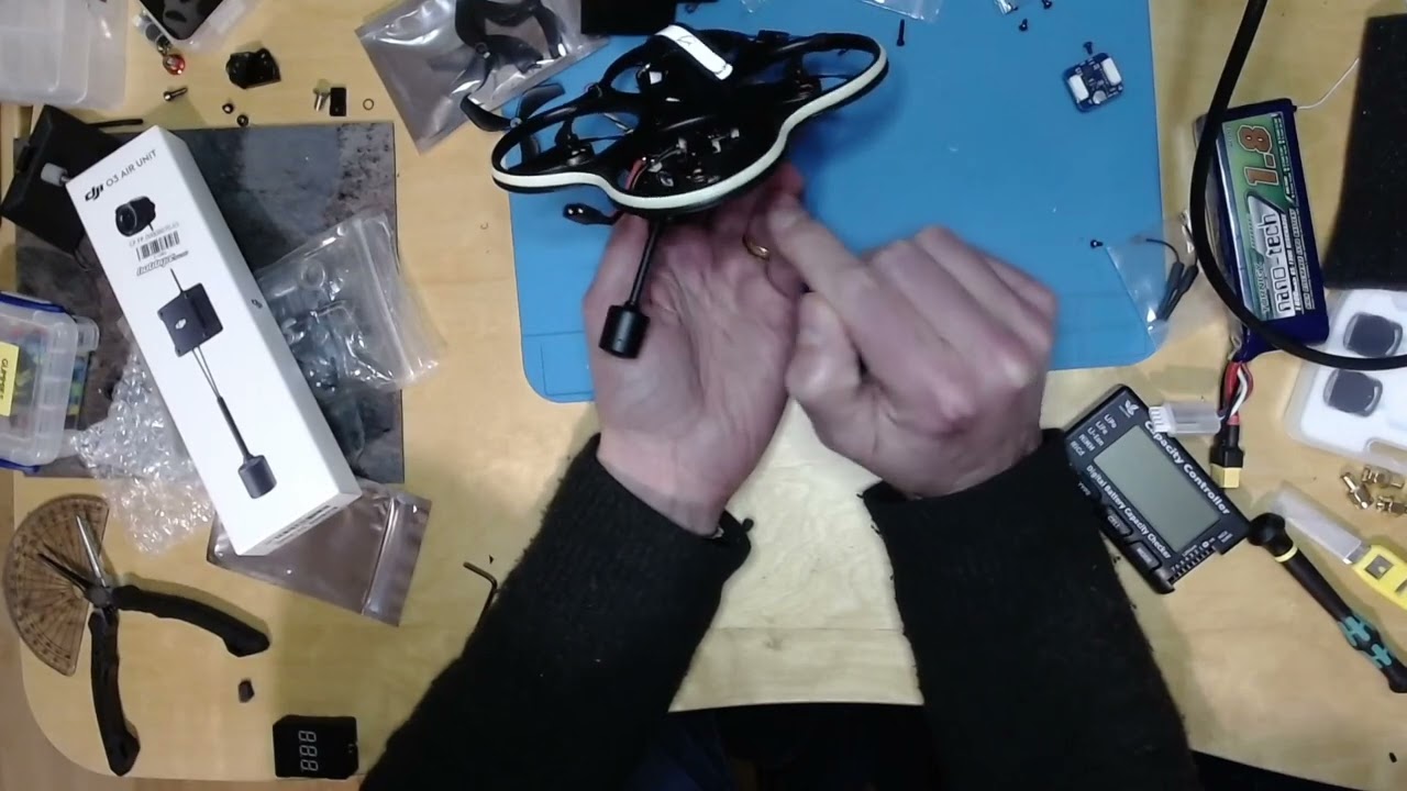

Is this a ducted frame design?
Yes! it’s a Speedybe 35 chassis, and I think I may have a plausible explanation for the unusual sign of the barometer error.
This cinewhoop frame has ventilation openings from the ducts into the FC compartment for cooling. My suspicion is that as motor thrust increases, airflow through the ducts creates a low-pressure region in the FC compartment.
Since the barometer is inside that compartment, it may see lower static pressure as throttle increases, which would explain why the reported barometric altitude increases instead of decreasing.
However, there is still one part of the behaviour that I do not understand: the repeated 0 → 1 → 0 → 1 throttle saturation.
I understand how the barometer interference can upset the EKF enough to trigger vibration compensation, but I still do not understand why, once vibration compensation becomes active, the vertical control response becomes so extreme.
In both independent logs the repeated 0/100% throttle oscillation begins only after Vibration compensation ON, and in the September 12 log it happens without impact or IMU clipping.
So my remaining question is whether the corrupted height estimate, once vibration compensation is active, can drive the fallback vertical-rate/control path into these very large CTUN.CRt values and consequently command full minimum/full maximum throttle.
That is the part I am still trying to understand.

Yes, I think you’re right that CTUN.Crt should match -XKF1.VD so I’ve created an issue and added it to our 4.7 issues list. Thanks!

We may have found the underlying cause of the throttle oscillation you mentioned higher up in this discussion. The fix is here and if confirmed we will get it out in a beta very soon.
Thanks Andy, and thanks to everyone who worked on tracking this down. Really appreciate the time and effort you all put into it.
