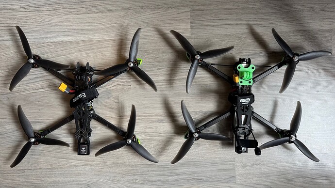

It’s really weird, it’s not my first Arducopter quad, I also have another 5 inch that is flying great in any mode.

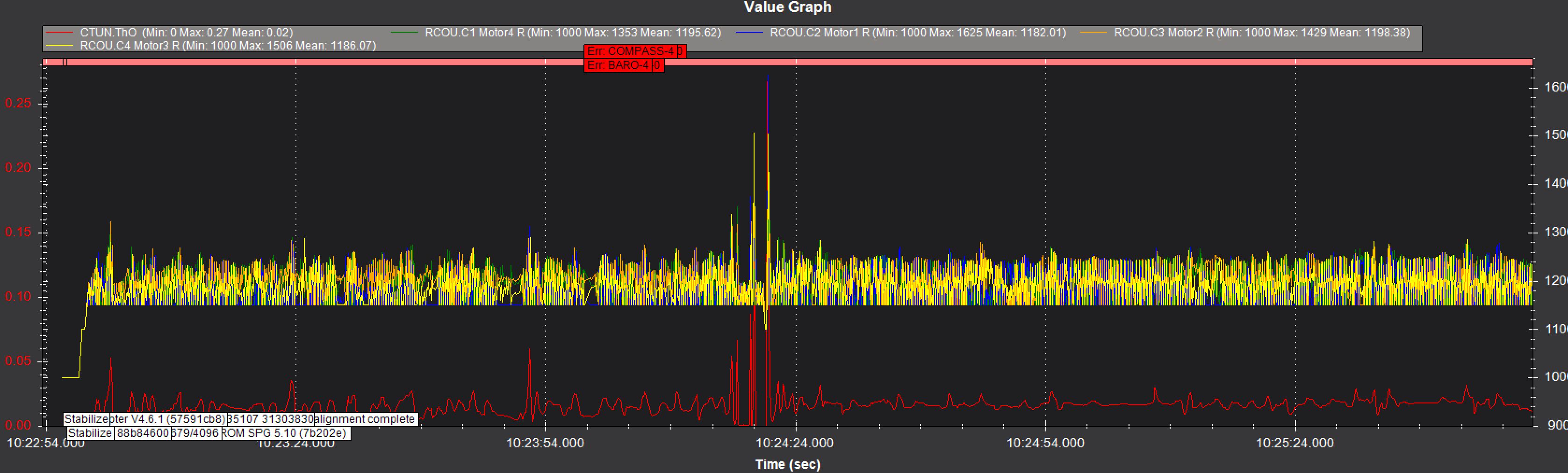

This is my second 7 inch quad, I have the exact same one setup with Inav and that one is flying awesome (right one is Inav, left one Arducopter).

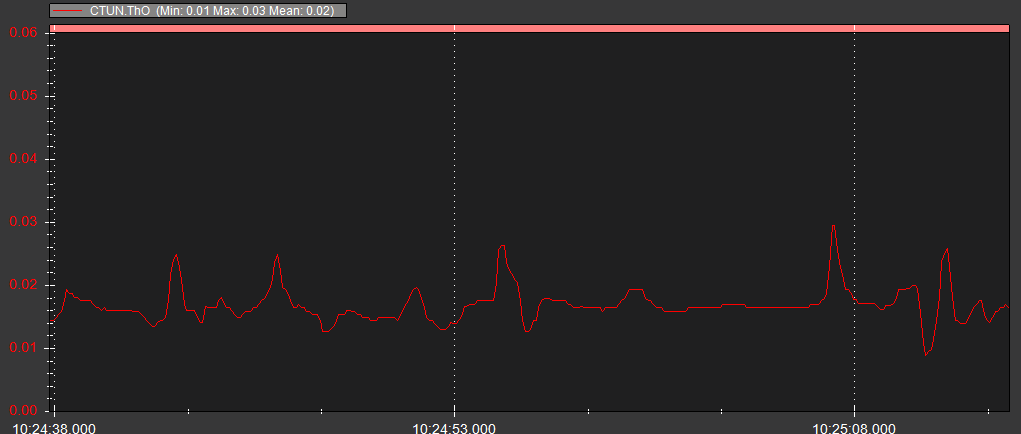

Hover throttle looks to me to be around 0.02?

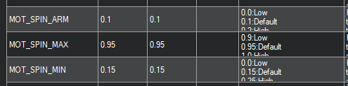

These are still at default and need to be set…
What do you think would happen with a situation like this?
@prsh8ya identified the problem. A hover throttle is ~ .02 and you have MOT_SPIN_MIN at default.
Standard procedure here Setting Motor Ranges
The vertical acceleration controller gains are at default. That’s one reason you have nothing but oscillation on the outputs along with default Rate PID’s.
Even with the Hover throttle set to .02 and the proper Motor Ranges set you may have some trouble with the thrust/weight you have. Suggest using a larger (heavier) battery.
You were both right, I set the Motor Range, totally forgot that one, and the MOT_THST_HOVER at 0,02 and it doesn’t take off anymore, but the oscillations are horrible.
Isn’t there a way to get this right with this battery and weight? I never heard that a quad could be too light…
Of course they are, it needs tuning. Drop the Rate PID’s in half and set the vertical acceleration controller gains based on hover thrust as per the docs. Standard pre-tuning steps.
