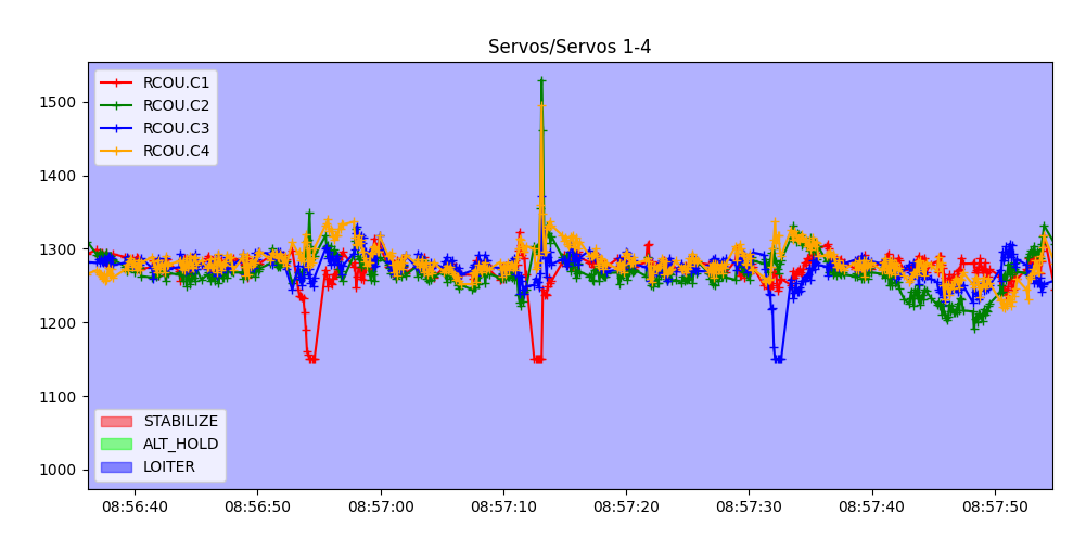

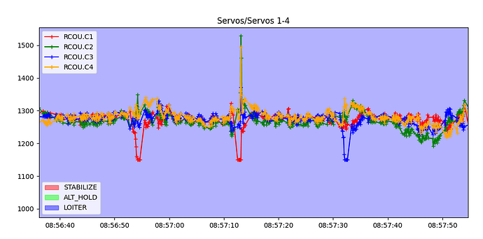

I have a AOS UL7 Evo with a yaw issue when doing a sharp turn the copter becomes unstable and will lose a bit of height. I don’t understand what is going on as it performs well in a straight line and quick changes of yaw in loiter are fine. The issue can be seen on the enclosed log file at timestamp 15:56:54 and 15:57:13

Some of the motors are hitting min. Any time a motor hits min or max you will lose some level of control authority.

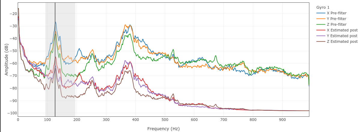

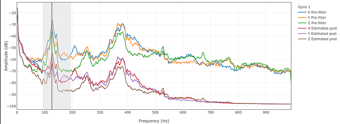

Let’s fix the filters first:
INS_HNTCH_REF,1  # This was set at 0 so it wasn't tracking.
INS_HNTCH_FM_RAT,0.7
INS_HNTCH_HMNCS,1 # Don't need the extra harmonics, it's an AOS frame...
That should give you:
