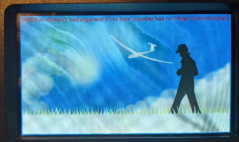

seems tiles related, is this a site you usually fly?
yes it is Alex
i think its got something to do with gps data in the x20 show the wright GPS Coordinates
in the script in map gps data -37.684040 1.577973 ? it should be 34.???
ok, but both discovered GPS sensors and widget show the same coordinates so the issue seems to be the GPS signal, perhaps check ardupilot logs and verify that the autopilot is indeed receiving the correct coordinates?
Autopilot has the right gps the script has the right Latitude=-37., Longitude is wrong it say 1.5777924 it should start with 144.

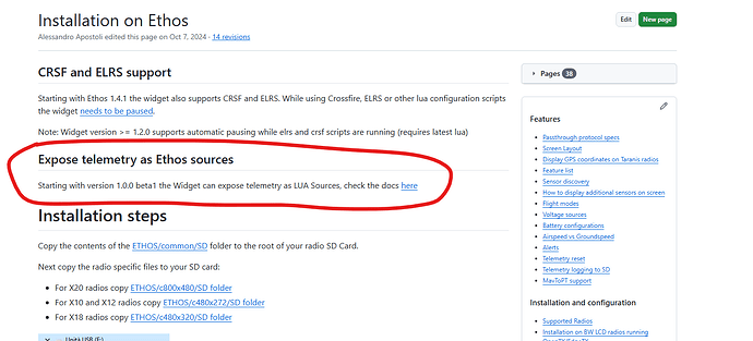

On my Ethos radio airspeed in not included on the sensor page but Yaapu obviously sees and reports it. Question. Can I access the airspeed data to create aural warning as you can with the other sensors on the telemetry page? Hopefully this wont involve me trying programming.
Thanks

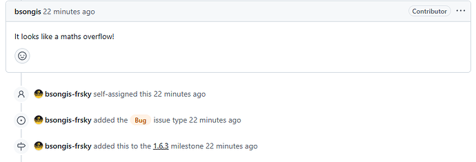

looks like ETHOS 1.6+ issue
rolled back to ETHOS 1.5.19 and it works
I expose most telemetry values as LUA sources, check here
