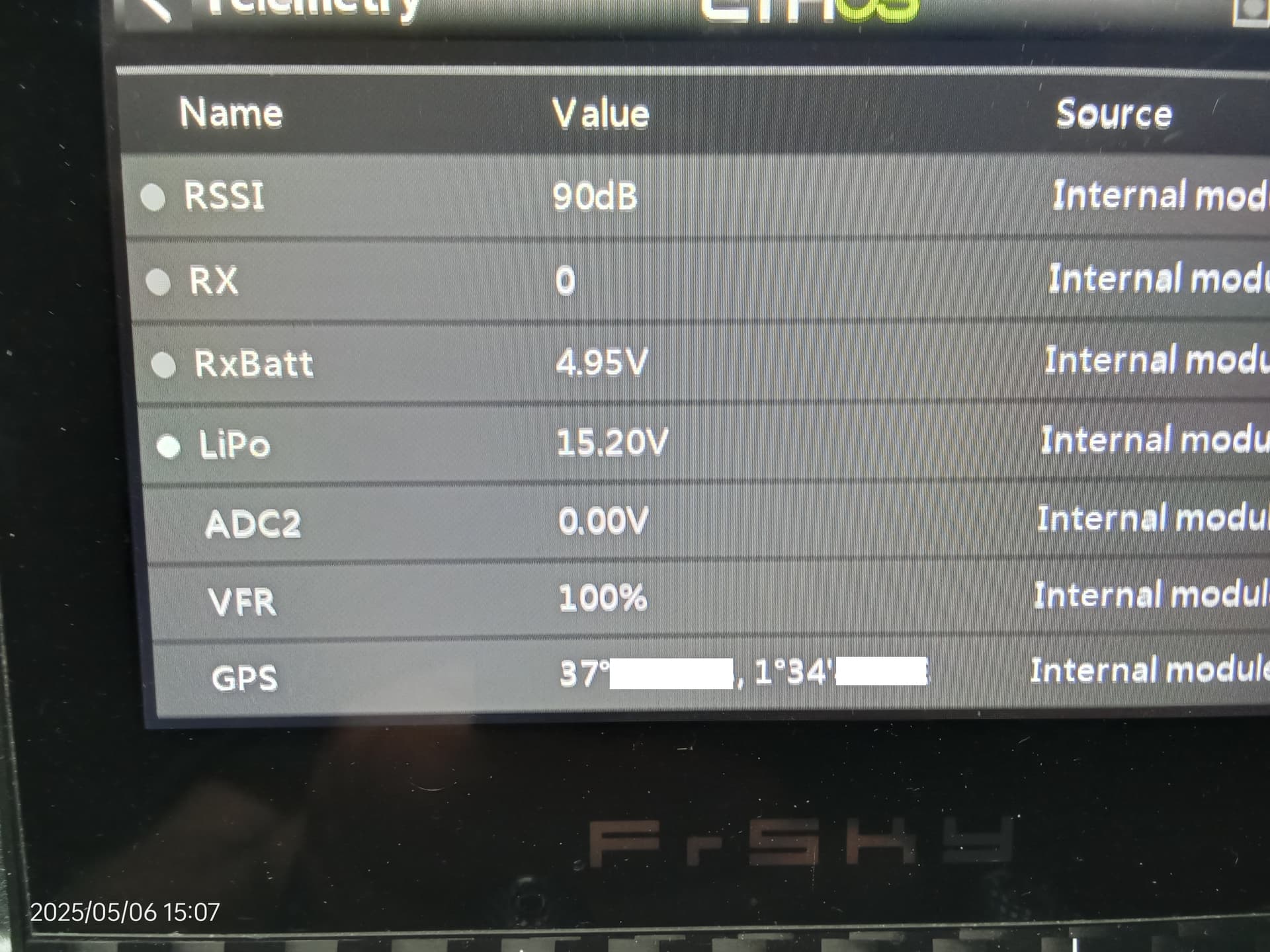

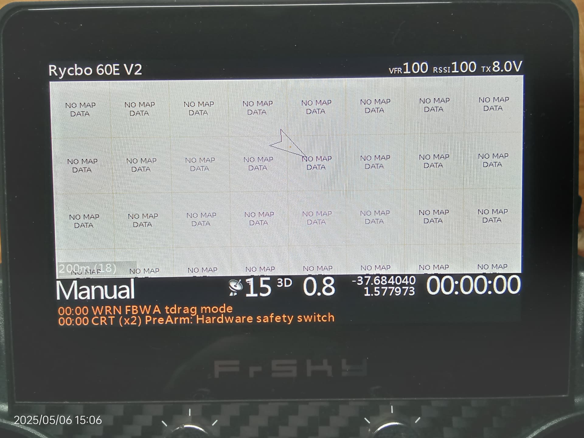

Having some issues on X20 Pro 1.6.2
cant get it to show
gps or map the the radio is getting GPS data
