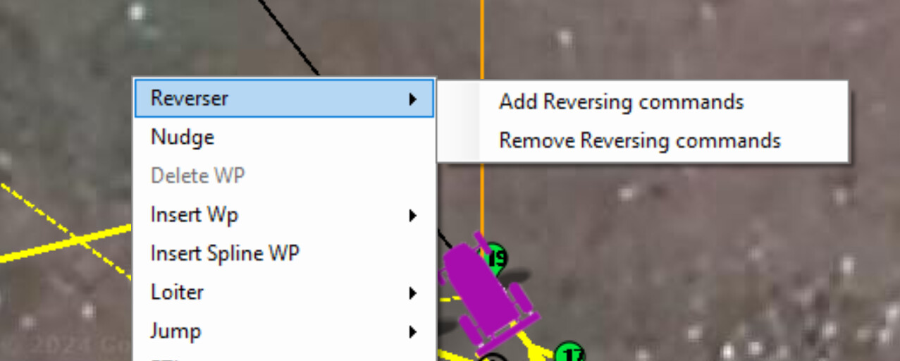

I thought about it and it dawned on me perhaps an elegant solution to avoid pivot turns is to detect acute turning angles in the waypoints and automatically insert alternate reversing commands. The attached plugin does just this.
It should work with any mowing pattern too. As a precaution it adds a DO_SET_REVERSE = 0 at the beginning and end of the mission to make sure the mower is traveling forward at the start and end.
I’ve only had a chance to run it through the simulator but so far it seems to work pretty well. Give it a try and let me know how it works for you. I think it can be a powerful tool for mowing ops.
To use: download into your plugins directory, rename to reverser.cs and start mission planner. You will have a new right click menu item in the planner. Right click and select Reverse and it will insert the reversing commands. You can do it repeatedly as it replaces any previous reversing commands with new ones.

I have since added one small improvement which is the ability to remove the reversing commands. Attached is the updated plugin code.
reverser.txt (5.8 KB)

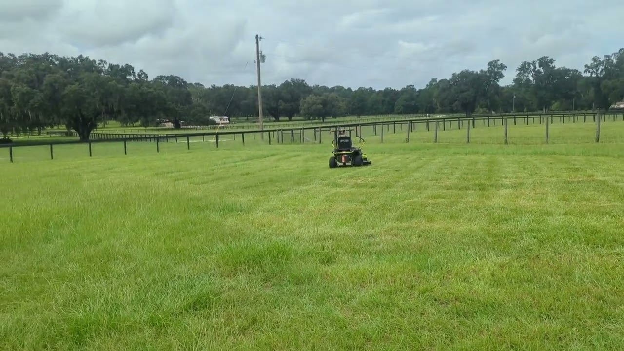

Finally had a chance to test it on the mower. Not bad for a first go.
It has some odd dynamics at the reversing transitions. My theory is the EKF might take a second to react to all the values going negative. Or something. Not sure it is designed to work this way.
If anyone has any thoughts feel free to opine.

Thanks for the reply. Agree this might prove to be most beneficial to tracked vehicles as they can seriously damage turf during pivot turns. Reversing ought to be faster but in my test the AP seems to have a problem figuring out how to get back on track, so to speak, as can be seen in the video. Hopefully the solution is within one of the seemingly endless tweakable parameters.
And yes the mower running in reverse does present new potential issues; particularly in regards to forward facing obstacle avoidance devices and cameras. I have a front facing camera on mine and when in reverse shows a great view of where it went. Not good. I’m thinking about making a servo mount for it and having it reverse the camera as well. It’d be another simple command insertion for the plugin fortunately.
