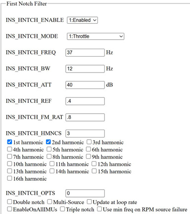

Folks here have helped me identify a vibration issue with my heli, so I’m hoping I can minimise its impact using notch filters. The problem frequencies identified are 63 and 442Hz so, following the instructions in the Ardupilot how-to, I’ve set notch parameters as shown in the attached screenshots. Am I headed in the right direction? Will this allow my FC to ‘ignore’ those frequencies?

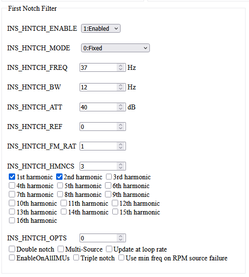

Hi Allan-You go the configuration right to collect the data! I could suggest a filter configuration but it should be reviewed by people more knowledgeable with Traditional Heli than I. But, this is what I see as working well. It’s possible the 2nd harmonic is not needed.
It’s my understanding that you can’t use a normal throttle based filter on trad-heli because of how collective pitch and the RSC are set up. If there’s no ESC or other RPM data it will need to be a fixed filter. But the good news is the ESC or governor should be holding the RPM pretty solid so the value won’t change much.
I’d try something like this:

@Allister suggested set up is correct in how to approach reducing noise produced by the rotor system. Since helicopters operate at a constant rotor speed, the noise is at a very narrow band. So if using a governor with out an RPM sensor, the fixed notch is the right way to go. If using a throttle curve, it must be set up to hold approximately the same rotor speed throughout the flight envelope. In this case a wider notch might be used to account for variability. If an RPM sensor is used then the RPM mode should be used for the notch filter and in this case a smaller bandwidth could be used. I have used one as small as 6hz with good results.

Yes, I’m using the ESC’s governor without an RPM sensor. I’ll compare my settings with the ones suggested by Allistair above.
