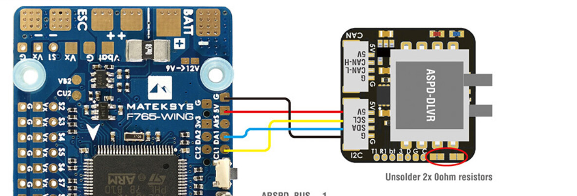

I’m working on a vtol flying wing configuration aircraft…where i facing an issue..i am using matek sys digital airspeed sensor - ASPD - DLVR L431 in which the parameters i have set is arspd_type = 9(DLVR-10), arspd_use = 1 and the flight controller im using is speedybee f405 wing as well….so the issue im facing was when i connecting airspeed to fc in which from i2c port of airspd to digital arspd sensor port of fc..the baro abnormally behave..its altitude shows in software from -1000m to +2000m..but when i disconnect the airspeed, it becomes normal.. Please let me know how to resolve this issue?

You did follow the wiring diagram and also removed the two resistors to switch the airpseed module to i2c mode ?

No I didn’t do this because it was not mentioned over ardupilot i guess
Sounds like you’ve found an important fact.
Let me know if that does not work to fix your issue, and I’ll take a look at the logs.
