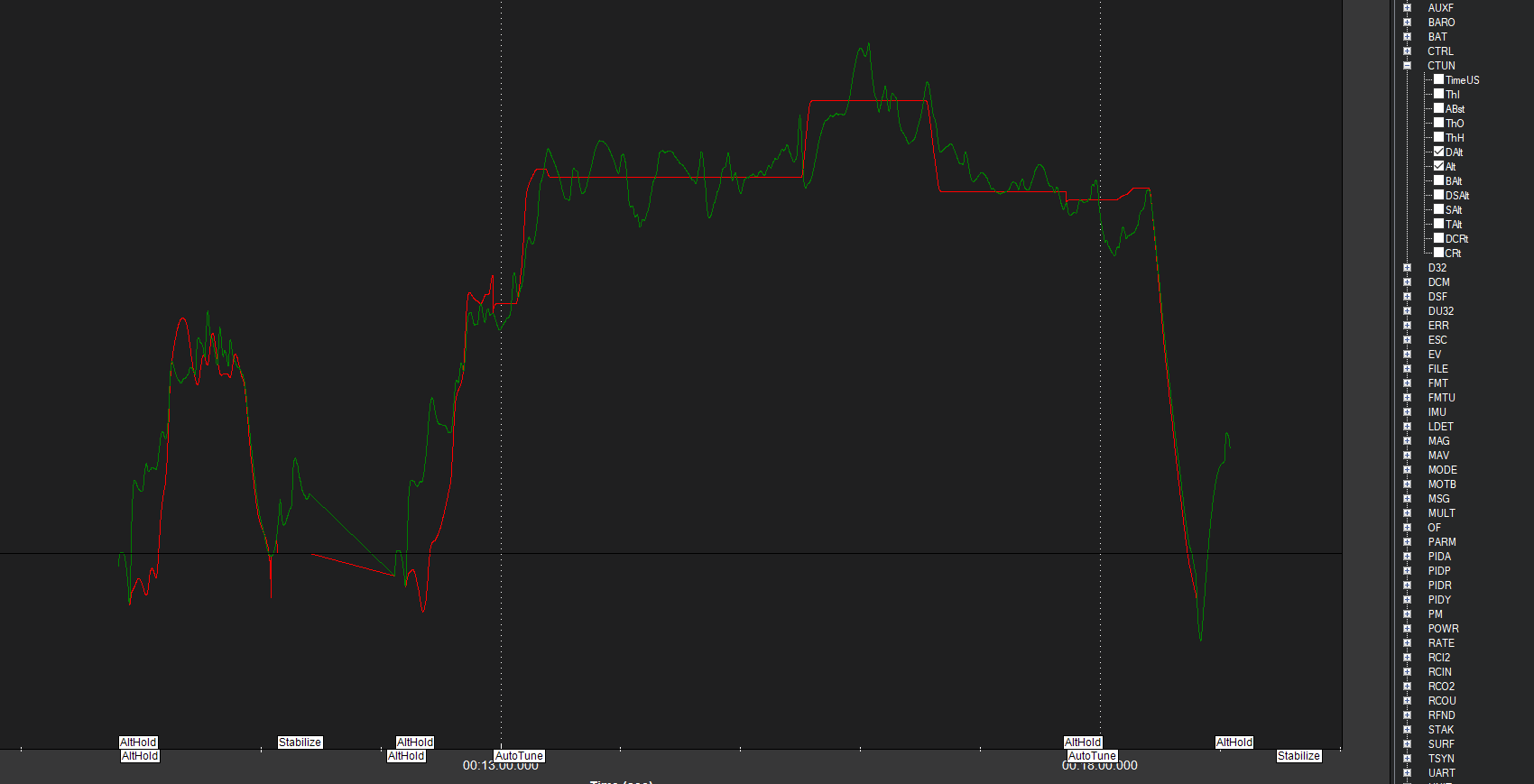

I have a powerful quad and I have a major problem in tuning the altitude controller. Due to the high thrust to weight ratio, the MOT_HOER_LEARN parameter is unable to calculate the MOT_THST_HOVER value correctly. I set the MOT_THST_HOVER value from CTUN>>ThO and used it to set the MOT_THST_HOVER values ​​and the PSC_ACCZ_P, PSC_ACCZ_I values, but with this setting the quad was unable to maintain altitude. Then I manually selected a higher value for these parameters (0.1 for MOT_THST_HOVER) but there were a lot of fluctuations in altitude. I also significantly reduced the PSC_VELZ_P and PSC_POSZ_P values, but the altitude controller is still not good. what should I do?
this is my log:
MOT_HOVER_LEARN is set to one, so during flight it would adjust it, but not save the new value definitively. Change it to 2
The problem is that due to the high thrust-to-weight ratio, setting MOT_HOVER_LEARN=2 sets the MOT_THST_HOVER value to its minimum value of 0.125, which does not seem to be the correct number according to the log. According to the posts I saw from other people, they also mentioned this issue.

As you have found out, MOT_HOVER_LEARN=2 and MOT_HOVER_LEARN=1 do not work when MOT_THST_HOVER < 0.125 and you are required to manually do:
  • MOT_HOVER_LEARN=0
  • Set the MOT_THST_HOVER value from CTUN>>ThO dataflash log.
This has been explained in Section 7.1 of the AMC tuning guide
[!IMPORTANT] If your vehicle is very overpowered and requires a MOT_THST_HOVER level close to or below 0.125 you will need to set the MOT_HOVER_LEARN parameter to 0 (using the Add button on the GUI) and follow the setting hover throttle instructions

In previous flights, looking at the flight logs and the CTUN.ThO value, the average hover thrust appeared to be 0.07, so I set MOT_THST_HOVER to this value. Based on that, I set PSC_ACCZ_P to 0.07 and PSC_ACCZ_I to 0.14, while leaving PSC_VELZ_P and PSC_POSZ_P at their default values. However, when I switched to ALT_HOLD mode, the drone suddenly dropped toward the ground. I immediately switched back to STABILIZE mode, but it was a bit late, and the drone hit the ground and bounced back into the air.
The parameter MOT_HOVER_LEARN was set to 1. Could the cause of this drop be that this parameter wasn’t set to 0, or is it possible that the ThO value was reported incorrectly in the log?
I think I should set a higher MOT_THST_HOVER value, something like 0.08.
This log is from the flight with MOT_THST_HOVER = 0.07 that resulted in the crash:
https://drive.google.com/drive/folders/1DPZ2V-OY6Rb-8kdLOcJvCYfEfyOLCgCF?usp=sharing
You had EKF lose relative siding and reset altitude. @Paul_Riseborough
Could you give me some guidance on this?
@dkemxr
As @LupusTheCanine suggested the log is full of EKF errors. When it dropped to the ground the Optical Flow quality went to hell. I don’t know if it’s related or not. Choose a better Flight Controller.
