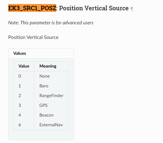

According to the parameter list, there’s no default value (for copter) for the EK3_SRC1_POSZ parameter.
Looking at old log files - EK3_SRC1_POSZ is always set to “1” - for “Baro”.

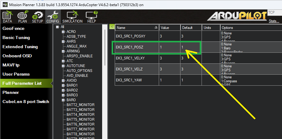

The default value for EK3_SRC1_POSZ is 1 (Baro) and the default value does appear in Mission Planner’s parameter. I’m not sure if the defaults ever appear in the full parameter list on the wiki (I don’t see defaults anywhere).
If EK3_SRC1_POSZ = 3 (GPS) and the GPS fails for whatever reason AP will fall back to using the barometer.
Looking at the code, my understanding is that there is no fusion occurring. Rather, it is one or the other. And from what I can tell, if EK3 is set to GPS and then there is no GPS data for 2 seconds or the GPS accuracy gradually degrades, then code switches to baro (hardcoded decision).
