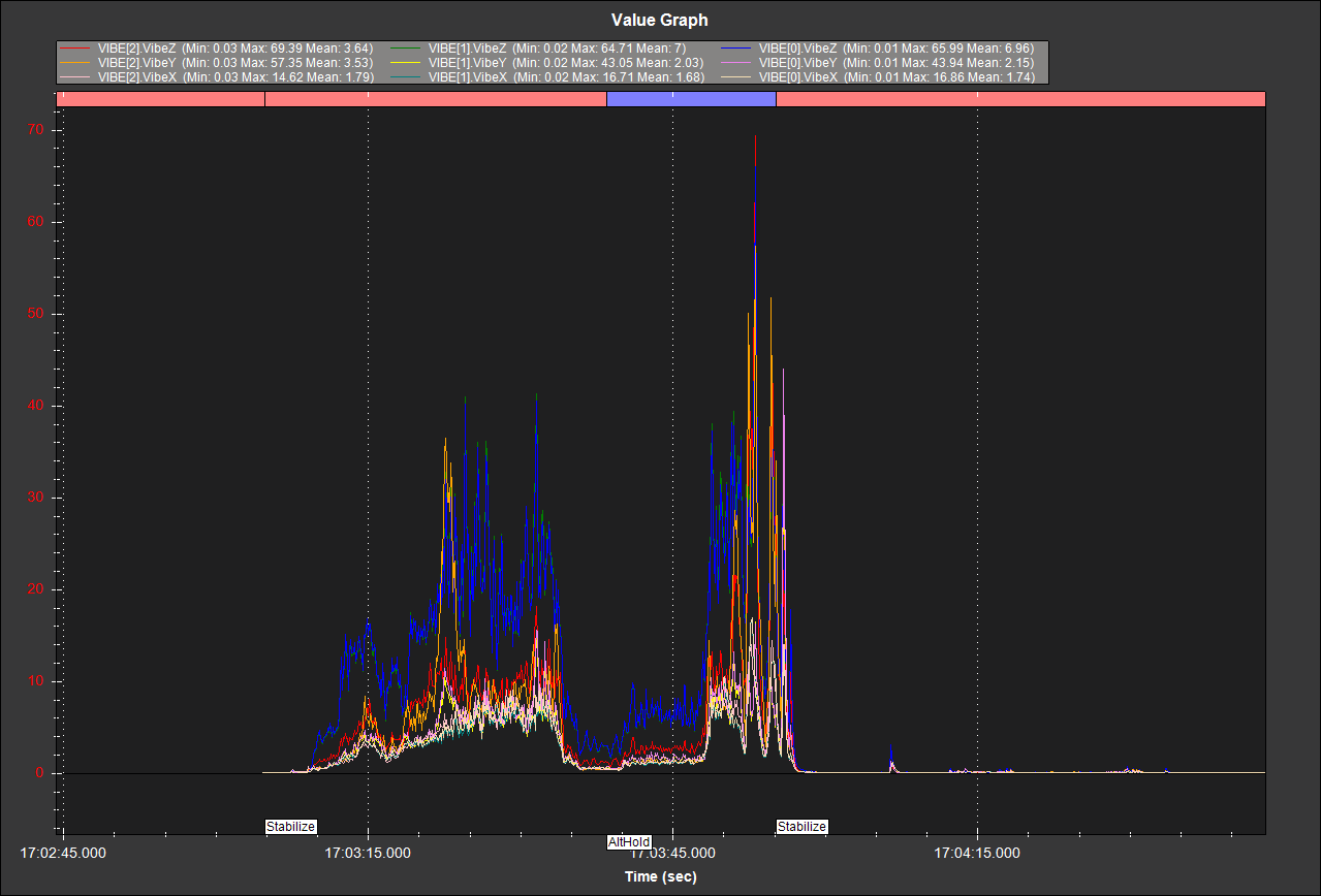

I am experiencing a constant altitude jump issue while hovering with my system in both Loiter and AltHold modes. The drone flies normally and maintains stable altitude in Stabilize mode, but when switched to AltHold or Loiter, it begins to rapidly change altitude, oscillating up and down by about half a meter.

Firmware: 4.5.7
I have checked for:
Proper barometer isolation and foam protection
GPS signal stability
Vibration levels (seem within normal range)
Despite that, the issue persists.
Has anyone experienced similar altitude jumps? Could this be related to barometer interference, PID tuning, or air pressure fluctuations?

You are missing step 20 of the ArduPilot methodic configurator software. You did not configured the altitude acceleration PIDs yet, so that strange behavior is actually normal.

Sorry but most of that is just wrong.
You have two options
Read the extensive ArduPilot documentation or
Use ArduPilot methodic configurator software
Using an ArduPilot untrained AI for ArduPilot configuration is very error prone and dangerous.
Vibrations are quite high, flight duration is too short to confirm better.
I think you need to do more first-flight practice with a smaller drone.
