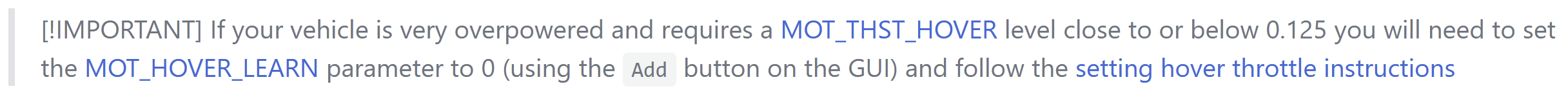

Hi all - If I’m flying a small overpowered copter and getting vertical oscillations in AltHold, is it more likely that MOT_HOVER_LEARN is not learning the extremely small hover value and so I should set it manually per this - https://ardupilot.org/copter/docs/ac_throttlemid.html or should I reduce the PSC_POSZ and PSC_VELZ values per this - https://ardupilot.org/copter/docs/initial-tuning-flight.html#test-althold?

    First flight with more attempts at AltHold in the log. It just doesn’t seem like MOT_HOVER_LEARN can learn a value less than 0.2? Though I’ve had it learn values under that on other larger copters that were also a bit overpowered.

The learn limit is 0.125.
Thanks @amilcarlucas ! I’m working through this copter and hopefully another soon using your AMC. I saw this note and wondered if there was some kind of minimum it could learn.

Don’t forget to turn down PSC_ACCZ_P and PSC_ACCZ_I.

@Allister did you happen to mean these params from here? I hadn’t seen anything about PSC_ACCZ_I that I was supposed to adjust.
I thought I had adjusted these both, but I guess one of them didn’t save. Hopefully I’ll get another test flight in this afternoon.
if AltHold starts to oscillate up and down the position and velocity controllers may need to be reduced by 50%. These values are: PSC_POSZ_P and PSC_VELZ_P.
Read thru here and you will get to it. Initial Tuning Flight
Oh whoops, I was looking for PSC_POSZ_I instead of ACCZ_I. Can’t believe I missed that. Thanks @dkemxr
Included in Step 20 of AMC

Ahh, thanks @amilcarlucas - I opened up my AMC files and it looks like I was just on step 19 and got distracted with fixing this, not even thinking that I should try the next AMC step. I was so close!
