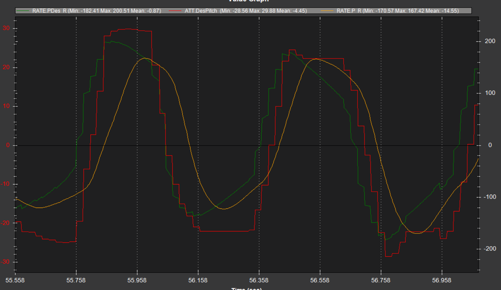

Log screenshot with fast attitude logging:

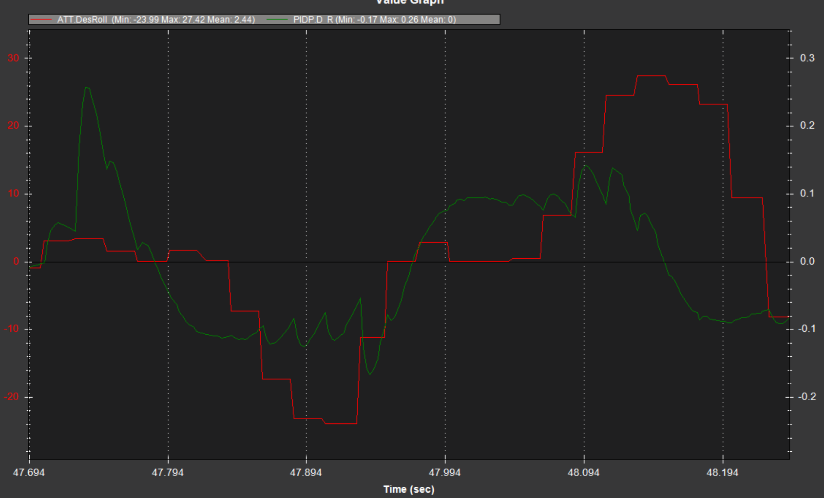

You can see that the desired pitch angle moves in a stepwise fashion, the steps are about 22ms long (~45 Hz). The rate D term consumes these steps and causes the rate controller to struggle:
I suspect this is caused by the RC input not being smoothed, but I don’t remember ever seeing this before, so I must have misconfigured something, but I can’t figure out what.

You need to set ATC_RAT_FF_ENAB,1
Ah, okay, then I misunderstood how that parameter works. All of the ATC_RAT_*_FF gains are set to 0 so I thought it was essentially disabled anyway, and I thought the input to angle target smoothing was handled by the input TC.
As for why I turned that off, I wanted to look at the simulated step responses in the PID review tool, and the methodic configurator said to disable FF to do this. In fact, various tuning guides suggest to set ATC_RATE_FF_ENAB= 0 to evaluate the quality of a tune. This now seems like strange guidance to me, given that it affects the input rather than the rate control loop like I thought.

You just need to turn input shaping back on.
ATC_RATE_FF_ENAB 1
This is what does the smoothing. We turn this off to directly test the angle P loop because when we are using the command model (the thing that does the smoothing), we are effectively flying in acro so only small errors are corrected using the Angle P, even in large attitude changes.
