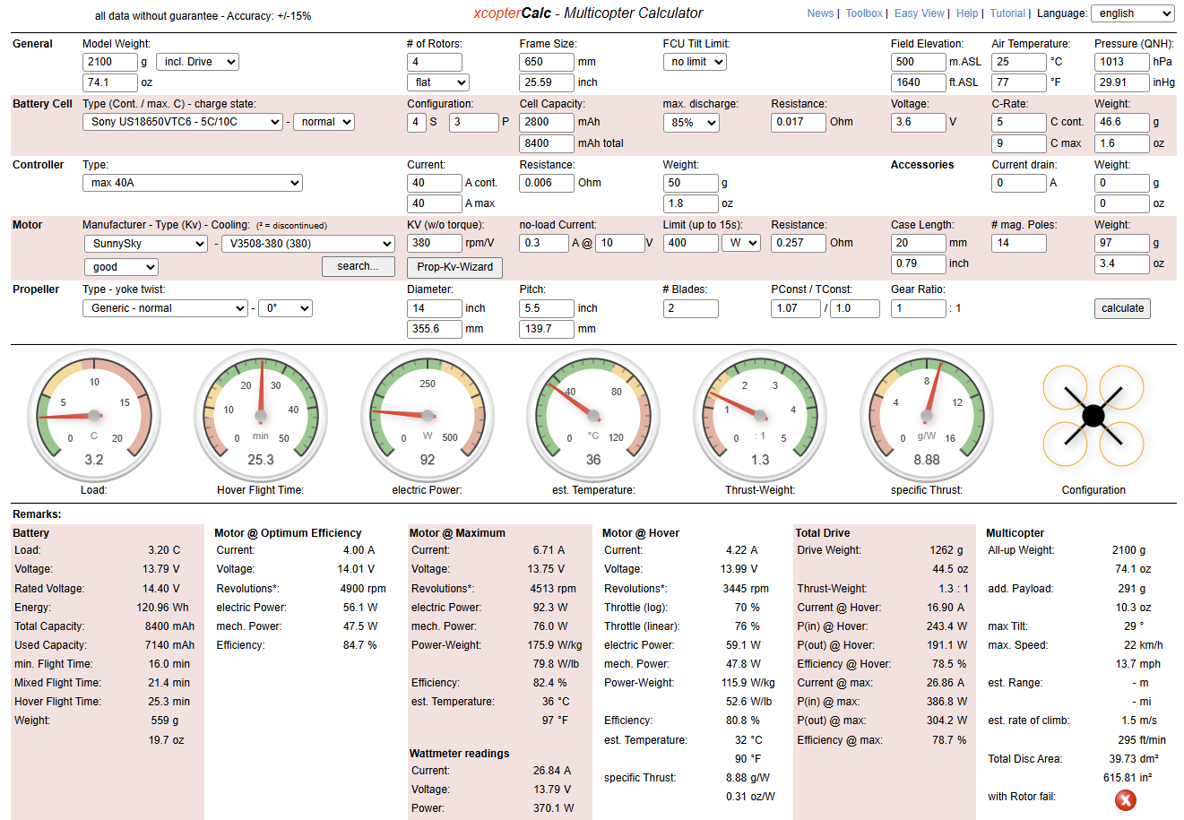

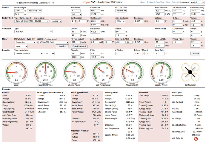

This craft is underpowered/overloaded. And clearly the tune you have is bad.
I would suggest resetting to default and use the ArduPilot Methodic Configurator to configure and tune it after correcting this.

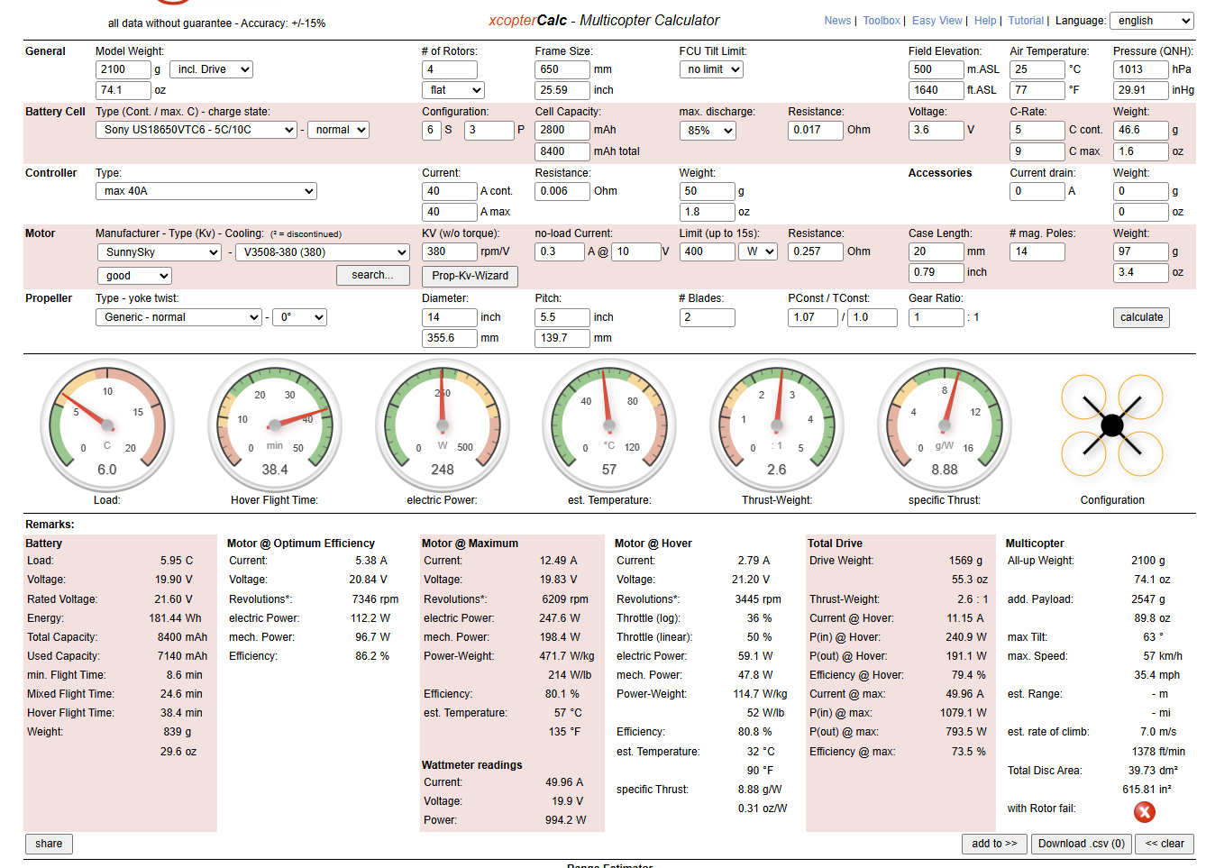

If I change my batteries to 6s3p, will my problem be solved?
If the information in eCalc is correct and it will really have a Motor @ Hover Throttle linear of 50% then yes it should correct the thrust/weight problem.
@dkemxr Hello, I changed the batteries to 6s and reset the default parameters. It flies well in alt hold and loiter mode. But I need help setting the harmonic notch filter. There is a bump at 47 hz and I couldn’t get rid of it. Can you examine the log file with the filter tool? I want to use INS_HNTCH_MODE = 3.
It’s not in a state of tune to configure the notch filter, there is oscillation on the outputs. On the + side it now has sufficient thrust/weight. You can piece away at the tuning with the standard process of lowering the Rate PID’s and correctly setting the vertical accleration controller gains if you know what you are doing. Or, use the Methodic Configurator
