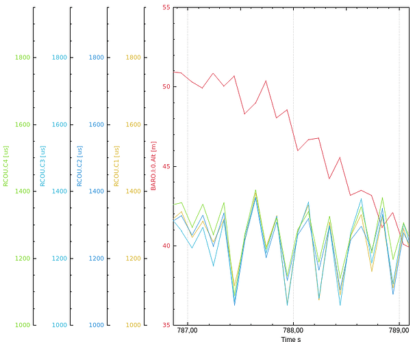

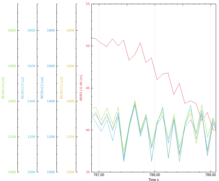

I’m talking about local changes as opposed to general trends. For instance here:
It’s clear that the general trend is falling down, but the copter in the reality is definitely not jumping +1m and -2m in consecutive 1/10ths of a second. For this part, it kind of seems that PWM peaks map to local minima in altitude, but based on what happens at 787.4-787.6, it’s rather phase lag, because a longer minimum in PWM causes a longer minimum in altitude with a delay.

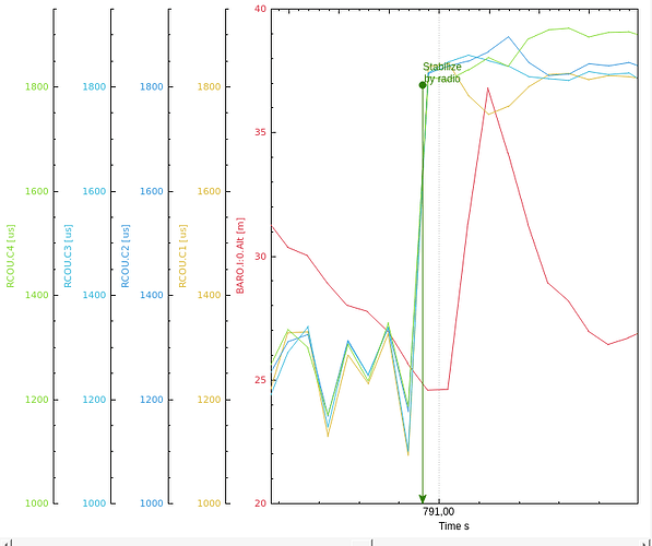

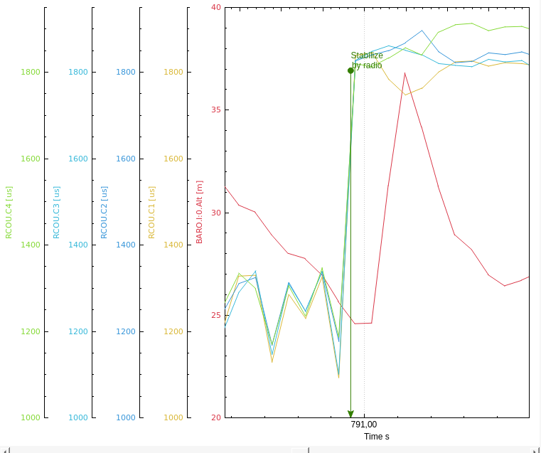

What’s more, switch to stabilize causes the altitude measurement to go 12 meters up in 0.2 seconds, which would be somewhat unrealistic, also given that the subsequent measurements go down even if you hold the throttle at the same level:
So this is definitely something like sudden flow changes that confuse the barometer. If you check the logs, you will see false peaks like this at all occasions you switch to Stabilize with high throttle - again, I interpret these as “false” because the measurement goes down a bit later with the same throttle still applied.

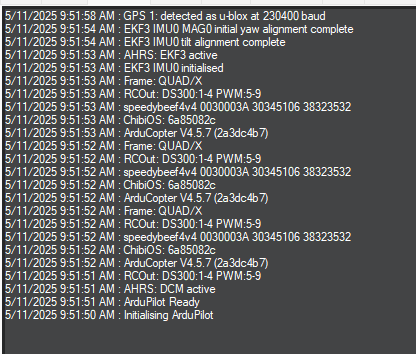

What esc are you running?
I am running dshot on ardupilot with speedy bee
I have SpeedyBee F405 V3 STACK. You have V4. AP supports bdshot for this fc.
