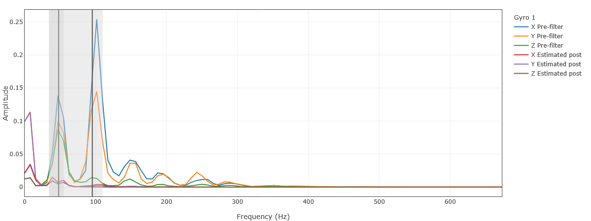

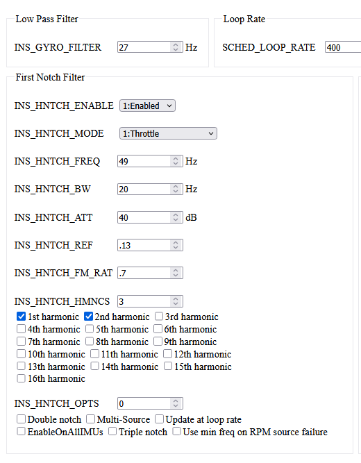

Try setting a harmonic notch filter before you get too much further with the tuning.
These settings might not be perfect but they should be a good start.
Thanks a lot for the help. I see that you are viewing the frequency vs amplitude in linear scale. However, when I plot the amplitude in log scale, the result of filters is not significant / or not more pronounced as compared to linear scale. What do you suggest?
We suggest you use the settings suggested by @Allister and post a bin file with the results of a short flight in ALT_HOLD mode.
Ideally if you’re looking at the graph in log scale you are trying to get the estimated values below -50db. With this log I was not able to get there without over filtering. I don’t think that is needed. Try the values I gave you and then post the log of the flight. Hover it for a minute in Alt hold is all that’s needed.

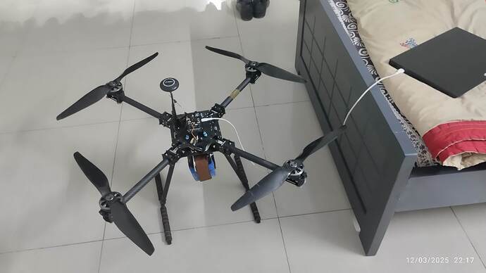

What size is this craft? The Rate tuning is not great so perhaps the Rate Pitch/Roll P&I are too low. But, there isn’t much to see in this log in that regard. Make another flight with some more aggressive attitude changes.
It is a quad having 400 KV motor and 17 inch props. I took off and did altitude hold (while the thrust learning is set to learn and save) and then landed. I will do a flight with some aggressive maneuvers and get back to you. Thank you again.
Set INS_LOG_BAT_OPT,4 You don’t need logging to 4kHz to set the notch filter.

Those filter settings I gave him didn’t seem to do anything. They targeted the spots I expected but pre and post look the same. Can you see if I missed something?

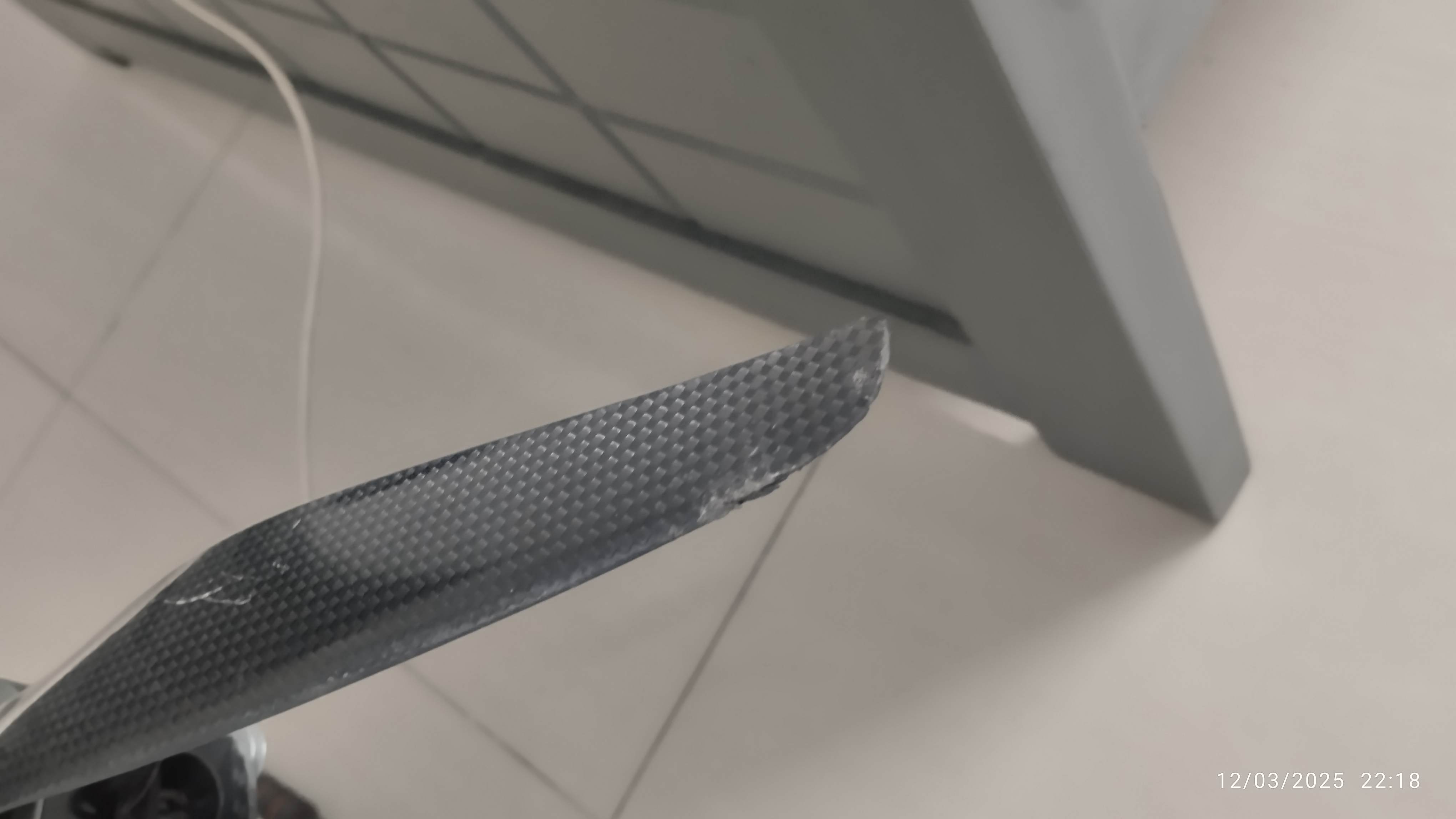

This is the quad. But it had a little crash before and one of the props is like this, little worn out on one edge. I hope that is not making an issue?
This vehicle is very similar to the “Holybro_X500 v1” template that I tuned to exhaustion.
Use AMC select that template as a starting point (not the v2 template, that one was not tuned by me) and do any changes required to fix your vehicle.
But that would be a great starting point for you.

Filter plot shows the notch filter is working. The PID plot shows the magnitude of oscillations has decreased as well. However, the small oscillations are still there in in the Actual PIDR.
