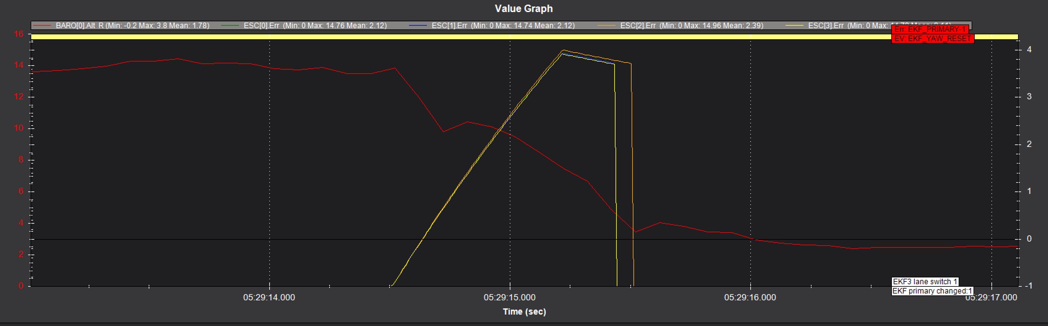

Both failure logs are attached
Without Payload Flight Log
With Payload Flight Log

These ESC’s all errored out then it crashed. But, all reaching critical temp at exactly the same time seems suspicious.
After replacing them I would take the suggestion of using Dshot600.

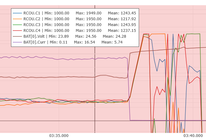

@Ghanshyam_Naik Heyy! I have the same stack and the same issue. My quad falls everytime after few min and looks like the esc shuts off. The cutoffs are disabled too. Could you come to any conclusion or solution?
Share a .bin log from a flight where this happened.
Hi, thanks for the quick reply. Have been beating my head on this for a week.
The quad is a 10inch(without payload) with Microair H743 and AM32 ESC. It flew fine on the first day. Then recently when I get it hover , it flies for 2-5min fine then just falls from the air. Looks like the esc shutdown than fc commanding it.
The temp and cut-offs in am32 config is disabled.
Log file link: https://drive.google.com/file/d/1lE5avI-acvVij-t6ycaYKOEtBzkSk-Sy/view
Unfortunately all I can do is confirm this is not an FC issue.
The current drops to nothing but the FC is still commanding motor outputs. There’s no ESC telemetry so I can’t see much else. You should be able to set up BDshot on this. That will give you data for better filtering and might help solve this.

As @Allister has stated, I believe the esc shuts down first. These mgs. shown occur after the drone falls, when the fc thinks its uncontrolled.
FCU command Motor 2 RPM to goes low at 23:04:04.443, Motor 1 to goes up. Is it Motor 1 is not healthy or lose connection between ESC and motor 1?
The drop in the current happens before any of the motor outputs go out of line. This suggests to me that the entire ESC is off line (not drawing any current) and the spikes in the motor output are simply the FC trying to respond. The FC has no way to know the ESC/motors aren’t responding.
I am interested to know how the user wired up the PMU, ESC, and FCU. How did the FCU still manage to get the power and monitoring the battery health?
[edit] okay, I got it. The entire drone draws very low ampere.
