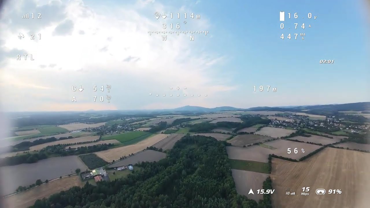

I discovered problem how Arduplane TECS controls airspeed of my plane in AUTO/RTL modes. It makes absolutely no effort to prevent stall. I performed test which is visible in the video where I disabled motors during RTL mode and the aircraft tried to maintain altitude disregarding the airspeed. The airspeed dropped below AIRSPEED_MIN=14 m/s and AIRSPEED_STALL=12.5 m/s and resulted in stall. Although my aircraft does not have physical airspeed sensor, the displayed estimated airspeed is not very wrong. What can I do to make aircraft to pitch down in this situation?

That’s the expected behavior.
Install airspeed sensor or enable using synthetic airspeed (highly experimental).
Check the TECS_SPDWEIGHT. Default is 1, but for this you might consider pushing it up towards 2. Go up in steps about .1 or .2 at a time and make sure it doesn’t cause any other issues.
That won’t work without airspeed sensor (or enabling experimental “use synthetic airspeed”).
Stall prevention, for example, increases speed or the turn radius if you try to fly too tight a turn at too low a speed. See the detailed description in the WIKI:
TECS isn’t intended for engine failure. You can use a “dirty” workaround to force TECS to make the plane descend with negative pitch during an engine failure by changing TECS_PITCH_MAX and TECS_PITCH_MIN via a LUA script—for example, to match best pitch for optimal glide performance.

So I tried to enable synthetic airspeed and it solved the problem. Not only it does not stall in RTL/AUTO mode but it also resolved other problem I had that aircraft most of the time flied much faster than necessary in AUTO mode.
The plane was flying as fast as it was configured to.
