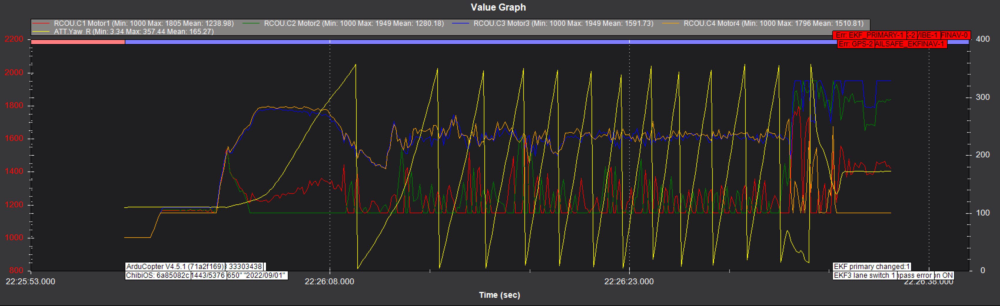

After takeoff, it flew uncontrollably high and crashed
The copter took off without losing control and flew directly to a height of over 30 meters before crashing. Please help investigate the cause of the crash. It caught fire after the crash, inexplicably. Thank you~~

This drone was previously able to fly safely, but after maintenance, only one motor was replaced without any changes. After replacing the motor, it flew again and became what it is now.

You could have mentioned that is was spinning around as it was flying. Due to a huge Yaw imbalance as seen here on the motor outputs. Perhaps you should have changed 2 motors.

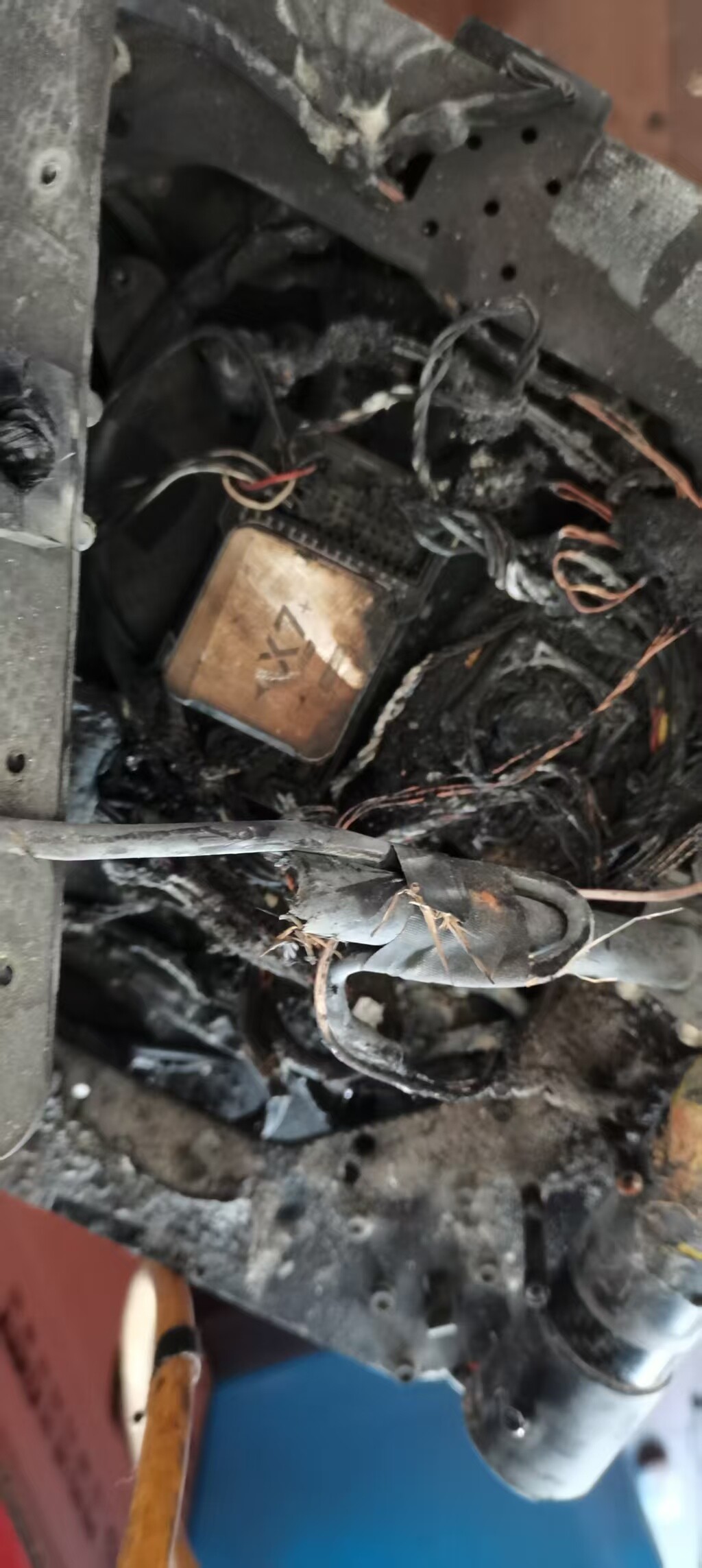

Did that CUAX-X7 burn up in the crash too?
Yes, I also noticed the data issue with YAW, but I don’t know what caused it. Perhaps the motor damage is the most critical reason, please help me confirm, because I am sure that this drone was flying normally before, and then one of the arms was damaged, so we replaced the parts without making any changes to the flight control. So even if there is interference with the compass, it will not cause the current problem.

Yes, the entire plane is smoking and on fire, there are no complete parts left, and the X7PRO must also be damaged. It is a tragic event, and I need to find the root cause to prevent it from happening in the future.

I have over 10 drones here that use this type of flight control, and our engineers have reference to the correct configuration plan you wrote. If there are problems with the installation configuration from the beginning, the failure rate will be higher. So far, there has been a minor issue with setting the minimum rotation speed. We have been using ArduPilot for over 3 years without any serious accidents. This is the most serious one, and of course it was not caused by the flight control settings that led to the fire. The fire was due to another hardware issue that we have identified.

For example, as mentioned by a friend above, if there is a mechanical problem with the motor. We found during our inspection that the drone caught fire was caused by the flight control power module rather than the battery. It is also possible that the power module did not work properly from the beginning, leading to control issues. These are all possible occurrences.

The fifth aircraft caught fire due to the power module catching fire, which involves whether the power module would cause the controller to crash if it did not work properly at the beginning. We are ready to replace all power modules with industrial grade modules to avoid any incidents.

I think you have to check C2/C1 motor and ESC.

Thank you for your reply. We are unable to check now as the plane has crashed and caught fire, and we can determine if it is a motor issue. From my understanding, as long as I do not use RPM feedback, the flight control system cannot detect the motor speed. Therefore, it is not necessarily true whether the RC output of the flight control system is the actual motor condition. For example, if the motor is really stuck, the C1 and C2 outputs in the flight control log may not be the actual motor condition, right. But it can be confirmed that there is already a problem with the flight control when outputting to motors C1 and C2.
