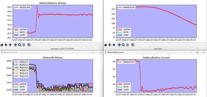

After EKF failsafe triggered, the drone was in Land mode and drifting a lot. Tried to control but at 80 m altitude it just dropped and crashed onto the ground. I checked the log, where the FC was getting continuous power. Suddenly, the battery current went to zero and motors fell from 1600 to 1200 PWM.

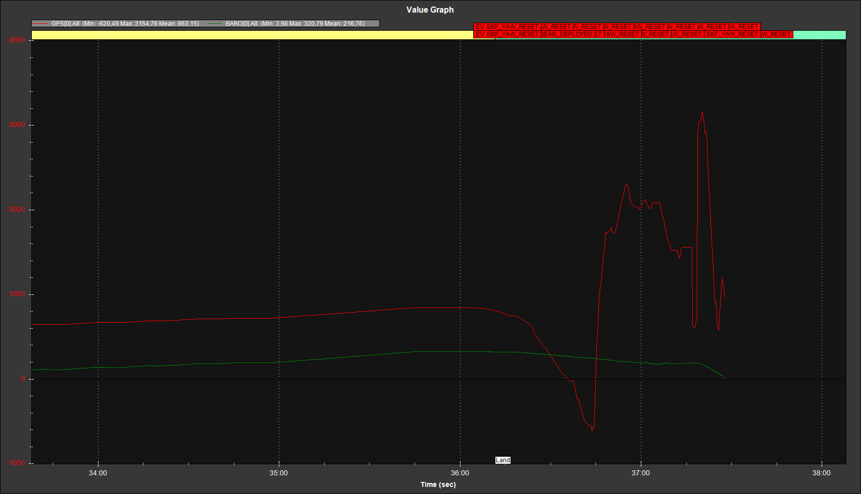

Hi, based on your parameters it looks like your altitude source is your GPS. Unfortunately the GPS altitude was quite unreliable here (see GPS altitude vs BARO altitude).

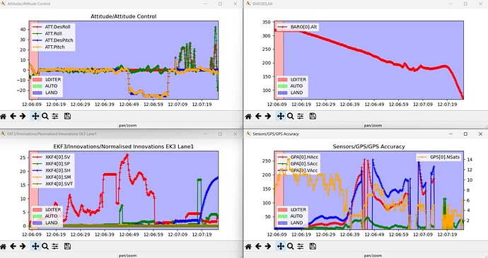

You have a very big “XKF4.SH” meaning EKF detect errors in altitude calculations.

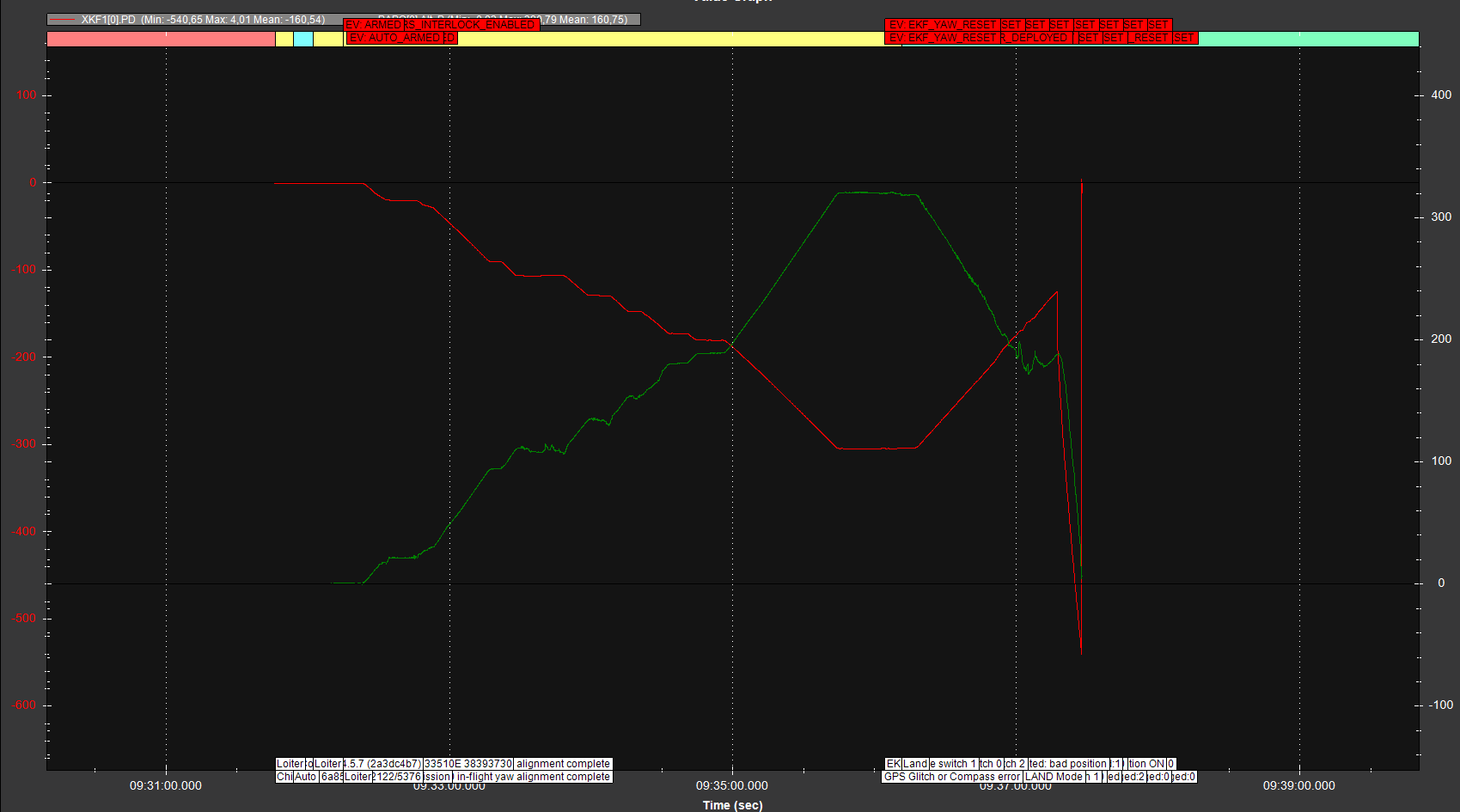

Because of this poor gps altitude, you have some glitches in XKF1.PD (position down, ~altitude) During the glitch PD went very low (meaning the drone is very high, a bad reading) so ekf told the drone to descent fast → Crash
Most people use barometer for altitude source. You have a GPS issue, we can also see that by displaying Lat/Lng (some others glitches) and the very low satcount is responsible for this (NSat graph). Do your GPS have a clear view of the sky ? Have you concidered redoundancy on GPS ? Are you flying in GNSS denied environement ?
Hey, Thanks for the reply. I checked that parameter again, I had actually changed it because I was experiencing sudden altitude drops when flying at low altitude at high speeds. I’ll switch it back to barometer. I also think the issue was caused by a GPS glitch that threw off the altitude reading, making the drone think it had landed. The flight was under clear skies, and the custom GPS module was an M9N u-blox chip.
Yes, definetly at t=36, something clearly goes wrong: SatCount drops from a stable ~28 to <5 instantly, that looks like a GPS loss/glitch, spoofing, gps alimentation issue, … not normal noise.
Since GPS is critical, it’s worth adding GPS redundancy and enabling “Use Best” so it can auto-switch if one GPS fails. And yes barometer for altitude source is generally safer, unless you have a RTK ground unit or so like that to make your gps super precise in z
