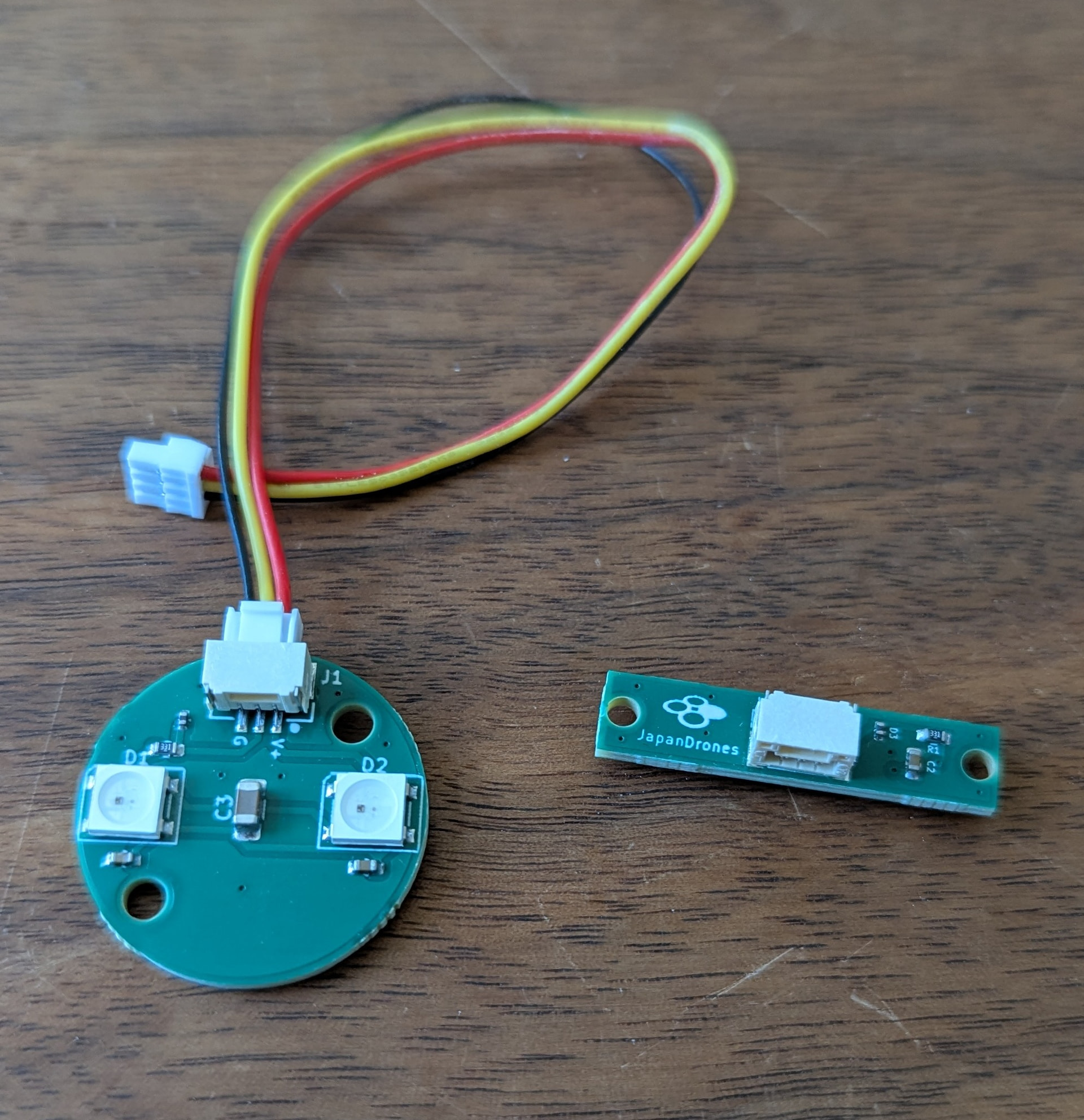

  2. Custom LEDs for the rear of the vehicle and under the arms are complete and working thanks to the efforts of a PCB designer from upwork.com and manufacturing by pcbway.com

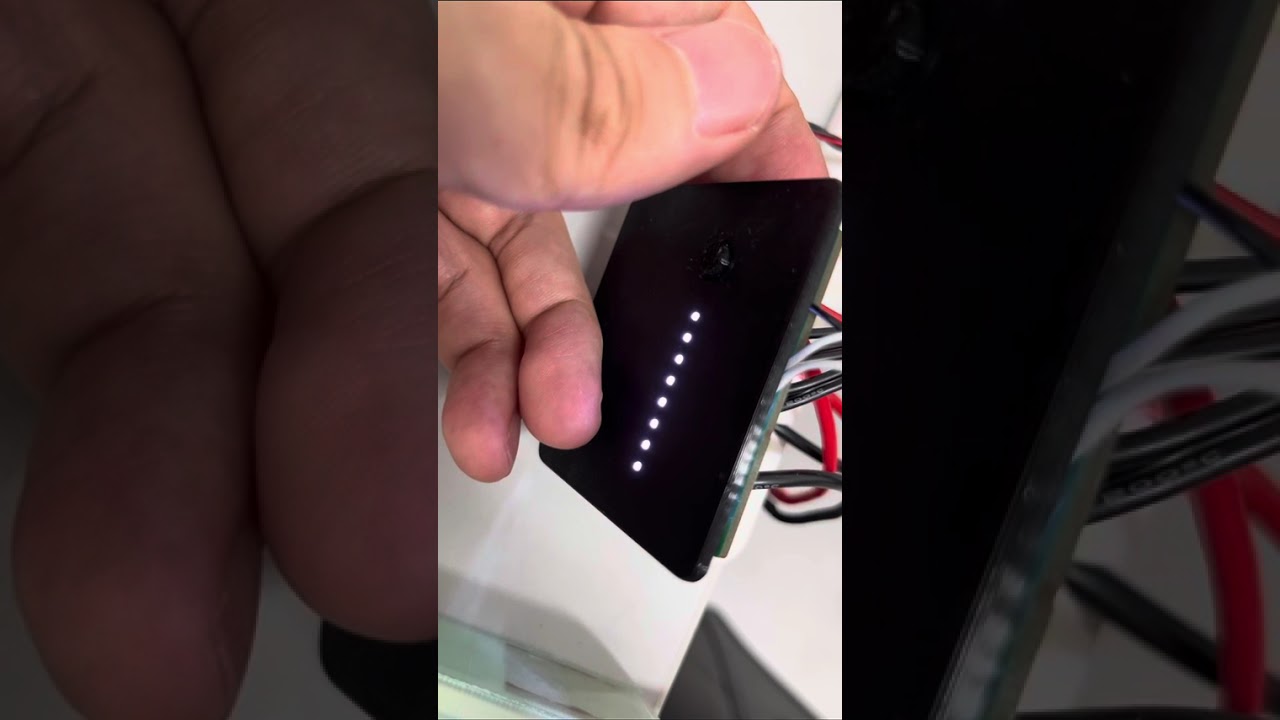

  5. The smart battery has moved forward significantly with an actual working prototype. Below is a short video showing how the button works. A short press makes the 8x LEDs light up showing state-of-charge (e.g. 1 LED = 12.5%). A long press turns the battery on/off (e.g. the drone will power up or power down)
