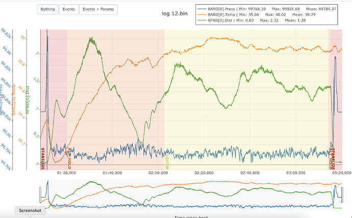

I have a small build flying indoors with baro and optical flow / lidar. I have been trying to dial in barometer for ALTH when lidar will be unreliable due to cluttered floors. Some of the parameters I have been changing are based on the recommendations here: Extended Kalman Filter Navigation Overview and Tuning — Dev documentation
I am noticing though that as the baro temp reading settles to a consistent temp, the vehicle is able to hold altitude much more reliably. Until then though, the vehicle ascends and descends while the desired altitude remains constant.
That screenshot is from the most recent flight, where I tried to hold altitude in a narrow hallway, approximately 1m wide. I realize that is a tough situation for any build, however, that is a common environment I am expected to be flying. Flying in stabilize mode is fine, but for certain situations, having altitude hold work consistently is the goal.
Nevertheless, the result is similar in open space, where the temperature needs to settle before having reliable altitude. When I say reliable, I will be happy with +/- 0.3 meter variance which is about what I achieved in that narrow hallway. Switching to Loiter was coincidentally aligned with temperature settling and more so I didn’t have to continually correct XY position in a confined space.
Log
I watched Andy Piper’s Pavo20 videos on this but his settings were not helpful for me. Any thoughts on this topic or how to improve are much appreciated, specifically if there is a way to handle temperature values until they settle.
Thank you

I appreciate the comment, though I mentioned in my post that I am wanting a reliable baro when the floor is cluttered. Sonar and lidar are only reliable with flat surfaces. As soon as sonar or lidar encounter objects under the vehicle, the vehicle will rise to maintain the desired altitude. That is behavior even with surface tracking disabled.

A small amount of jitter is acceptable. I do have foam over the baro. What I’m describing in my post is the temperature variable. Once the board/vtx temperatures settle, the baro holds pretty well.
I am aware of this. The post is really trying to address temperature from the board.

Right. And I’ve set EK3_ALT_M_NSE according to the data from my flights. A value of 0.75 seems to be about right based on what I’m seeing.
And maybe I am mistaken… what I am seeing from EKF4[0].SH shows that I am getting good sensor data.

By simply setting a few parameters, I was able to maintain altitude with +/- 0.5m variance in a hallway about 1 meter wide. Look at the data I posted. You want to talk about gust of winds or hovering in rooms… it was very windy in that hallway.
The baro uses a single value which is not enough to get a good curve fit.
