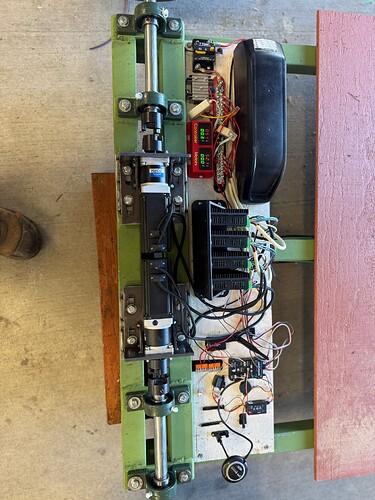

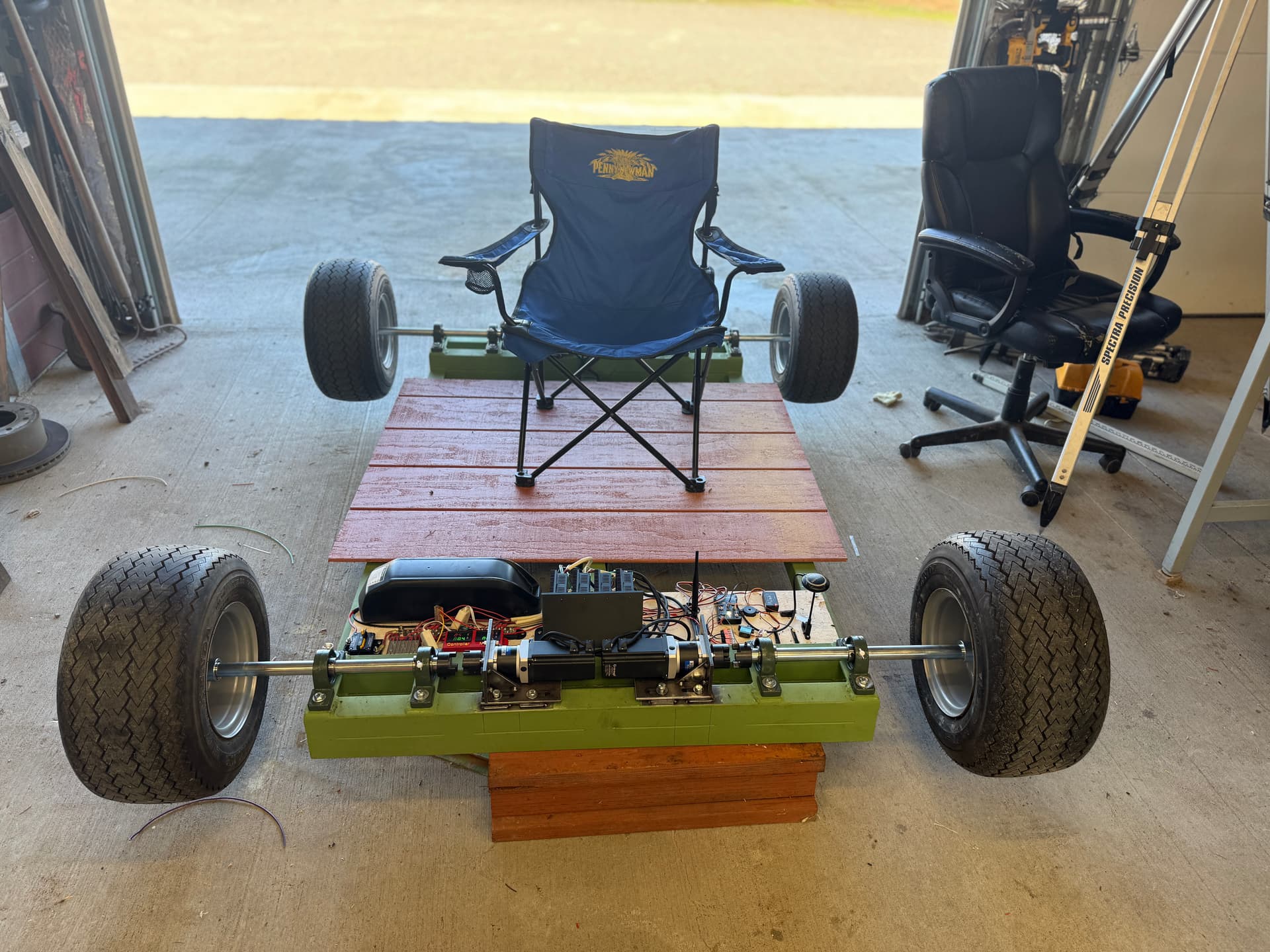

I’m working on a Ardurover project that is controlling 4 independent motors. The motors are 300watt brushless DC with dedicated motor controllers. The motor controllers do not work like bi-directional ESCs. They require a switch on the motor controller to toggle for forward and reverse operation.
I would like the ability to do pivot turns but I don’t see an easy way.

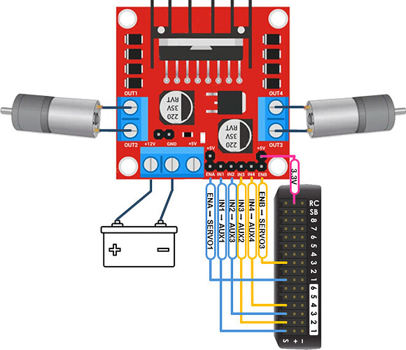

L298N with TTL glue.
However, the L298 won’t reach 300W. You can try some Pololu dual motor driver with additional power output stage, or hoverboard controllers.

@Webillo - because AP now supports inverted relay logic, there’s no need for any additional hardware, “TTL glue” (or scripting) for L298N drivers. They are supported natively (see link above).

But as seen that occupies four Pixhawk AUX pins. With the TTL glue only two Pixhawk AUXs are occupied, and the other four can be the four encoder interrupting inputs here.
Then it comes down to one’s definition of complexity and/or specific needs. Added hardware can be seen as equally good or bad as using additional GPIO.

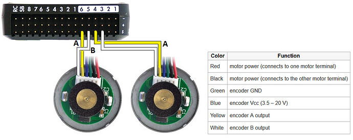

For balance bots, previous connections are incompatible with this ones:
The vast majority of Rovers are not balance bots, and most do not need/use encoders, either. Again, specific needs…

I confirmed that the motor controllers I purchased like a PWM signal from 0% to 100% rather than the RC servo type PWM signal.
I successfully configured the Adupilot for Brushed with Relay settings and everything worked great.
