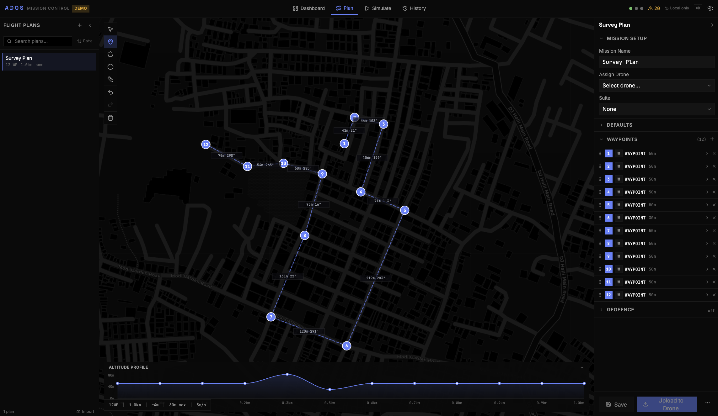

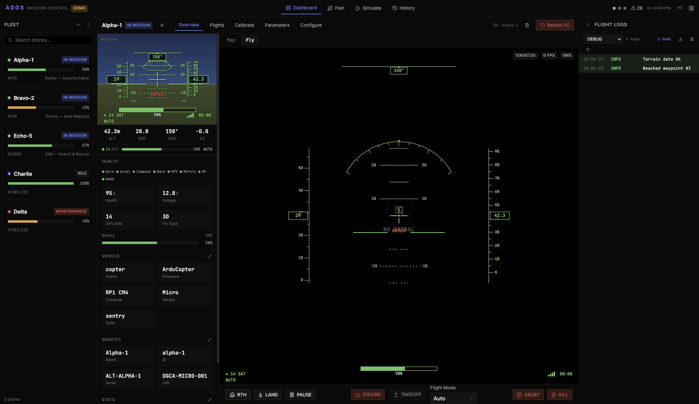

I’m Ajay from Bangalore. I kept running into the same frustration with GCS tools. Changing a flight mode, checking RC channels, calibrating a compass. The existing tools obviously work, decades of development behind them, but the UIs were fighting me more than helping. So I started building my own.
Altnautica Command is an open-source ground control station, GPLv3. Use it in the browser or grab the desktop app (Mac, Windows, Linux). Plug in your FC over USB and WebSerial connects it directly.
What’s New
This post is kept up to date. Newest changes first.
  • Country selector removed. No longer forced on setup, units default to metric, changeable in settings
  • Interactive CLI added. npm run cli for guided setup, demo mode, SITL with 7 drone presets, diagnostics
  • Post cleaned up and reorganized

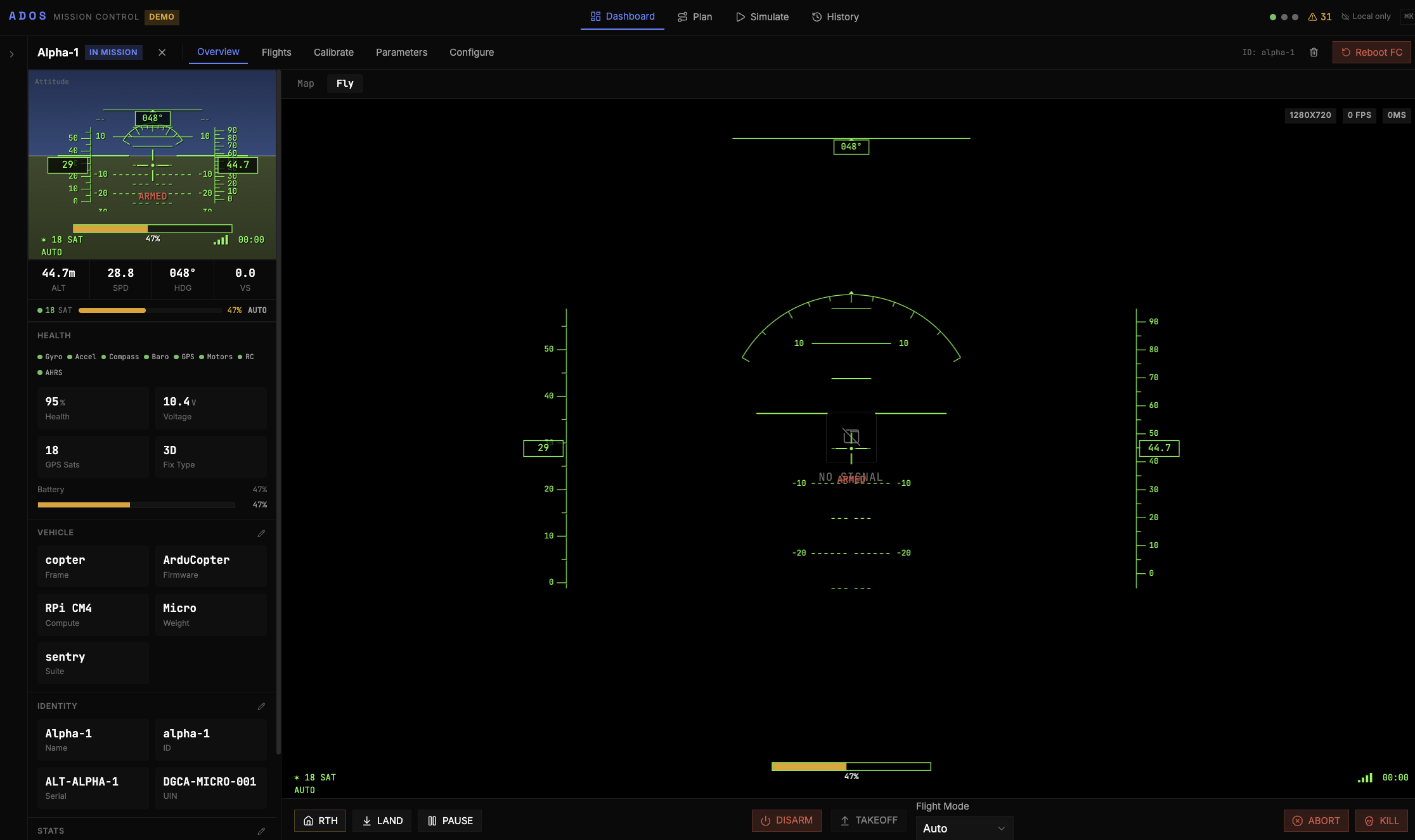

What it does
Browser FC connection. WebSerial API, no drivers, no middleware. Chrome or Edge on any OS.
Gamepad and flight stick controls. Fly with a gamepad, HOTAS, flight stick, or keyboard. 4-axis analog at 50Hz sending MANUAL_CONTROL messages. Deadzone, expo curves, full axis mapping. I wanted to grab a controller and fly from the browser and nothing else did that, so I built it.
Flash firmware from the browser. Select your board, pick ArduPilot firmware, flash over WebSerial. No STM32CubeProgrammer, no Zadig.

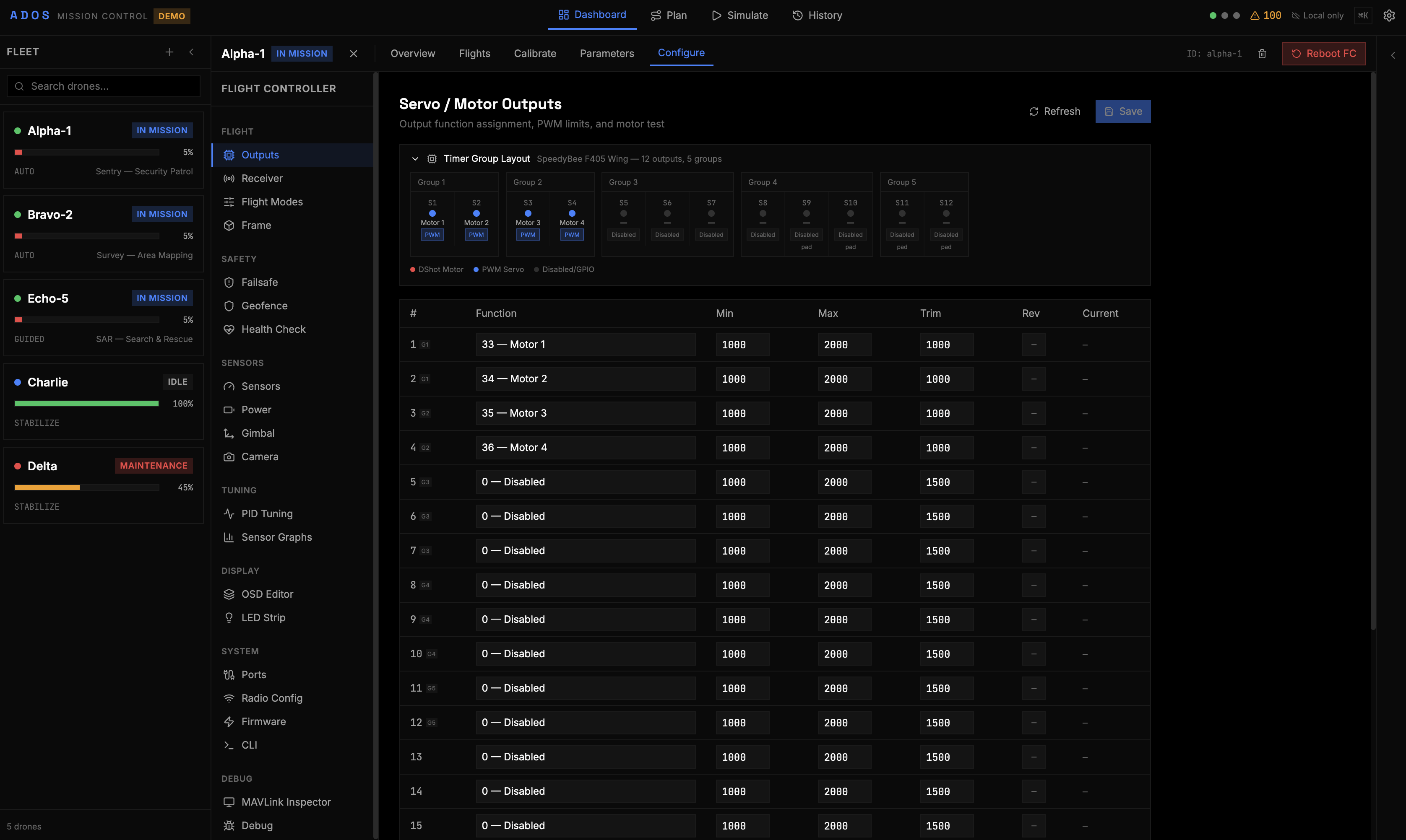

25 config panels. Full parameter tables. Calibration for accel, compass, gyro, level, ESC, RC. Flight modes, motor outputs, PID tuning, failsafe, power monitoring, serial ports, OSD layout editor, geofencing. Timer group conflict detection that shows which outputs share STM32 hardware timers. 9 board profiles right now (SpeedyBee F405 Wing/V3/V4, Matek H743, Pixhawk 4/6C/6X). Happy to add more, just tell me what you’re flying.
Mission planning. Drag and drop waypoints with per-waypoint altitude, speed, and actions. Geofence editor. Mission library for save/load. Upload and download with per-item ACK tracking.
ArduPilot fully supported. PX4 partial. Betaflight and iNav planned.

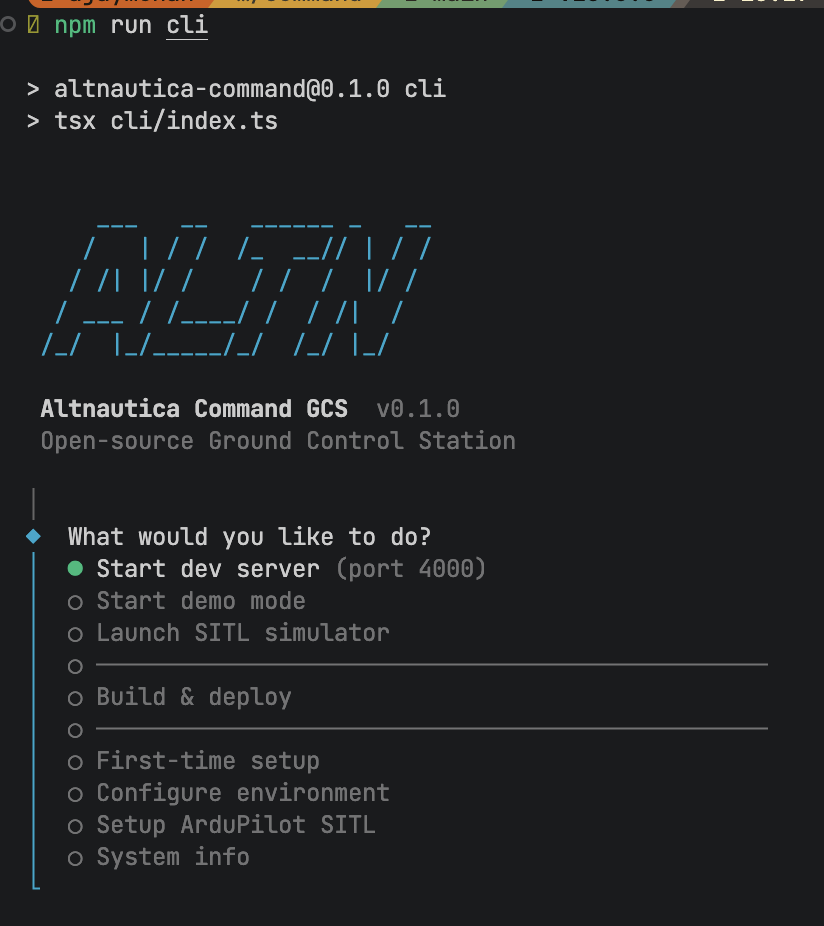

Interactive CLI
CLI
If you clone the repo, npm run cli gives you an interactive menu. No flags to remember.
  • Dev server on port 4000 with hot reload
  • Demo mode, 1 to 10 simulated drones with full mock telemetry
  • SITL with real ArduPilot physics. 7 presets: 5" FPV freestyle, 7" long range, 10" hex, cinewhoop, X-class racer, tiny whoop, and my 7" reference build. Configurable drone count, sim speed, GPS location, wind
  • Build and deploy in one command
  • Setup wizard that checks Node, installs deps, creates env config
  • System diagnostics
Each command works standalone too: npm run cli dev, npm run cli demo, npm run cli sitl.

Mission Planner

Configure

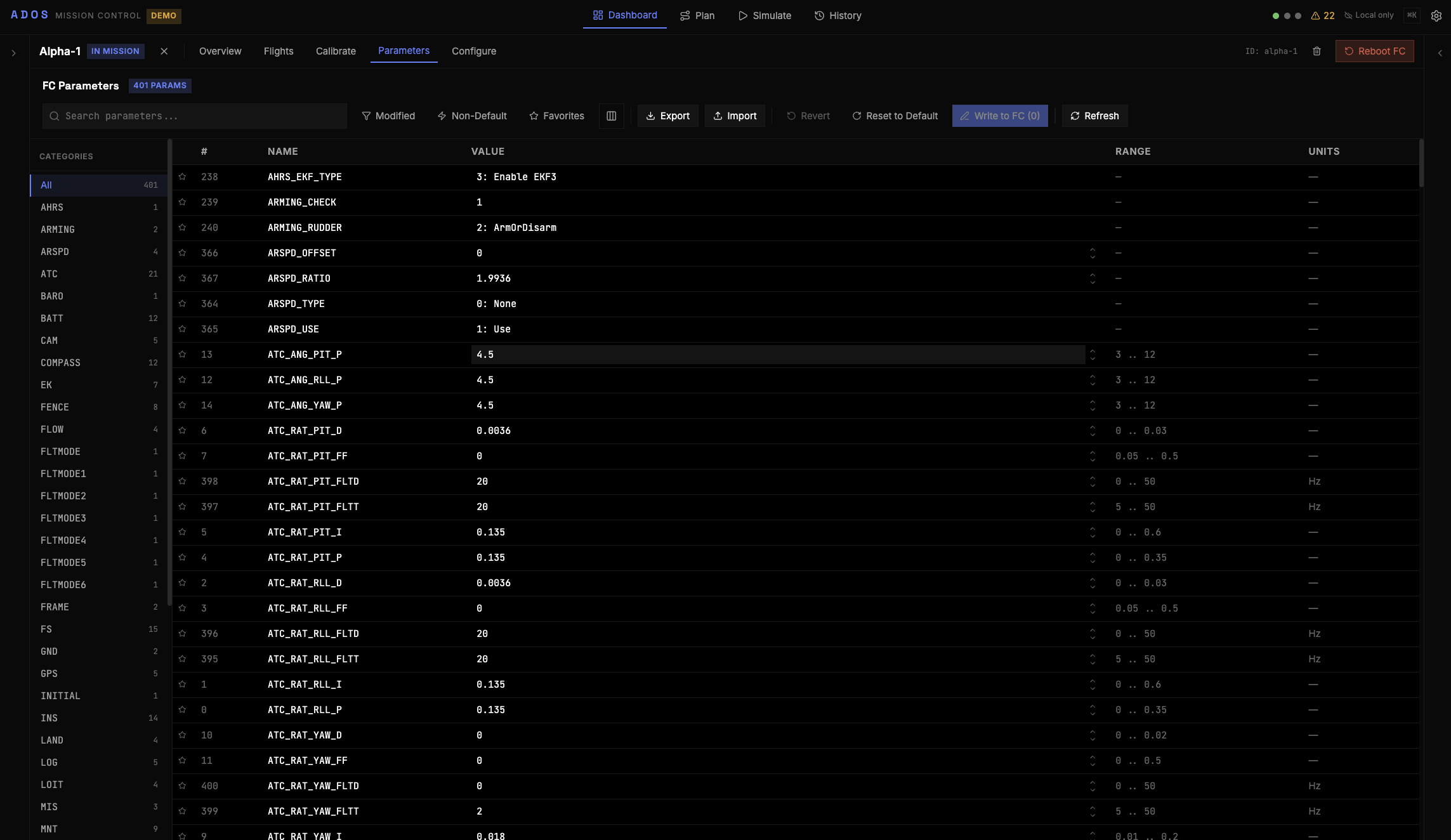

Parameters

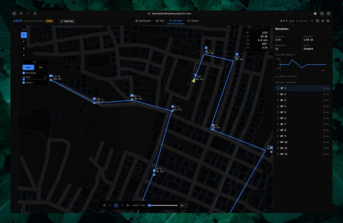

I love seeing all the new GCS options coming out. I do have some issues here after just a quick try.
  • I’m not comfortable with the browser based interface. I wasn’t able to re-size windows or move things around. I also often work in areas without internet. I see you say that I can clone it and run it locally, but that’s an extra process that many users aren’t interested in doing when all the other GCSs are already there. How will that work for tablets?
  • I didn’t like that each time I went back to the parameter page it had to re-load all the parameters.
  • There is a lot of wasted space on the main screen for things like the name and Id of the drone, and the regulatory info. That’s all good when opening the software but once I’m connected I don’t need to see that.
  • What do I if I’m in a country that’s not on the list you have? What does it matter? Why is it asking?
  • I find that a lot of the set-up buttons are too easy to access. Great when your setting up the drone, but once it’s flying a user shouldn’t be one click away from the calibrations. Also, having the re-boot button on the main page…. maybe it was just the demo mode but it didn’t even ask “are you sure?” That could be an issue for anyone on a touch screen.
Again, I’m really happy that people are trying new alternates for GCS software. But the browser interface has me very apprehensive. That has it’s place for flying BVLOS over some kind of internet based datalink, on setup and configured hardware. In that case, remove or bury the primary configuration and setup functions. However if I’m flying or configuring something then I want something local that doesn’t have to reload it’s data each time I click back to a page.

Really appreciate you trying it and writing all this up. This is exactly the kind of feedback I need. Let me go through each point:
Resizing/moving panels you’re right, the layout is fixed right now. No drag-and-drop. Opened an issue for that
Offline use it actually does work without internet. The FC connection is USB/serial straight through the browser (WebSerial API), no server involved. Your parameters, config, everything stays local in the browser. The map tiles are the gap, those still need internet unless you set up local tile serving. No PWA yet either, which would help with caching. That said, the core workflow (connect → configure → fly) doesn’t need internet at all.
Cloning you don’t have to clone anything. The live app works directly. Cloning is just an option if you want to self-host or hack on it. Should’ve been clearer about that.
Tablets works on Android Chrome (WebSerial supported). iOS is a no-go, Apple doesn’t support WebSerial in Safari. That’s an Apple limitation I can’t work around.
Parameter reload you’re right, that’s a bug. It re-downloads the full parameter list every time you navigate to that page. The data is already cached in memory from the initial connection the panel just isn’t reading from it. Just pushed a fix, should be work properly now (rebuilding, give 15mins).
Wasted space / info cards some panels do have collapsible sections (the mission planner sidebar for example). If you can tell me which specific view you were in when it felt cluttered, I can point you to the collapse controls or add them where they’re missing.
Country selector it controls unit display (metric vs imperial) and altitude limits. Only has India, USA, and Australia right now. Adding a “Custom” option so you can set your own units regardless of country. We focuse more about being legally compliant, but we should have added a custom option. eitherway, it’s purely there to drive UI tracking of your own drones and ID management.
Setup buttons during flight there’s actually an armed-lock system that blocks all configuration panels when the vehicle is armed. You can’t reach calibrations, parameters, or port config while armed. But I hear you on the touch screen concern when disarmed, the reboot button especially.
Reboot without confirmation you’re right, that’s a miss. Some reboot buttons have a confirmation dialog, others don’t. All of them should. Opened an issue.
Browser vs local fair concern, and I get it. The bet is that browser APIs (WebSerial, WebSocket, Gamepad API) are good enough now for real work, and having one URL that works on any machine is worth the trade-offs. But it’s not for everyone, and I respect that. If the parameter caching and layout issues get fixed, I think the “reload” feeling goes away for most workflows.

npm run cli gives you an interactive menu — dev server, demo mode, SITL simulator, build & deploy, setup wizard, system diagnostics. No need to remember flags or commands.
The SITL launcher has 7 drone presets built in (5" FPV freestyle, 7" long range, 10" hex, cinewhoop, X-class racer, tiny whoop, and my 7" reference build). Pick one, it spins up ArduPilot SITL with a WebSocket bridge so the browser GCS connects directly.
First-time setup walks you through Node check, dependency install, and env config. npm run cli info shows you what’s ready and what’s missing.
If you clone the repo, try npm run cli and let me know if anything’s confusing.

Parameter caching fix. This was flagged in the thread and filed as Issue 1. Parameters were re-downloading every time you opened the config panel. Fixed that, the list caches after first download now. (Will simplify the cta row in the future after all the config panels are in and tested.)

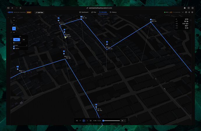

Advanced flight planning & simulation:
  • 3D Global render
  • Add terrain-resolved 3d flight path
  • Visual Feedback during terrain resolution
  • Much better render performance updates
  • Better terrain elevation awareness in simulation
  • Advanced flight planning toolkits
  • KML/KMZ/CSV export/import shipped
Much more!

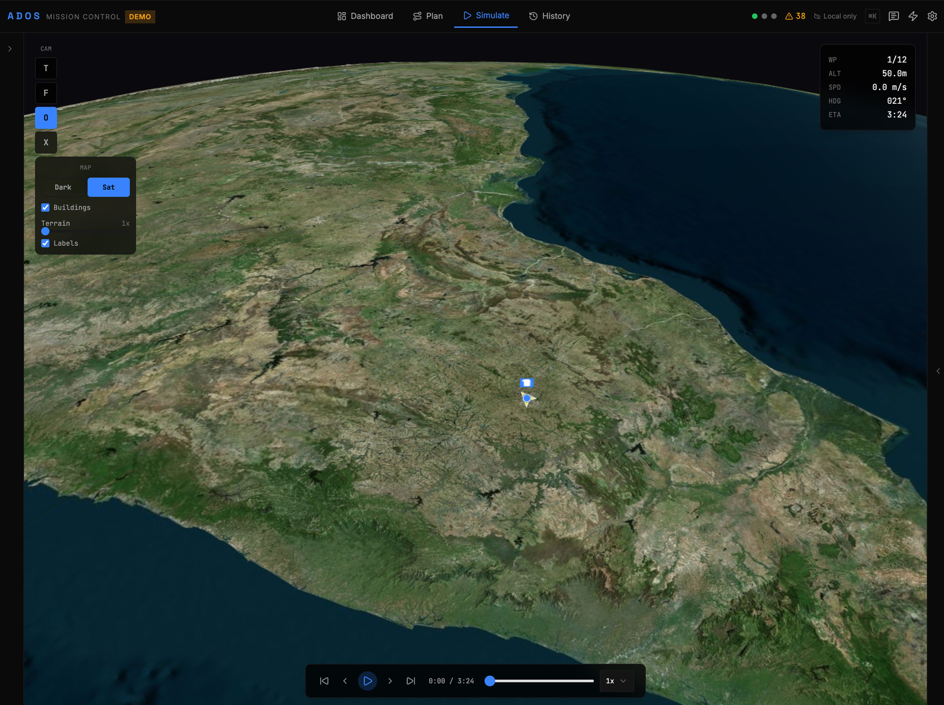

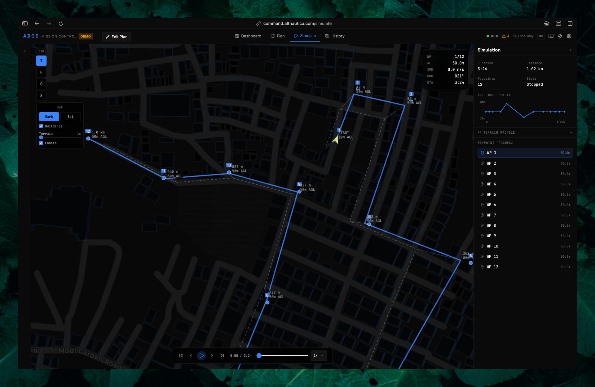

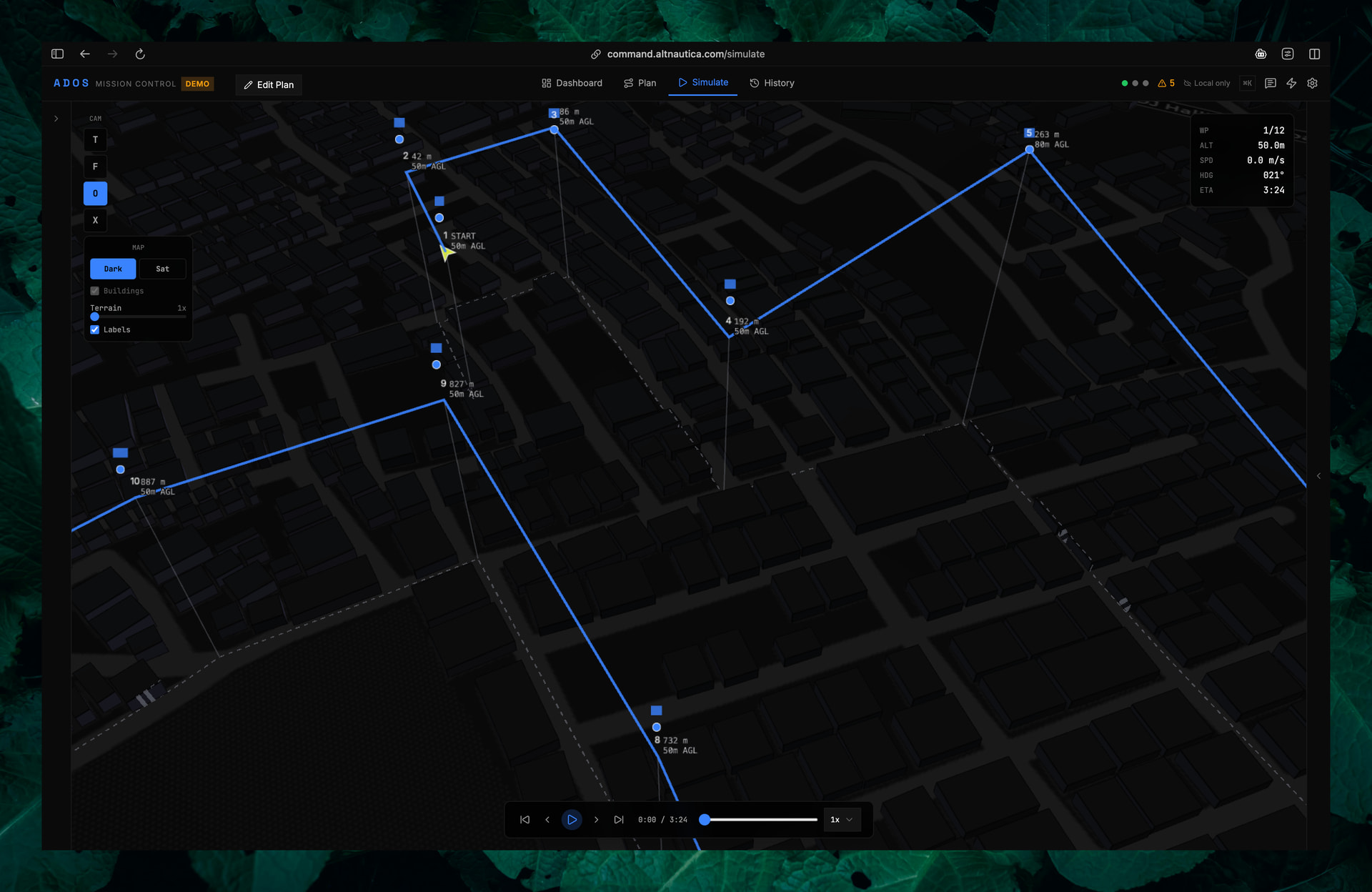

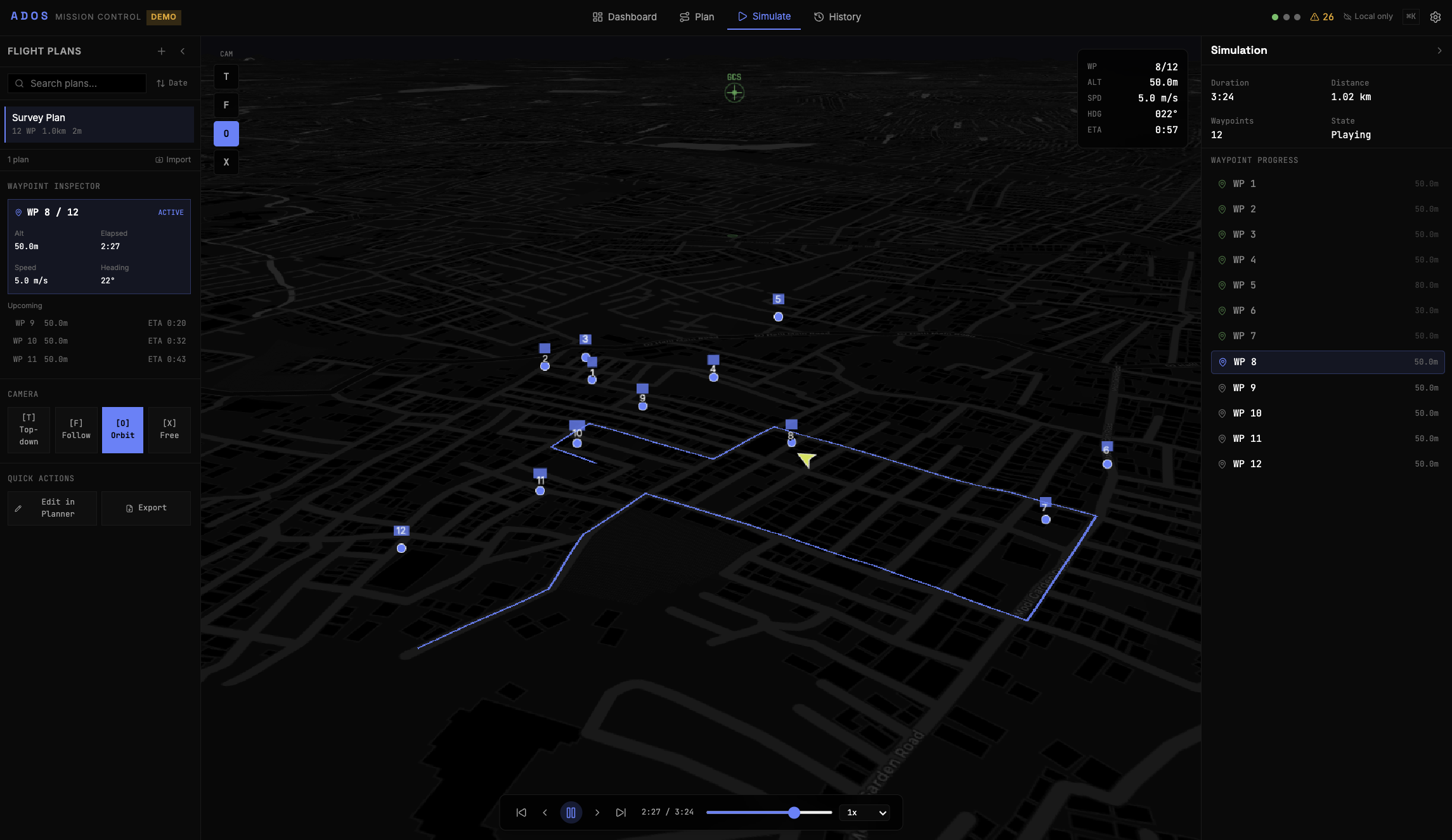

Additional Screenshots from 2nd march update just got live
Better 3D aerial visualizations with terrain + elevation tracking
3D World Models for Simulate
Sat Map Mode + Demonstration of Real 3d Terrain Sim
Next Patch → Hardened calibration suites for all board platforms & More planning & simulation fixes & feature coming soon. Do stay tuned!
