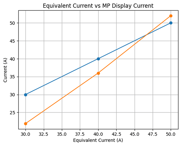

Observation
The figure below compares equivalent current (true input current) with the current value reported by the module (MP).
  • Blue line: Ideal behavior (y = x)
  • Orange curve: Actual measured output of the current-sensing module
Key observation:
  • The system is accurate near 50A (calibration point)
  • As current decreases, the displayed value becomes systematically lower
  • The error increases toward low current, indicating non-linearity rather than noise
Measured Data Points
Equivalent Current MP Display Error Error Rate
50 A ~50 A 0 A 0%
40 A ~36 A −4 A −10%
30 A ~22 A −8 A −27%
Error characteristics:
  1. Systematic bias (not random noise)
  2. Error magnitude increases as current decreases
  3. High-current region is accurate
  4. Low-current region is strongly compressed
The current implementation uses:
  • Zero-offset calibration at 0 A
  • Single-point dynamic calibration at 50 A
  • Piecewise gain correction using segment-specific multipliers
Mathematically, the current model is:
y = k(segment) × x
This allows only slope adjustment (curve rotation).
However, the plotted result clearly shows that:
  • The error is not purely a slope error
  • The curve is shifted downward at low current
  • Increasing k in low-current segments fixes 30A but causes over-scaling at 50A
This indicates a missing intercept (offset) term, not just a gain mismatch.
