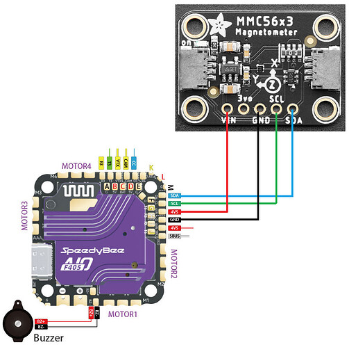

The next most likely problem is the pin mapping. The board appears to have two qwiic connectors that are JST SH/SR connectors but the port and pin mapping is definitely not compatible with the regulard JST-GH connectors that most autopilots use.
The pin mapping for the autopilot is here
So it needs to be lined up with the adafruit compass pinout.
This wiring might work but it’s actually slightly incorrect because I suspect the SpeedBee’s I2C logic levels are 3.3V and this will make them 4V or maybe 4.5V. It will probably work but it’s not quite correct. A better solution would be to provide 3.3V into VIN but I don’t immediately see a 3.3V output from the SpeedyBeeF405AIO.

Also as for the pinout I have the pinout of SDA and SCL exactly as given in the pinout by you.
But for the pinout of power I am using the “A” “B” pins given in the pinout for GND and 5V respectively.
Hopefully that is not a problem.

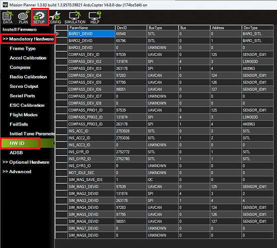

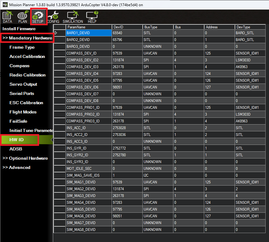

Hi @DynaRTX,
Could you share what you see on the MP HW ID page?
I suspect that there is an issue with the SpeedyBeeF405AIO hwdef pin mapping for the I2C, the compass is broken or it’s not OK to power it using 5V (it might need to be 3.3V)
