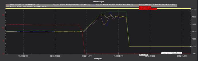

But when i tried flying it yesterday it faced a event of freefall just after 2 min of flight, NO changes were made in bird/configuration but this time temperature of motor was too much, average 60+.
Log of crash
Now what should be my approach to this

My first blind guess was the all-up-weight change (a different battery maybe). When a copter is tuned tight for a particular weight, and then the weight drops, the old PID gains may become too high for the new physical layout, which can easily result in overheating. But in this case the battery current usually changes, and here it was about the same for the first and the second log.
The tuning is, by my standards, very sloppy, especially in yaw. If one compares, in both flights, actual versus desired pitch, roll, and yaw from ATT records, deviations in pitch and roll reach up to 2 degrees, and yaw deviates by 5 degrees easily, and by more than 10 degrees in the beginning of the flights. This is consistent with small rate PIDs in pitch and roll (0.06), default angle P values and recommended initial angular accelerations, which overall indicates lack of tuning: we are just in the “basically flyable” state, not in anything looking good. This cannot fly well, but - returning to the topic of the post - there is nothing in the tuning that would cause overheating.
Looking at other sources of information, I noticed that in the first log the reported onboard temperatures were in the range of 31-39 degrees C, where 31 is likely the outdoors temperature as it was reached in flight. The second log features 44-48 degrees. Unless there is something in the physical layout of the craft, you just hit a very hot day.

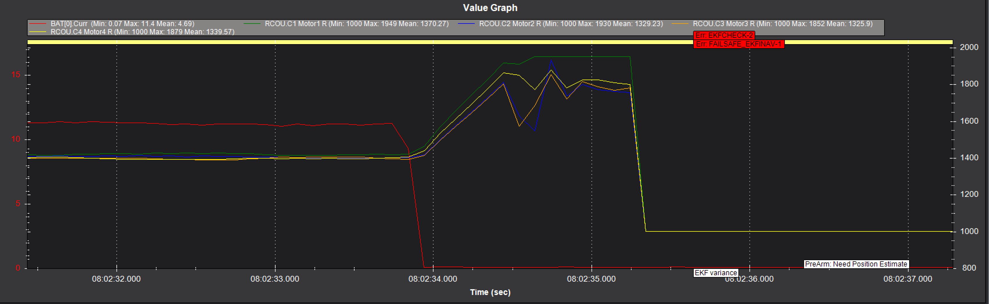

I have not got the particular nature of the crash that ended the second flight, but all the motor outputs spiked high and the altitude dropped. [Whatever happened, 60+ deg of motor temp might have also been the result of this short current burst too.] - as indicated below, current dropped here, so it’s not the reason for 60+ on motors. It may be that on the colder day the motors were just colder and you were not triggered.
Battery current drops to near zero so perhaps the ESC’s shut down or they lost power. What ESC’s are they and why have you not configured for Bdshot for the telemetry? And yea, tuning is poor.
Ah, yeah, current drop at the same time outputs spike up. Thank you @dkemxr. Can be ESC overheating protection or a similar thing.

Primary observations shown same kind of things, Motors stopped rotating before fall, indicating either ESC reach its cutoff or power loss.
To varify this things one more flight was taken and bird flied without any abnormalities, excluding higher motor temperature.
So ESC cutoff can be probable cause, and same can be confirmed as on i have ESC RPM data now.

Hopefully extended telemetry data that includes ESC temperature.
I do have ESC temperature and RPM Data
Same Issue Persisted
ESC temperature 130+

Revisited parameter setup with AMC, everything was working good. But issue with ESC temperature was still persistent, so to verify working of ESC, another ESC was replaced.
With same setup my bird is working good, have validated it’s functionality multiple times through rigorous testing. Again for cross confirmation Older ESC was placed and then issue persisted, so concluded that fault was with ESC hardware
Summary :
Issue was with both parameter setup and hardware. AMC helped a lot, it’s a great tool, Kudos @amilcarlucas
