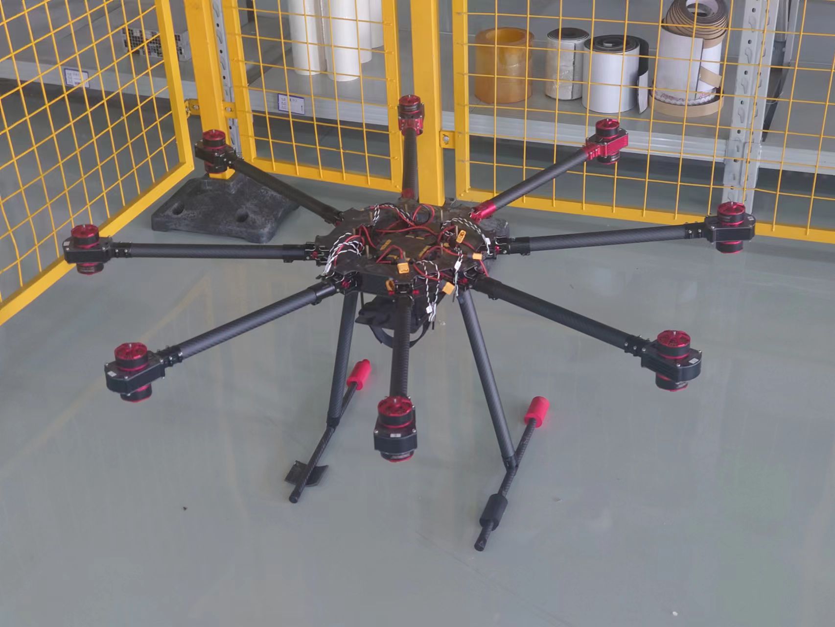

Hello everyone!
I’m currently encountering an issue. I have a large 8-axis, 16-propeller drone, and I wrote a Lua script to modify its motor mixer:

However, after uploading the script to the flight controller, it reports the error:
bad argument #1 to 'add_motor_raw' (out of range)
I haven’t found any related documentation online, and I’ve seen developers mention that Lua scripts support 16 or even 32 motors. Does this mean I need to try modifying the ArduPilot source code? Or is there a simpler solution?
You will have to be on 4.7.dev to run more than 12 motors.
I’m interested in what you’re trying to do. I like the 12 motors.. would love to try 16! What size props are you doing with it?
I just found a copter in the warehouse that someone made – not sure who. It’s been sitting there for a long time.
