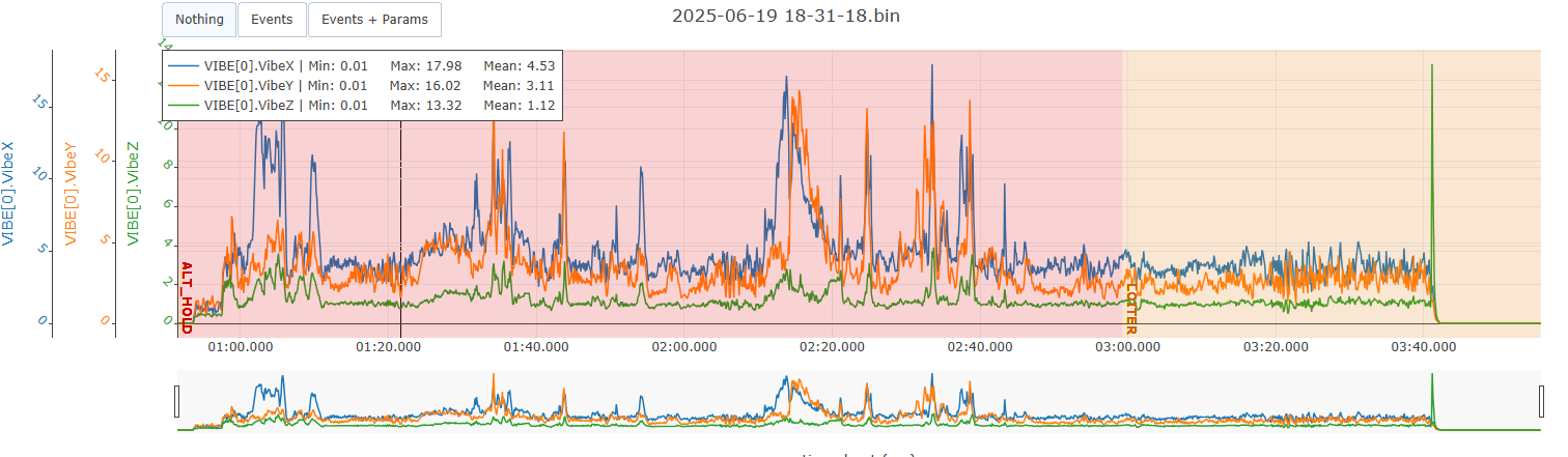

Check your vibrations level, set INS_HNTCH_FREQ to something lower - like 80 - you have not requested movements on pitch.

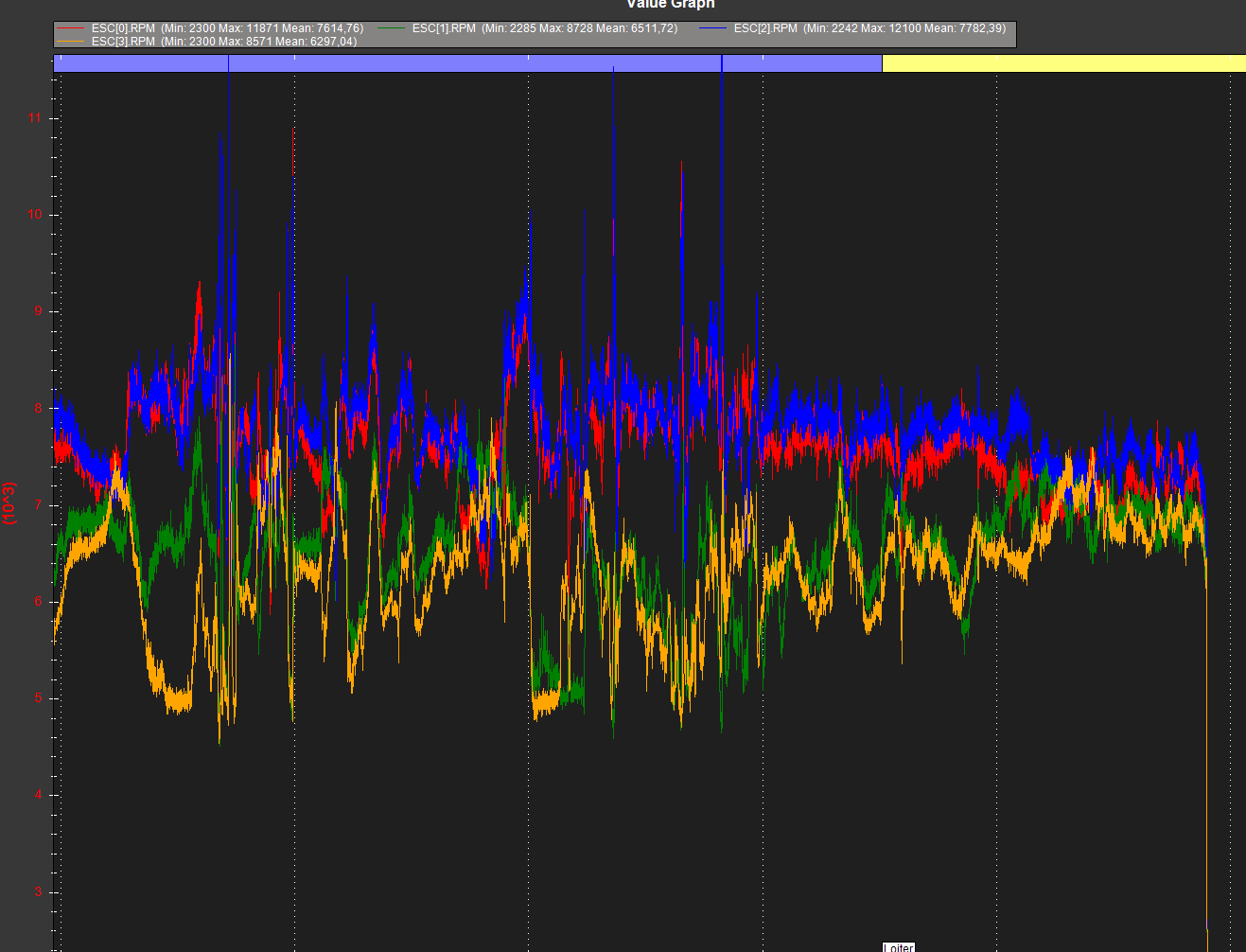

Also you have noticeable imbalance, your motors 1 and 3 working much harder than 2 and 4, that can be a reason.
The quad hovers at %5 throttle so it should be able to compensate for the imbalance, I have rebalanced the quad and it didn’t change anything.

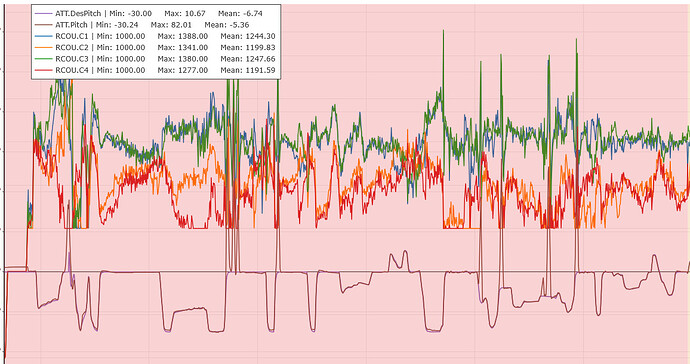

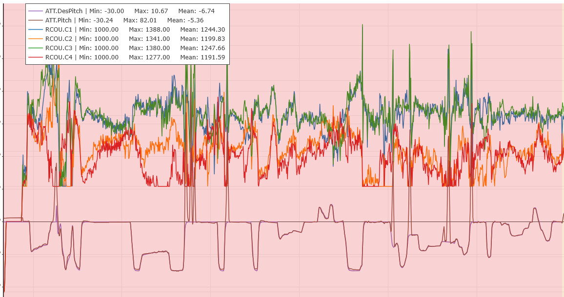

Your are correct I didn’t request any pitch movements but the quad responded in hard pitch moves. you can see it in the video.
vibrations are within normal range.

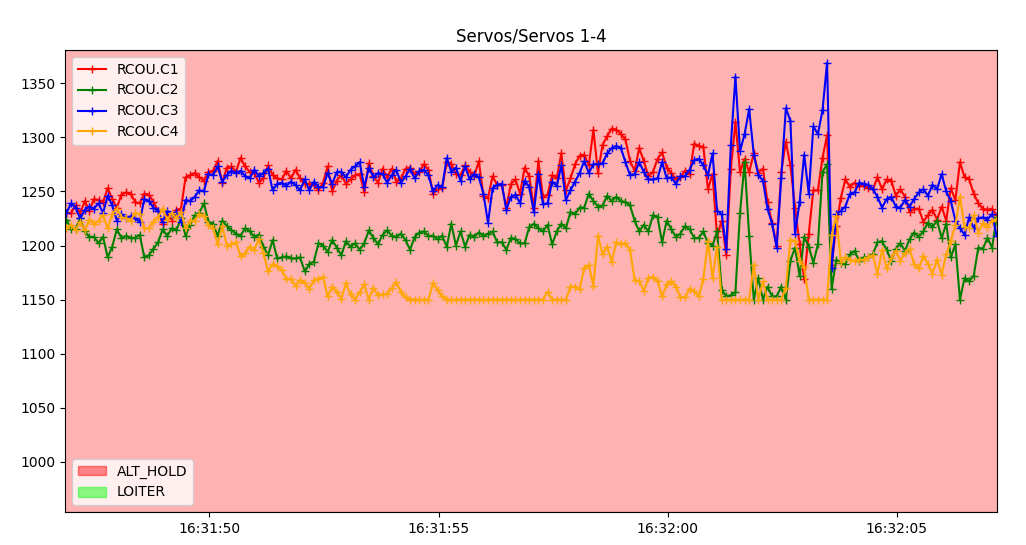

Motor 3 (RC4) and motor 1 (RC2) - the front motors - are running at minimum. So basically they since they can’t slow down any more and your hitting a control saturation. I get the impression this quad is well powered.
MOT_SPIN_MIN and MOT_SPIN_ARM are too high (still on default). Especially _MIN. Verify with the motor test but I bet you could drop those down to _ARM .05 and _MIN,0.08.

You still need to look in balance It’s clear that 4 and 2 get down saturated and 1 and 3 getting spikes on movements change.
your min/arm values are absolutely correct when tested I updated them, I also am putting a heavyer battery on (normally I run 5000mah, but I am putting a 10000mah) I want to see if that helps. I will rebalance after adding the heaver battery.
