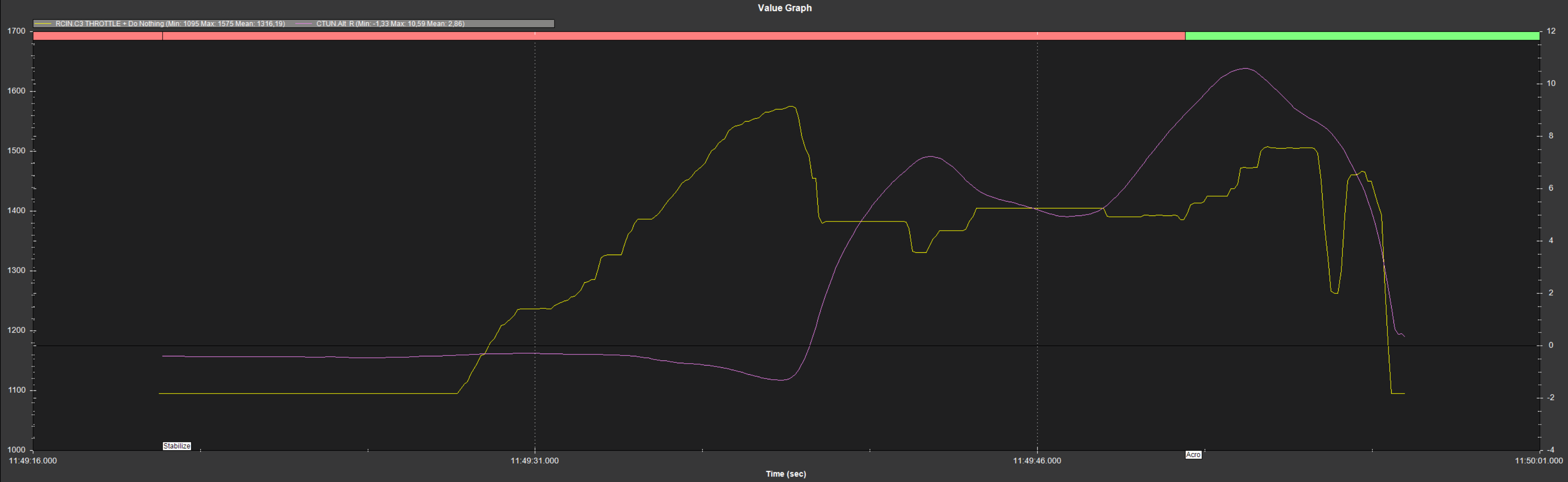

Thanks for sharing the video. That’s really helpful. There is one thing that instantly caught my attention. Right after takeoff, the heli is in a hover a few centimeters above the ground and then suddenly skyrockets. That is not in line with the stick inputs of the pilot.
The pilot slowly raises the collective (yellow line). The altitude plot (pink line) shows that the pressure under the heli changes, but in the moment the heli starts to rise very quickly, there wasn’t a change in collective that could explain that behavior. Before I saw the video, I interpreted that as the heli somehow sticking to the ground (for example in high grass) and then suddenly coming free. But that is definitely not the case here. The heli is already in a hover and then suddenly climbs. This climb wasn’t commanded by the pilot and as I already mentioned, in stabilize mode, collective pitch is under full manual control, so the climb wasn’t commanded by the FC either. I also can’t see large changes in the RCOU signals right before the climb. That again leads us to a mechanical failure. Something must have happened that caused the swash plate to go up.
That is probably what the pilot reported as sudden climb. I always looked at the second climb right after the heli started to pick up speed to its left side. But the problem definitely occurred earlier.
No, it was a result of the mode change from stabilize to acro. As you can see in this plot, it happened right after the mode was changed and it was indeed commanded by the FC. The pilot did not actively command it by stick input, but he showed a fast and adequate reaction and accepted the movement (he made a stick input in the same direction). We could dig deeper into the logic of the FC and why this movement happened after the mode change, but this was definitely not the cause of the crash. It happened long after the pilot had completely lost control over pitch and roll movements.

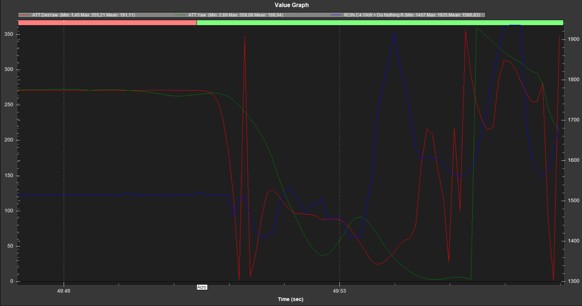

Please post the log file for the maiden flight where you said the aircraft behaved well. As for the aircraft yawing 180° during this last flight, I have a theory regarding acro mode and how it handles yaw when aircraft target attitude goes inverted. I will need more time to review the code and understand how it handled the situation. What bothers me is that the target angle wasn’t limited as it should’ve been because acro trainer mode was being used.
@Goobisofty I have confirmed using the simulator that the aircraft will perform uncommanded yaw when large pitch (elevator) stick inputs are made in the trainer mode that you had set (the default settings). Even with a well tuned aircraft this will happen. So I will have to check with @Leonardthall to see if this is expected behavior for the trainer mode.

The first thing we need to understand when discussing “uncommanded yaw” in acro is that the ATT message is the Euler angles while acro is being controlled in the body frame. This means that you don’t need to command any yaw input to change the euler yaw angle or heading of the aircraft. For example if you roll 90 degrees then pull the pitch stick you will not see any change in Euler pitch angle, the roll angle will stay constant at 90 degrees and the yaw angle will change quickly.
The other thing to understand is the target euler angles are where you have commanded the aircraft to go and when an aircraft is not able to control it’s attitude then it will be a combination of both the attitude you have commanded and the effect of the actual aircraft attitude dragging the targets around due to limits in maximum angular error. This can make looking at a log like this tricky.
One final point before I get to the log. Both acro and Stabilise are both flying the aircraft in the same way. If you can’t fly an aircraft in Stabilise you can’t fly it in acro. The reason we recommend Stabilise is if you centre the sticks the aircraft controller will do it’s best to level the aircraft. It will do this even if the angular errors are getting out to 30 or 40 degrees. However the same angular errors in acro make it impossible for the pilot to fly because they can’t see where they are telling the aircraft to go. They are commanding a ghost aircraft and the real aircraft is trying to get to where the ghost is. But the pilot can only see the real aircraft. This isn’t a problem when the difference between the ghost and real aircraft is only 1 or 2 degrees. But when it is 30+, nothing good happens.
Ok. Lets look at the flight.

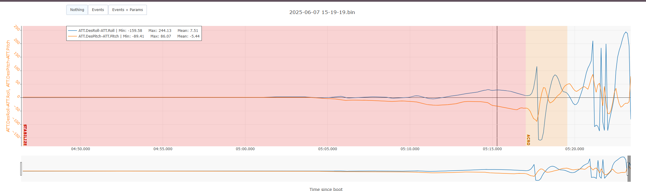

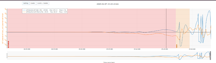

As soon as you took off the attitude error started to grow. By the time you switched into Acro, the aircraft had achieved a roll error of 29 degrees and a pitch error of -45 degrees. At the moment of the switch the aircraft had a roll error of 6.74 degrees and a pitch error of -40 degrees.
As soon as the pilot switched to Acro they commanded the aircraft to do a 360 degree flip as they attempted to lift the nose. What I mean by this is the ghost aircraft did a full 360 degrees rotation in pitch but due to the poor control the real aircraft couldn’t follow that at all and only managed to pitch up by … well it hardly moved.
As you expect the yaw target flipped as the ghost aircraft went inverted then level again. As the pitch command is reduced there is a lot of roll that gets commanded and the ghost aircraft rolls inverted for a second. Again the roll and pitch control is so poor the aircraft doesn’t do this.
This is the roll and pitch errors through the flight:
I hope this helps understand why the yaw flips around after acro and why you should stay in Stabilise until the aircraft is well tuned.
