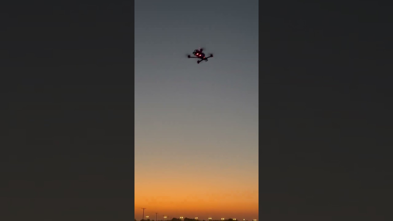

I just read some previous solutions firstly cover barometer and then decrease these two parameters
PSC_ACCZ_P
PSC_ACCZ_I
Current values are default.
PSC_ACCZ_P,0.5
PSC_ACCZ_I,1
Is it correct to proceed with..?

Proceed with default? No
Go here, it’s more than just changing 2 parameters to get a 7” to fly from defaults.
Tuning Process instructions
And/or go to Andy’s build blog for that same frame. 7” LR Build
Thanks, i am following @andyp1per tuning guide but actually ESC, motors and flight controller is not same so I expect some differences.
Follow the tuning guide and figure it out.
There is a template from Andy Piper, for a Chimera 7 with step-by-step detailed instructions on the AMC, It clearly and automatically sets those two parameters for you. Why are you not using it??
I saw it great work by the way I follow it when You post the methodology earlier I will try the AMC and correct as applicable.
