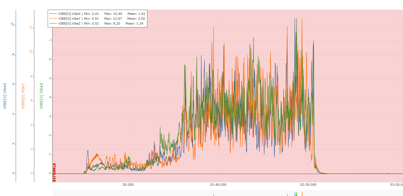

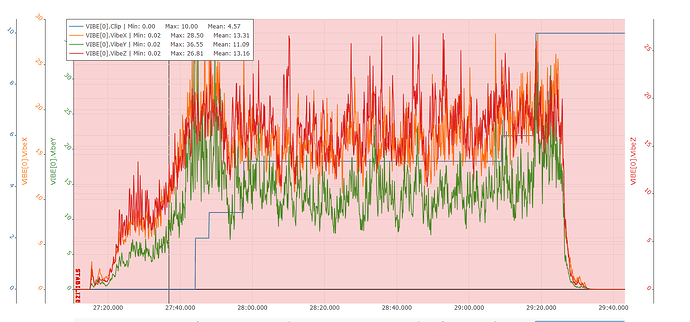

I see from the logs that vibrations increase with increasing speed. What could be the reason for inadequate behavior under heavy load? Strong vibrations? Maybe it’s in the fltt, fltd filtering? We are currently produce vibration isolation - we will try to reduce vibrations to the required < 20. But what scares me most is that the drone simply at some point starts to tilt strongly somewhere and almost falls with a large load.

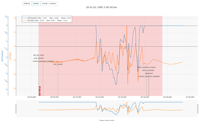

Logs number 30 - 80 kg load

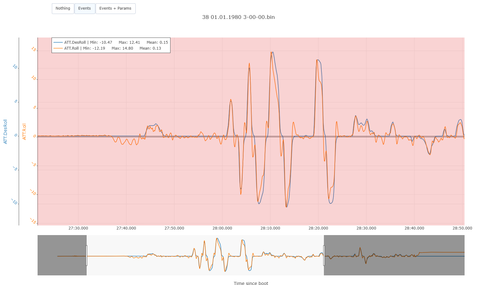

Logs number 38 - 55 kg load
You have some pretty high vibrations for starters…
Yes - in 30 log - vibe very strong.. Next days we trying make vibro isolation for FC. But i’m think maybe problem in MOT_THST_EXPO for X13 motors 45kv.

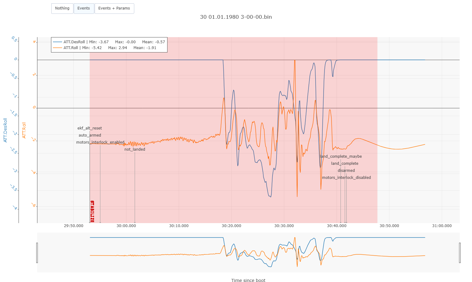

From ATT logs i’m see that with 85kg (30 log) ATT very very strange - desired pitch/roll far from pitch/ roll. I’m think this is because very strong vibrations and wrong notch settings.. I’m think need reduce vibrations and tune notch. From 38 log 55kg - ATT more better.

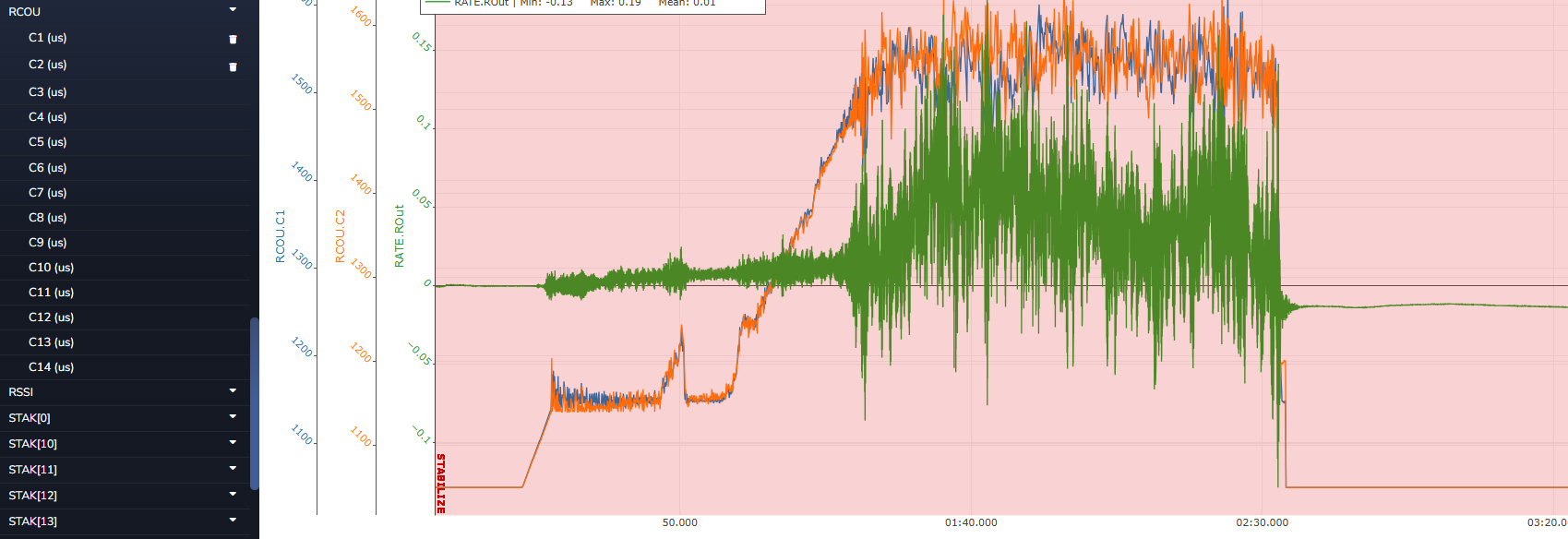

Next, we need to set up filtration and remove acillations (RATE.out - more than 0.15).
I also noticed that they were not set correctly SERVO
_MIN and MAX (need 1050 and 1950)

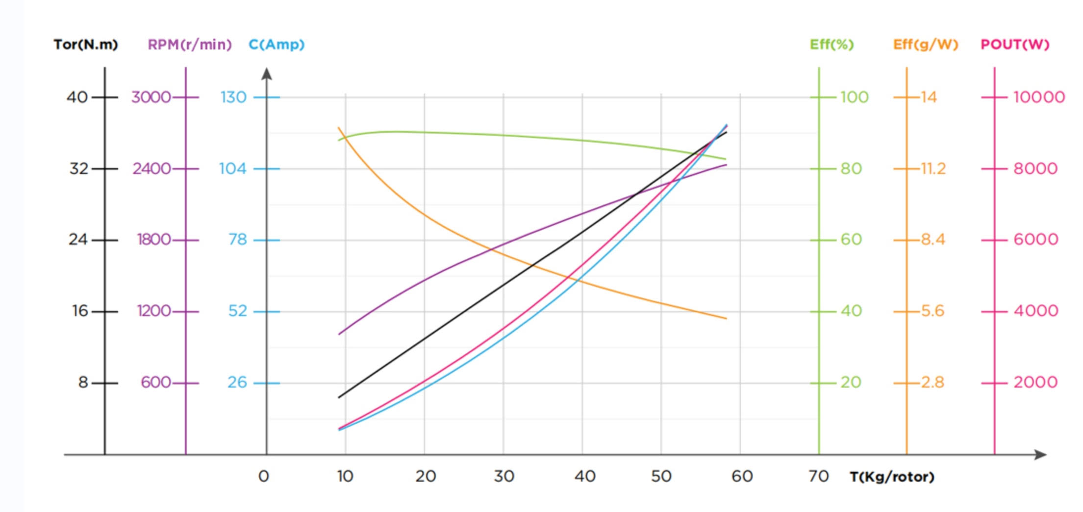

If it is an X8 copter with an X13 motor, a load of 80kg is likely to reach the critical value of the motor overload.
It should be noted that the motor performance parameters may be false.
Drone have weight 106kg with battery’s and without any payload. Payload 40 or 80kg (one or two tanks)
X13 + 5720 props have 15-55kg thrust. we need max 25kg for one motor.
The structure of the upper and lower dual motors loses about 20% of the lift. 25x2x80%=40kg.
The lift of the whole machine is 40*4=160kg, minus the weight of the fuselage 106kg, the load is about 54kg.
It just meets the above situation that the flight state is good when the load is 60kg, and the flight state is bad when the load is 80kg.

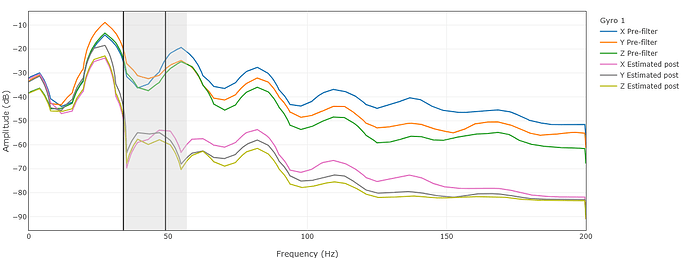

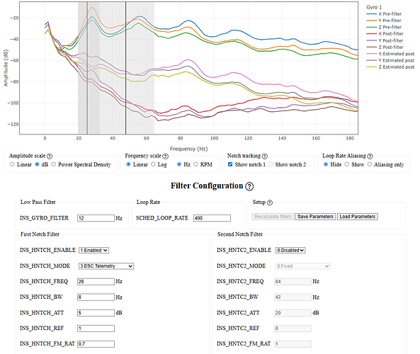

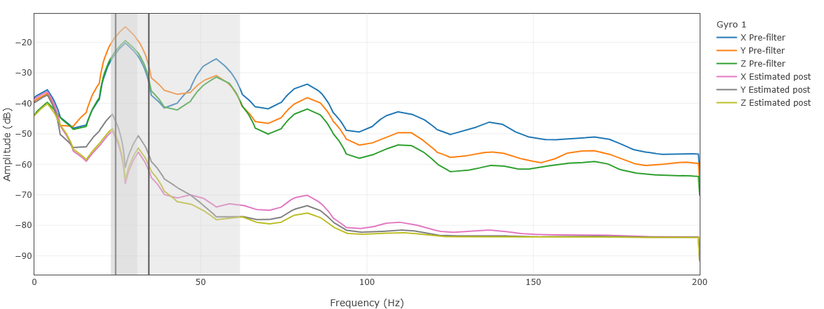

While you do have vibe issues to sort out, you should carefully review the notch filter configuration documentation. For batch logging, enable pre/post, not just pre. INS_LOG_BAT_OPT = 4

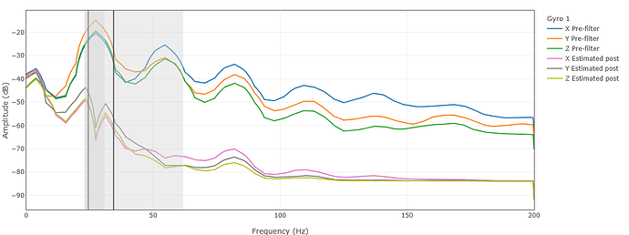

This is a graph of your current settings
You are using ESC Telemetry for tracking, but your settings are limiting how low in frequency they will track, and missing the main harmonic.

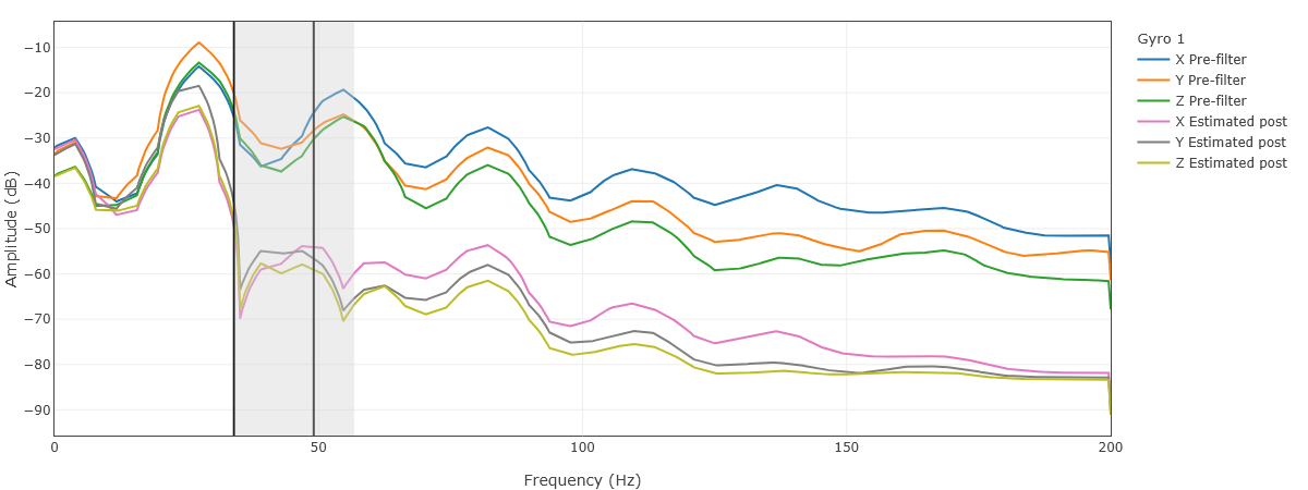

This is a graph with some adjustments and the settings I used to get them.
NOTE This is an EXAMPLE and should be used to inform how you make changes as you reduce vibes. These changes are rough estimates right now, and you should check the documentation to make sure you understand their impacts.
filter.param (331 Bytes)

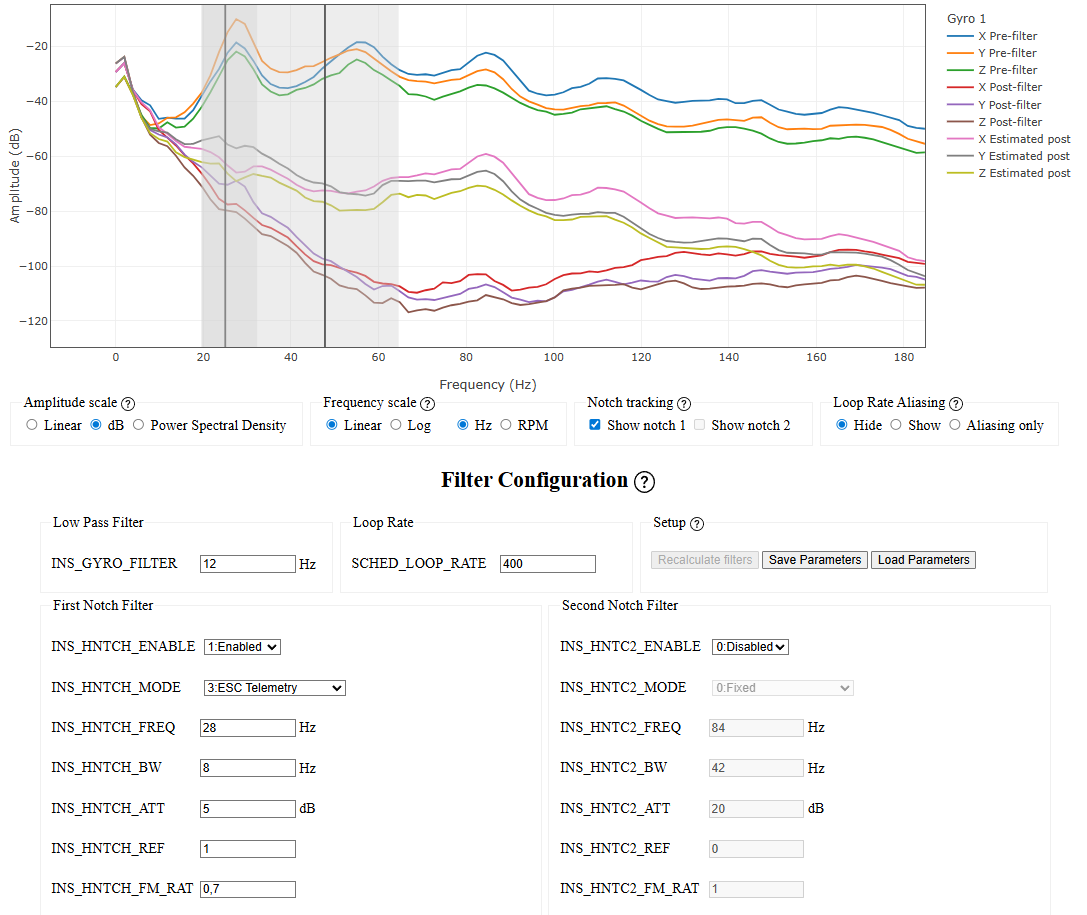

In the new plot, I’ve lowered the notch filter limit to 23hz and enabled multi-source tracking, which sets up a notch filter for every motor as opposed to taking the average. For this, it is required to reduce the bandwidth and attenuation settings, as now there are more notches and the results are additive for each notch. I’ve also un-selected “triple notch” in case that adds too much load on your flight controller. I also lowered your gyro filter to 10hz. The general rule on the forums is to get your noise below -50dB, and with your current level of vibes, you’ll probably find that you need to keep the gyro filter lower than you had it (20hz).
I must make clear that making such adjustments incorrectly can result in the loss of your craft. Particularly, changing the attenuation and bandwidth due to the selection of “multi-source” can result in over-filtering and undesired response from the craft. Same goes with the lower gyro filter.

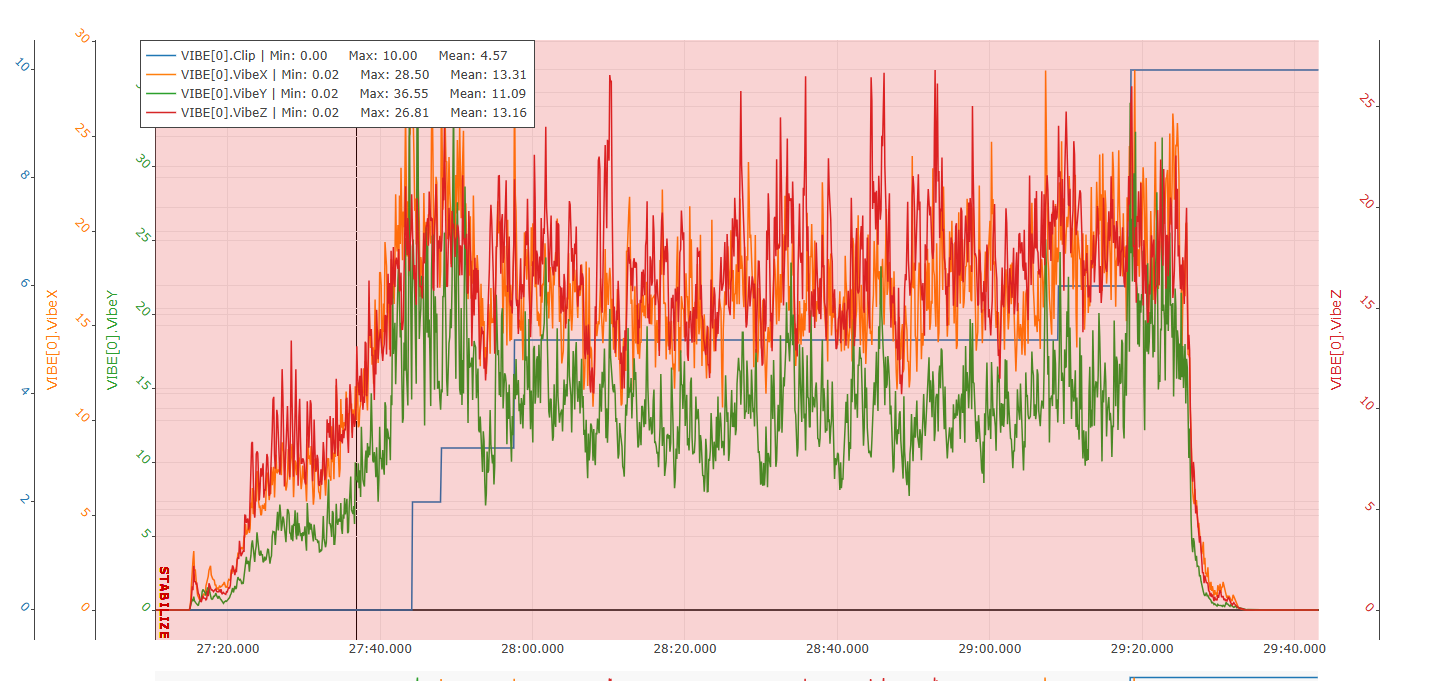

We have reduced vibrations - I posted a new log number 108.
Yes, we need to work with the filters. I did one test with multi source and 4 harmonics turned on -
logs - https://drive.google.com/file/d/1xEo8eEFH29JjWflbQKoqxD39zgHurmQy/view?usp=sharing
it filters well, apparently, but ATT very unstable - i’m think don’t need to turn on 3-4 harmonics - but lower the gyroscope cutoff filter as you wrote, and here are the settings below, apparently, they should give a good result - noise is less than 50 everywhere (the first harmonic is on the edge).

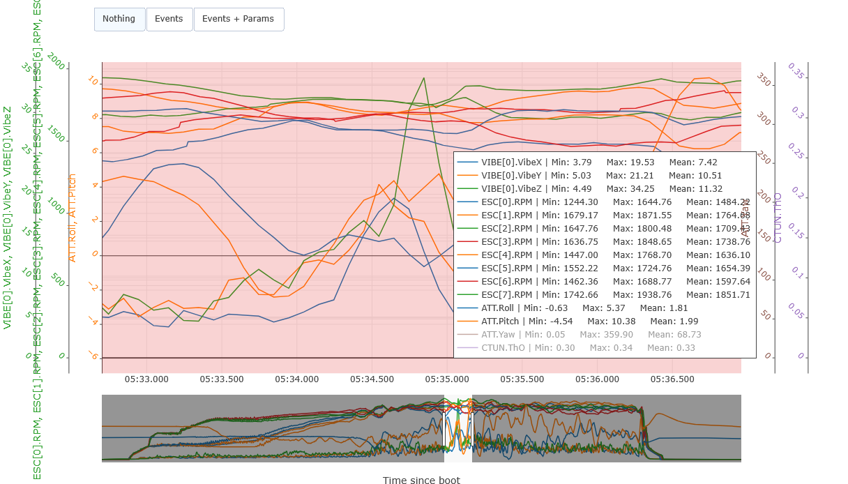

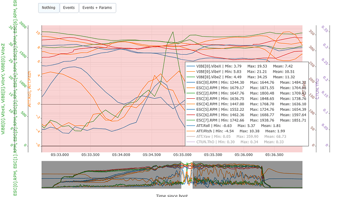

And there is one very unpleasant thing - very often and randomly some motors seem to enter into resonance and the speed on them drops - and the drone almost falls - but then after a jerk it recovers - this can be seen in this last log in 5.34.846 timestamp - because of this jerking the vibrations increase sharply. Perhaps this is due to an incorrect gyroscope cutoff filter
I’m not yet used to reading octaquad logs, was there a strong wind from the left side of the craft during flight?
During that vibe spike you mention I don’t see a particularly strong throttle drop. However
Right before the pop you can see how every arm’s motor pairs sync up in rpm. I have a feeling that contributed to the resonance. @Leonardthall ?

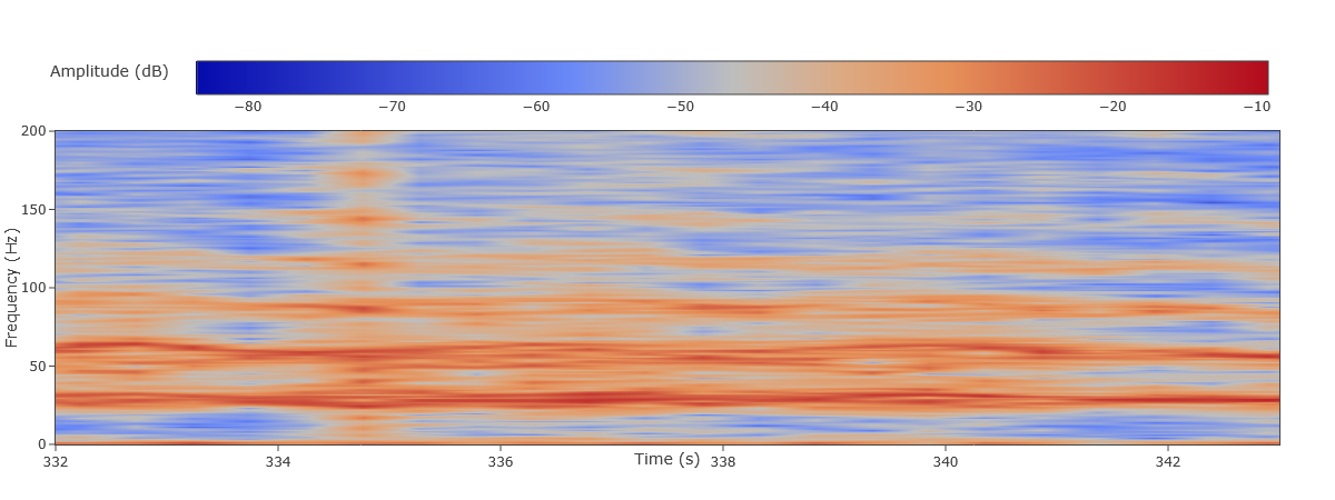

This is a specrogram of Z vibes, it seems like there is a lot of noise coming from motor 8. This is a stab in the dark, but I’d be curious to know if you find anything loose on that motor or arm.
