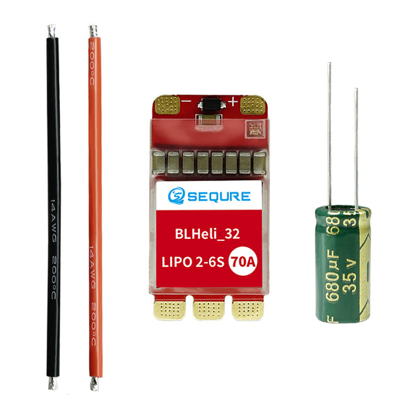

This is a good choice but the ESCs are far from perfect for your setup.These YEP ESCs are “normal” RC-Airplane ESCs which are not well suited for hovering vehicles. They are big, heavy and not optimised for fast control loops.
I want to suggest to switch to AM32 ESCs. This is an opensource ESC firmware project specially designed for copters (which includes VTOLs ). Active freewheeling is standard as far as i know.
Sequre 2670 should be a solid choice for your VTOL:
