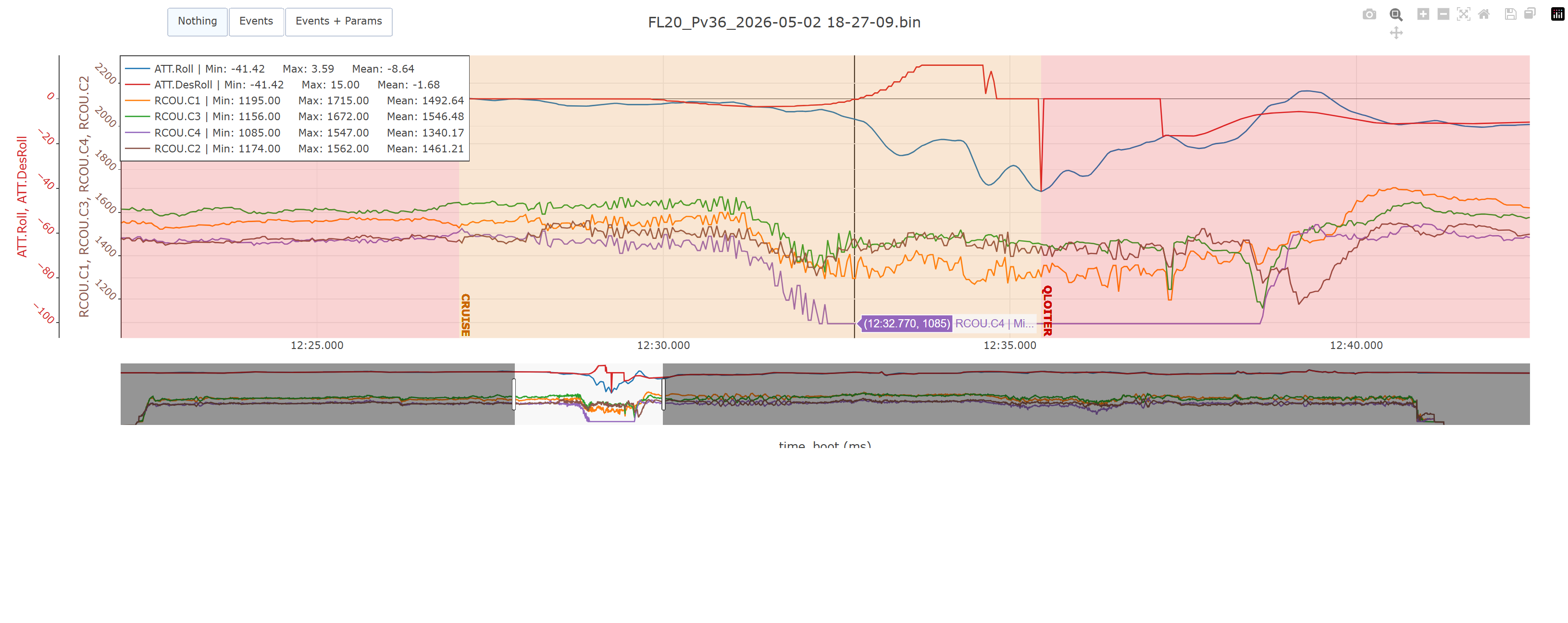

Here are the flight logs from my test flights:
Please help.

However, you log file indicates that the desired roll and actual roll begin to diverge, and the PWM signal to elevon also diverge, i.e. it seems that the action is inverted.
Your GPS speed grows, so it is not a problem of stall.

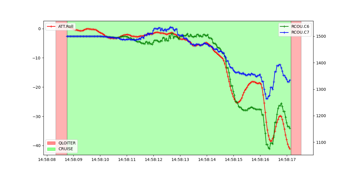

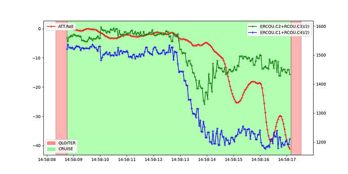

Based on your description, it doesn’t seem wrong at first glance. Still, a video would be helpful, because judging by the log file (FL20_Pv36_2026-05-02 18-27-09), I find it hard to believe:

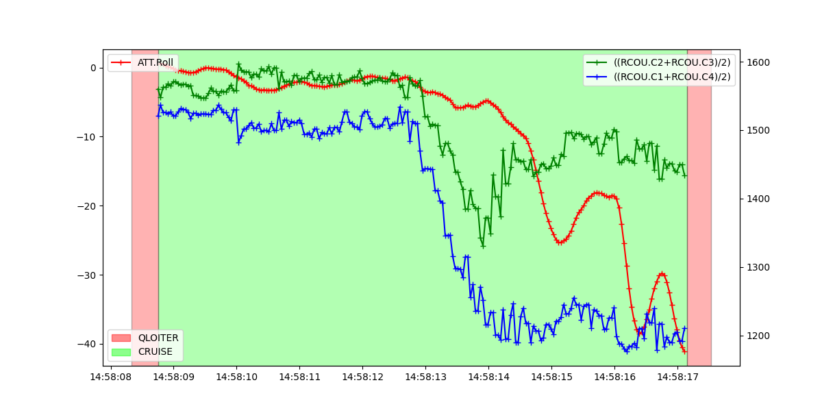

During the transition, it is noticeable that the quad motors reduce their power relatively suddenly:
Even at that speed, the airspeed is already sufficient for the control surfaces to begin to be effective:
The cause is likely a sudden pitch-up, which requires reducing the quad’s power during the transition. For clarity, the average of the quadcopter motors is shown. You can see how the pitch deviation is corrected while the roll deviation gets worse and worse:

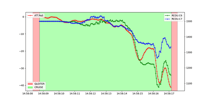

During the transition, the quad motors or the rudders could cause erratic roll behavior. First, the quad motors. The graph shows the average of the right and left quad motors. The VTOL is rolling further and further to the left, even though the quad motors are working against it; it is clear that the right motors are almost shut down and the left ones are delivering significantly more power.
What do the control surfaces do?
While the quad motors counteract the roll, the rudder inputs seem to have the opposite effect and actually intensify the roll in the wrong direction.
That’s why I’m actually looking forward to seeing a short video showing the control surfaces moving left and right as the fuselage rolls in FBWA mode :wink:

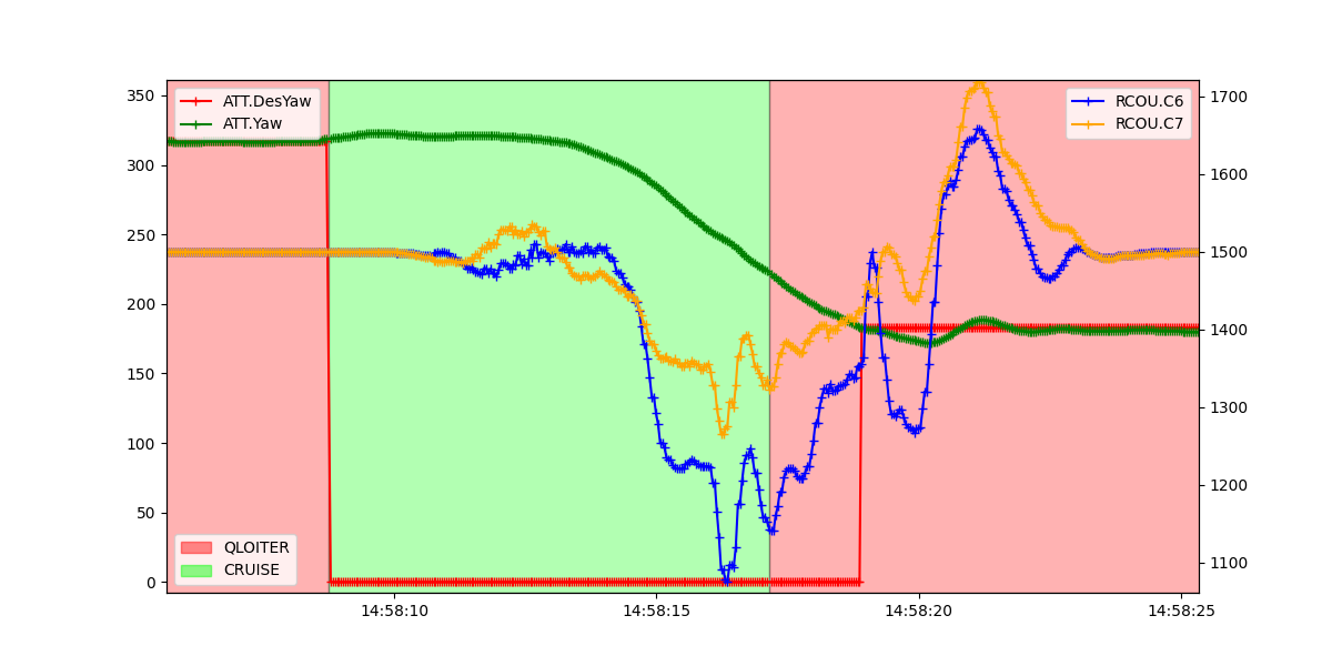

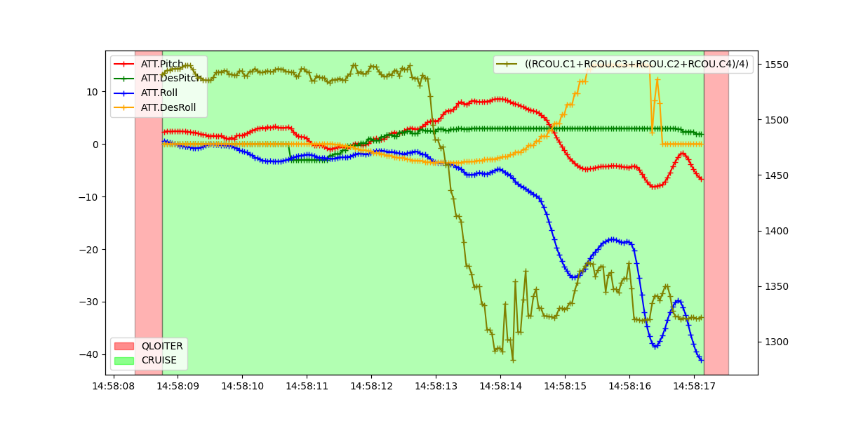

There is another detail I see, that is, the desired yaw changed strongly just before the roll, so it could be that CRUISE mode was executing a roll to achieve the yaw it thought was needed. Not sure why. And then, the desired and real roll should be the same.
If you want to take a risk, I would try to make a transition to FBWA mode, there, the yaw would be irrelevant.
That’s a good idea, but in my opinion, the change in flight direction is a result of the strong roll, not the other way around, if you look at the sequence: The desired yaw change does not immediately affect any of the control surfaces.
The question certainly remains as to why Desired Yaw suddenly diverges from Yaw by nearly 180° when the transition is initiated. I’m stumped by that, too.

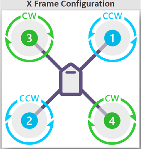

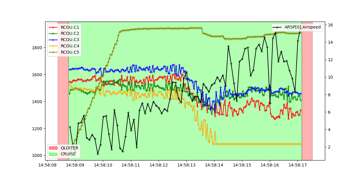

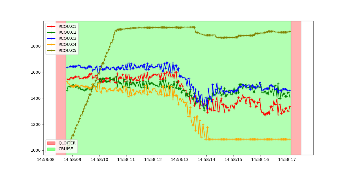

I have a slightly different take to this erratic behaviour. You can see in both logs that one of the motors is completely shut off when CRUISE is switched, while the others are still working and not spooling down. If this motor is the left rear one, this tilts the plane to the left and yaws it to the left also (the front left motor is still working, rotating to the right, and the counter-rotation twists the plane to the left). The motor on RCOUT 4 still doesn’t switch back on for a while after switching to QLOITER mode… so the roll and the yaw to the left continues until it spins back up. I would look at that ESC or motor… (but mainly the ESC calibration).
Hello @Nemozoli,
Thank you for taking a look at the logs.
M4 is the rear-right motor.
My analysis is that since the quadplane is rolling left, the right side of the motors (M1 and M4) has to reduce, and the left side (M2 and M3) has to increase to try to balance roll.
Also, since the drone is also front-heavy in VTOL mode, the front motors (M1 and M3) have to work harder to maintain pitch, so M1 can’t go to minimum to maintain pitch, so only M4 goes to minimum
Regarding ESC calibration, all ESCs are well calibrated.
What are your thoughts on this?

I have seen in logs that the desired yaw goes to 0, exactly when the plane mode (transition) starts, and goes back to normal when the Q modes kick back in.
I think it is because (as stated in the docs): “ArduPilot, in fixed wing modes (except ACRO mode, if yaw rate controller is enabled), provides NO direct rate stabilization or heading angle hold for yaw, as it does for pitch and roll”. Source: Yaw and Yaw Control in Plane — Plane documentation
So I think that the desYaw is useless in plane modes.
Also, let’s say for a moment that the plane was trying to follow the desired yaw set to 0, then also, the initial yaw was around 300° before transition start. If it really wanted to go to 0°, it should have turned right, not left, correct?
Secondly, to support this, when the transition starts and till it ends, the “RATE.YDes” is not logged, or is 0. This confirms that the rate controller was not working for Yaw.
What are your views on this?
Also, regarding elevon movements based on PWM, here are the details:
  • For the right elevon, it moves up when the pulse decreases from 1500us, and moves down when the pulse increases from 1500us.
  • For the left elevon, it moves up when the pulse increases from 1500us, and moves down when the pulse decreases from 1500us.
So, for countering the uncommanded left roll, the plane should try to roll right, that is, right elevon up (pulse decreasing), and left elevon down (pulse decreasing). I can see in the logs that both the “RCOU.C6” and “RCOU.C7” are decreasing when the plane is rolling left.

I took a look at the speeds. Sorry I didn’t do this sooner. AIRSPEED_MIN is 17 m/s, and you listed the stall speed as 14 m/s. The quad motors start to cut out very early, at around 10 m/s. This is likely caused by the pitch suddenly increasing. In any case, it’s likely a tip stall. Now we need to figure out why your VTOL is experiencing such high pitch fluctuations already during the transition.
Rolf
Yeah, I also noticed just now that the quad motors start to cut off around 11m/s. I don’t know why. Could it be possible that the quad motors spooled down early, and the wing started stalling because of less airspeed?
