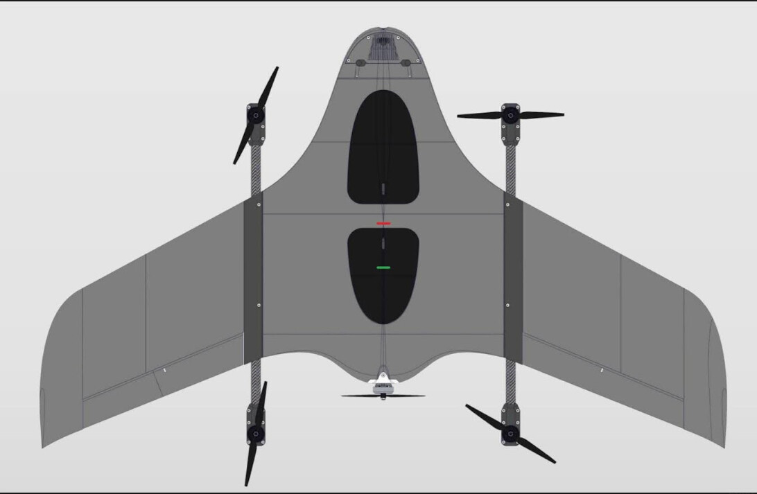

I’ve been working on a 2.9KG 4+1 Quadplanem with 2 elevons and no rudder design, as shown below:
It is a Flightory Super Stingray Design.
The details of my build are as follows:
  • FC: Cube Orange Plus
  • GPS: Here 3 Plus.
  • Wingspan: 1130mm.
  • Wing Area: 31dm2.
  • VTOL Propulsion: 2806.5 1300KV with 7042 propellers.
  • Wing Propulsion: 4008 330KV with 15 Inch propeller.
  • Battery: 6S.
  • The COG for wing mode is about 60mm from the leading edge (Marked in red in image), which is recommended, but for VTOL mode, the drone is front-heavy, and the front motors have to work harder than the rear motors in VTOL mode.

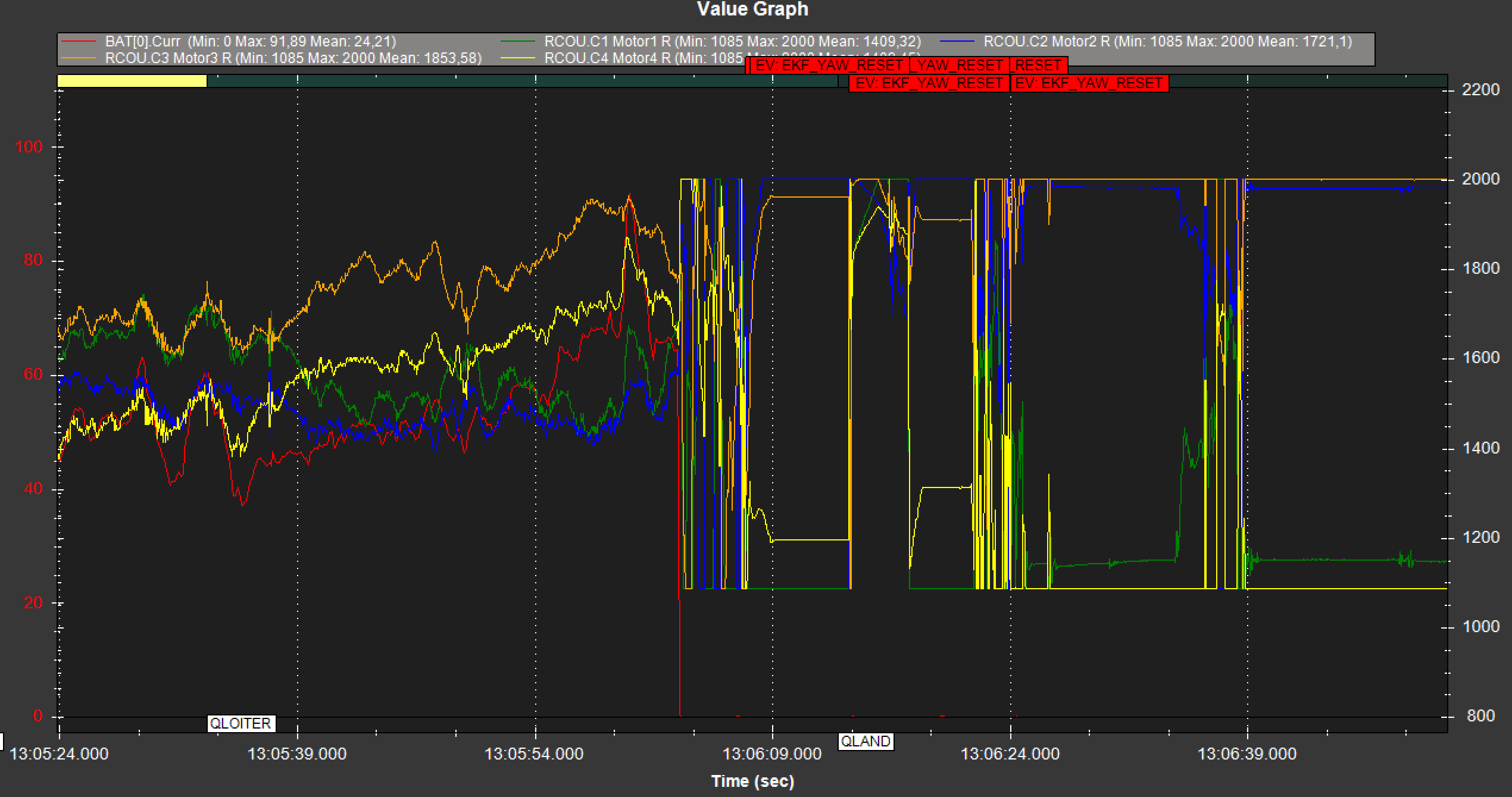

The flight log can be found here:
Can anyone please help me understand what happened?

The power supply (red line) to the quad motors was suddenly interrupted, as evidenced by the sharp drop in power consumption. The Arduplane control system itself appears intact at the PWM outputs and is attempting to raise and stabilise the VTOL. However, this is futile without power to the motors. Without ESC telemetry, the cause cannot be directly determined. ESC shutdown due to overheating or excessive current flow would be a possible cause.
Rolf
What is the ESC are you using ?
And, where are the ESC’s located? Do they have any airflow?

My wiring was as follows: Battery --→ PDB with current sensor + FC Voltage Regulator –→ FC, 4-in-1 ESC, and Wing ESC (all in parallel).
After seeing your comment, it was clear that there was a sudden power loss.
I checked the wiring of the ESC, and it appears fine. There’s no wiring fault or cold joint at all anywhere.
Since the FC was logging at the time of power loss, it means that the FC was getting regulated power from PDB, and only the ESC stopped.
Initially, I thought that it might be possible that the current shunt resistor of either the 4-in-1 ESC or the PDB might have internally broken due to excessive current, causing power loss. I checked the current shunt resistors of both the PDB and the ESC, and both are shorted, so they are fine.
Next, I checked plugging in the ESC to the AM32 configurator, and all 4 ESCs are getting recognized, so that’s also fine.
@dkemxr @juvinski
The 4-in-1 ESC that I used is a Hobbywing Xrotor FPV G2 65A 4-in-1.
It was mounted inside the fuselage with a small 24V 2507 fan on top of it, blowing air away from the FETs. There was a small opening above the fan to throw out the air from the fuselage.
The temperature protection and low voltage protection features were already turned off before the flight.
Do you think that the ESC turned off due to overheating? What else could cause such behaviour?
