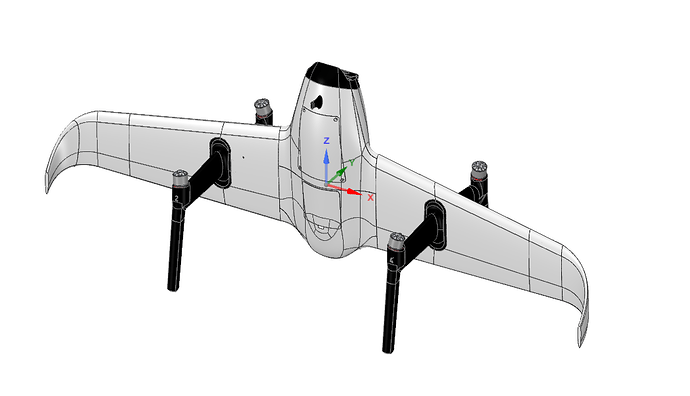

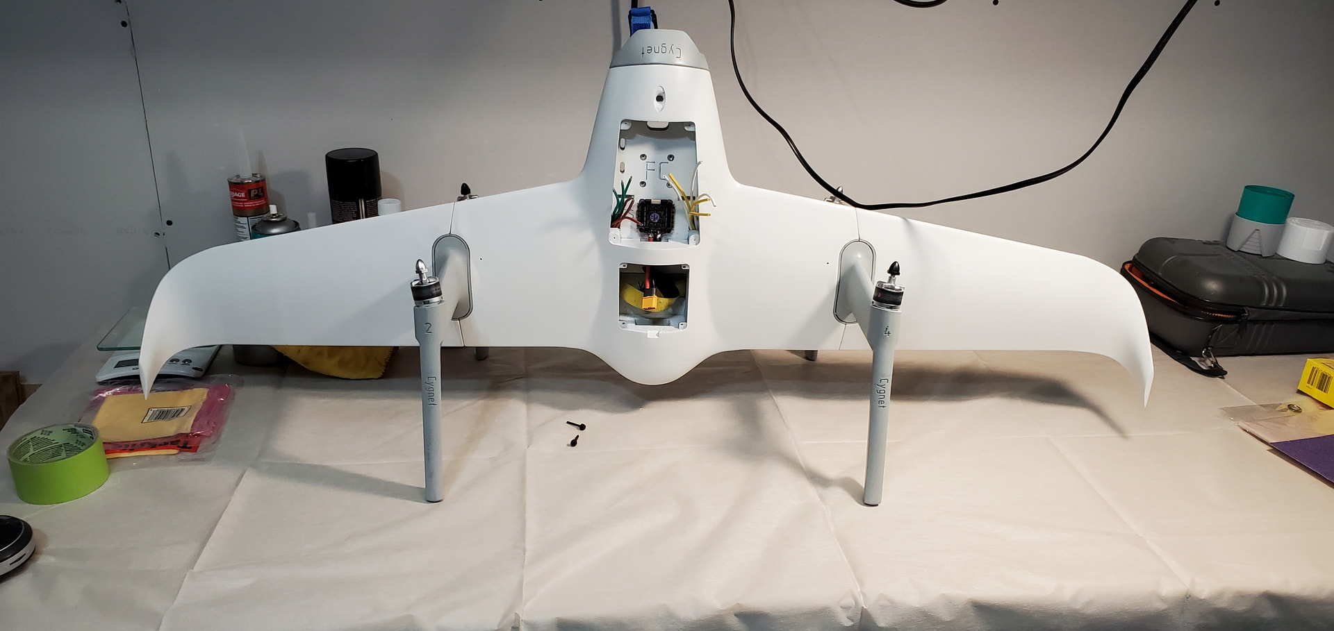

Hello everyone,
I am building a 3D printed Cygnet VTOL by richardg3 from Cults3D and I would like some advice before I go further with the setup in ArduPilot.
This aircraft is unusual because it appears to be a motor-only VTOL, with no elevons and no other control surfaces.
As I understand it, control is done only by motor thrust, and the motor angles are part of the design to help with roll/yaw authority.
I already contacted the designer, and this is what he told me about his original build:
  • wingspan: 1249 mm
  • battery: 4S
  • motors: DYS 2212
  • propellers: standard 9040
  • firmware used: ArduPilot only
  • no control surfaces
  • motor angles were intentional in the design
  • body and wings were printed in LW-PLA, 2 walls
  • landing legs are a weak point and should be reinforced with a carbon rod and stronger material
He does not remember the target AUW, exact CG, or the exact ArduPilot vehicle/frame setup he used.
My situation is different in one important way:
  • I have already printed about 70% of the aircraft
  • I am printing it in PETG, not LW-PLA
So my main concern is that my version may end up significantly heavier than the original concept.
At this stage I am trying to avoid guessing and would really appreciate advice from people who have built or tuned anything similar.

This isn’t unusual, it’s part of Arduplane already. It would be a copter style tail sitter. The guidance is here:
Switching from LW-PLA to PETG is going to be an issue. A quick search on google suggests a 50% increase in weight. So that means motor and prop suggestions form the designer are going to be way off. Get a subscription to ecalc.ch and run some of the numbers, just as a normal quad to see what it’s going to take to get it to even hover.

I read through the tailsitter documentation you linked, and my airframe now looks much clearer to me as a CopterMotor tailsitter with no fixed wing control surfaces.
This model has 4 motors total, with all 4 mounted at fixed angles relative to the airframe, and no elevons or other control surfaces. So from the documentation, it seems the correct ArduPilot approach is:
  • Q_TAILSIT_ENABLE = 2
  • copter-style motor layout using Q_FRAME_CLASS / Q_FRAME_TYPE
  • motors providing attitude control even in fixed wing modes, since there are no control surfaces
My main concern now is the PETG weight penalty compared to the original LW-PLA version. The designer used 4S, DYS 2212 motors and 9040 props, but I suspect that may no longer be enough once my final AUW is known.
I have not finished printing yet, but once the build is complete I will weigh all major components and estimate final AUW before locking in the final motor / prop / battery setup. I also agree with your point that I should treat this as a thrust problem first and check whether it has enough total thrust to hover safely before worrying about forward flight.
One thing I am still unsure about is the motor geometry:
this is a 4-motor layout, but all motors are mounted with fixed tilt angles as part of the design.
In your opinion:
  1. Would you still start with a normal Quad X tailsitter motor layout in ArduPilot for something like this?
  2. Do the fixed motor angles create any special setup concern in ArduPilot, or would you first treat it like a normal copter-style tailsitter and only adjust from there if needed?
  3. Would you recommend focusing only on achieving stable QSTABILIZE / QHOVER hover first, and ignoring forward transition until hover is fully sorted?
If you have seen any similar 4-motor motor-only tailsitter setups, parameter files, or logs, I would be very interested.
Thanks again.
Follow the guidance in the wiki. Start it as a Quad X in Arduplane. As long as the motor angles are fixed, equal, and don’t move, you should be okay (assuming they aren’t too crazy). I haven’t seen the design so I can’t say for sure.
Get it hovering first. Always start with Q-stabilized, then move to Q-hover. Get that tuned first before you try a forward transition. All too often people rush to transition to fixed-wing mode and things end in a mess. Consider that when you transition back to Q-mode the drone will be moving quickly and there is likely to be instability. If the Q-mode isn’t tuned then you’re risking a crash if it isn’t able to handle the situation yet. 3D printed drones aren’t known for their durability in a crash so you probably don’t want to take chances.

If I was to make a bet, I’d say the PETG is going to be to heavy to be practical. You may get it in the air, but it will be maxed out.
Thanks again, I think your warning is probably correct.

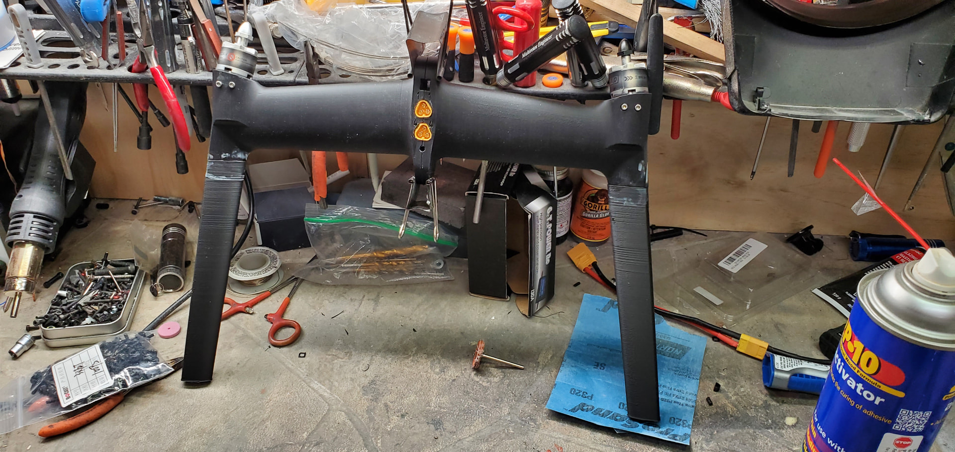

I now have some rough weight numbers from the PETG printed parts, and they already look heavier than I hoped:
  • center section: 923 g
  • landing legs / motor mount structure: 349 g
  • both wings together: about 350 g
So the printed airframe alone is already around 1622 g, before motors, ESCs, FC, wiring and battery.
The more I add up the numbers, the more it looks like the PETG version may be too heavy to be a practical flying version, even if it can technically be made to fly.
