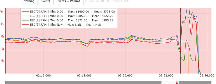

Issue: 3 times now, and completely at random, I will experience a hard right yaw, and immediate loss in altitude resulting in a crash. In the goggles, it appears like an unrecoverable flat spin to the right. All three times I’ve seen it have been to the right.
I’m unable to pinpoint anything that I’m seeing in the logs as the root cause of it, and the ESC and motors are fine. I initially thought maybe a desync, but haven’t been able to confirm anything. I require some expert log analysis to see if anything sticks out at the moment of failure.

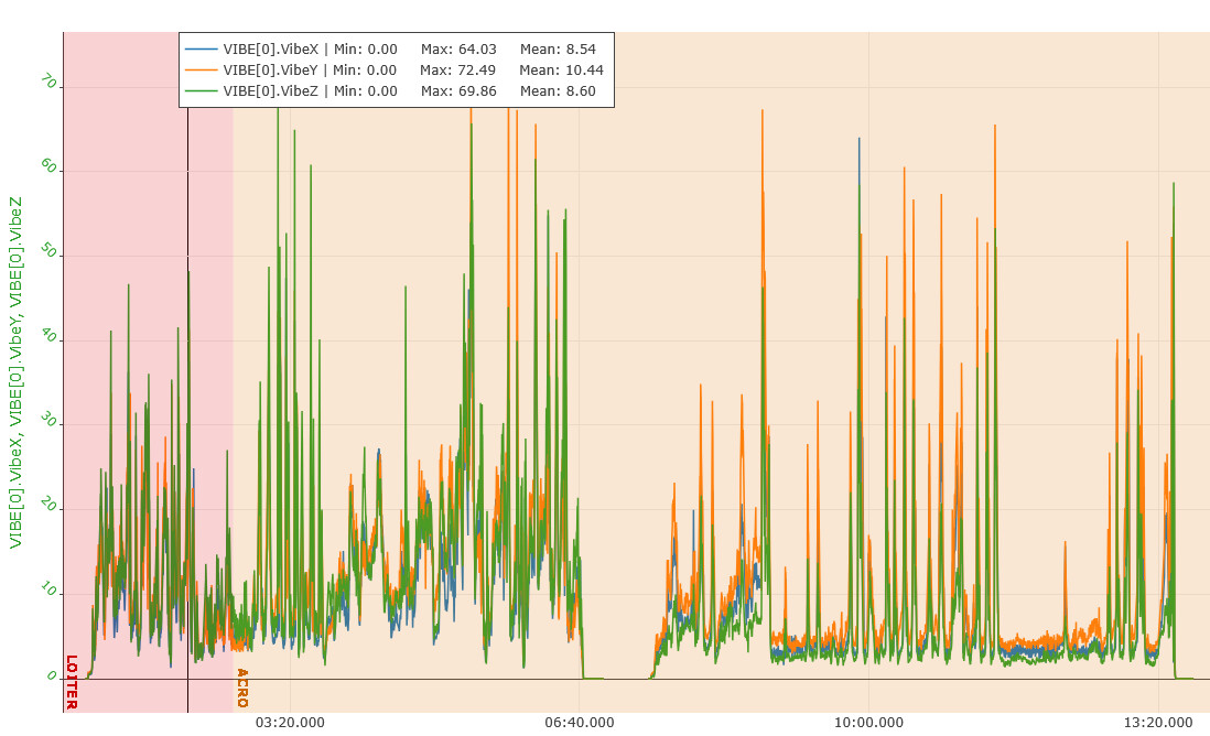

I afraid your frame is too flexible, your vibrations peaking to 70 which is too high.
Also you need to start with the proper filtering, you are using multi source but your attenuation/bandwidth is too high, so it can give unacceptable delay. You need to enable batch or raw imu logging to log gyro data.
Also there is a problem with YAW imbalance, maybe your props not in level.
Than in the end your ESC #3 stopped providig RPM data, which can be caused by ESC failure or desync.
@mike_tk thank you for taking the time to review the logs and offer advice. Super helpful, I’ll work on narrowing bandwidth filters to decrease delay. Unfortunately the flex and vibes are something I’ll have to deal with for this experiment. Like I said, it’s definitely a “less than ideal” build with much better ways of achieving success available. I just wanted to first make sure that there’s nothing going on in the software side (EKF confusion, runaway motors, etc.) causing the uncommanded hard right yaw. It’s a problem that has very recently gone up. The quad, despite all its less than ideal foundation, actually flew and performed quite well considering, for several weeks of intense testing.

We have a couple of 10’’ 3D printed quads. None has vibration levels of 70.
You did something wrong in your 3D model.
@Quadzilla also builds a lot of 3D printed frames, and he also does not report such high vibes.
@amilcarlucas at the moment, I have long unsupported arms. They will soon get a bracing solution or rib geometry to aid in stiffening. Early version at the moment.

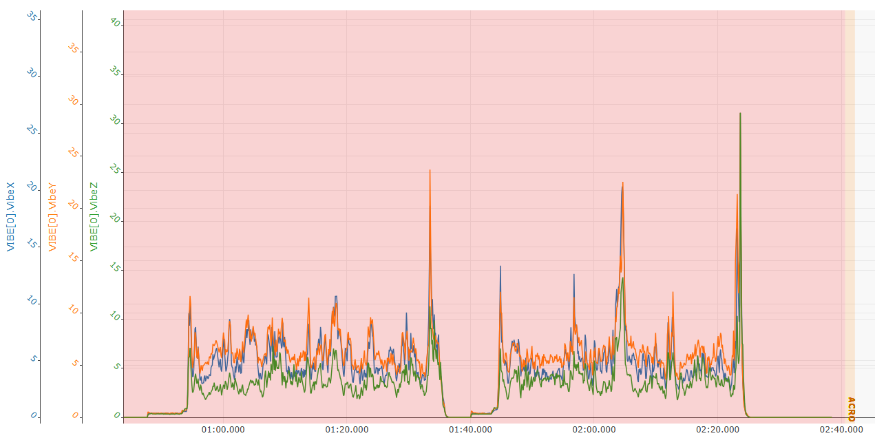

The log with vibes to 70 m/s/s was carrying a rather heavy repeater payload. Here are the vibes on the airframe with no payload. I clearly need to fix induced vibes resulting from the payload attachment, but do these look acceptable or a least manageable for the airframe itself? This is from the desync issue happening in at roughly 1m AGL in my yard with no payload.
Yes, that looks a lot better. Now tune it correctly
