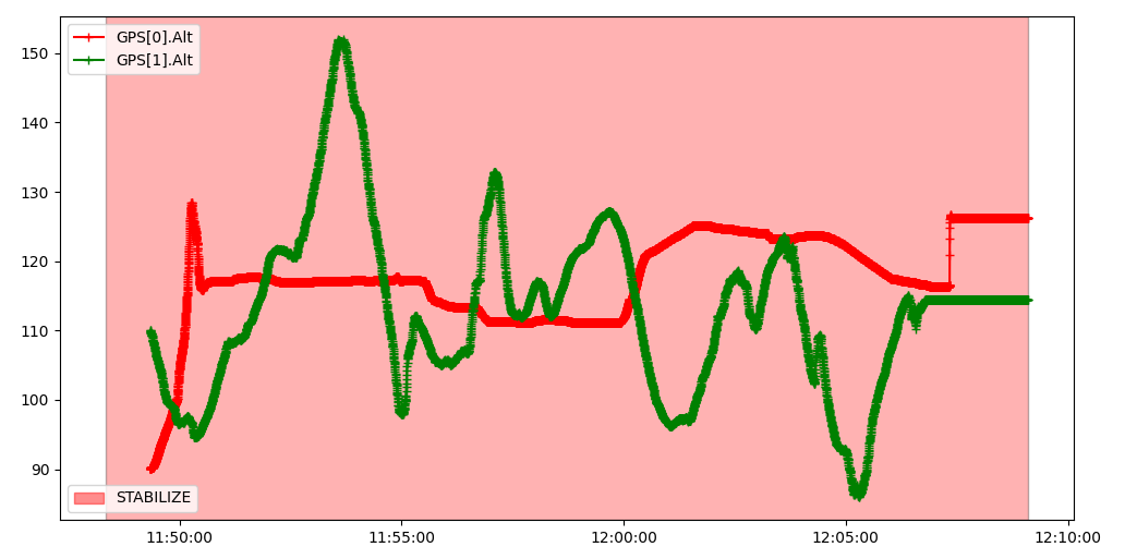

Noteworthy discovery
Red is 15 years old self soldered NMEA GPS chip
Green is a brand new China made micro uBlox Galileo receiver.
