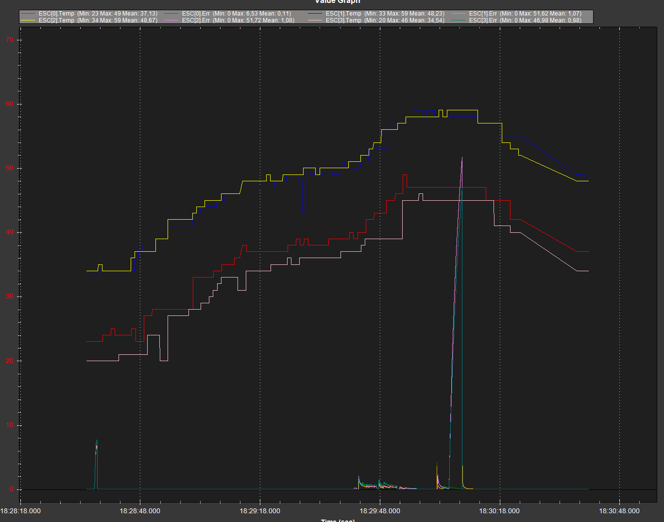

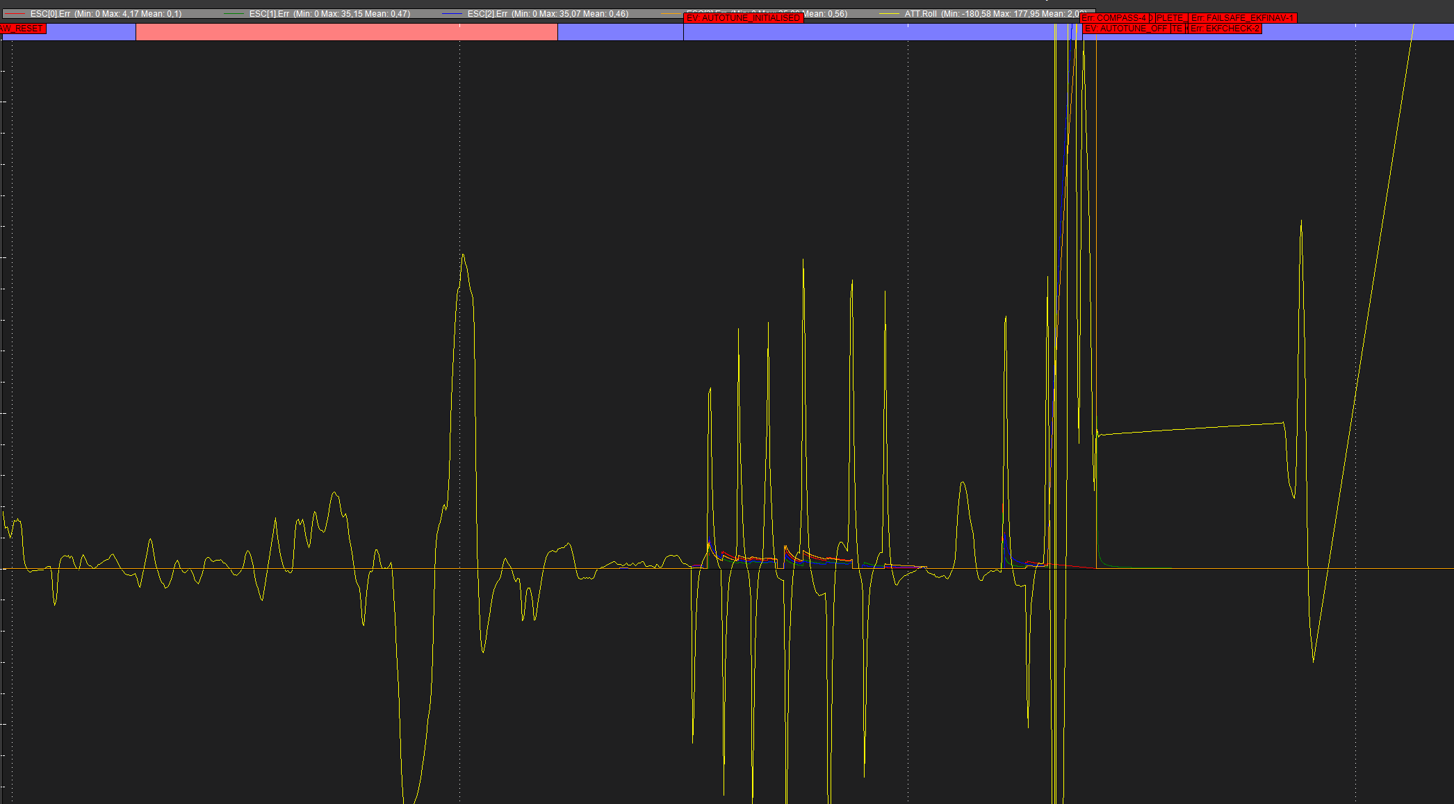

I’ve crashed my 18" 5210 6s 5.4kg auw quad while trying to autotune,
imo from the logs that’s some ESC failure because RPM looks strange, but it’s 4in1 can it fail all at once?
Anyone can suggest what’s the cause?

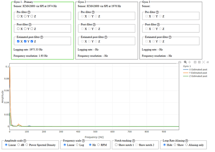

It is possible that your filtering could be the cause, I adjusted your notches based on the flight bin that you provided and below is what configured. Heavy notches and harmonics and make your quad really sluggish, slow to respond. Did you quick tune prior to autotune? I am not a pro but learned a bunch from the Dev team here, maybe they will weigh in. The Idea with filtering is minimun needed, I have one quad that I have zero filters set except the gyro because it has very little vibrations. The filter profile that I used for your quad gets most of it gone. I would reset my filters do a test flight/hover to see if it is working, then I would do a quick tune and see how it is flying then.

Well it does NOT look like the failure of any one ESC or motor.
It appears the entire ESC stopped responding, or maybe it’s tiny little connector became dislodged. I secure the ESC connector with hot melt glue. Take it for a ride in the car, that always finds any bad connections :slight_smile:
Temperature does not appear to be a problem.

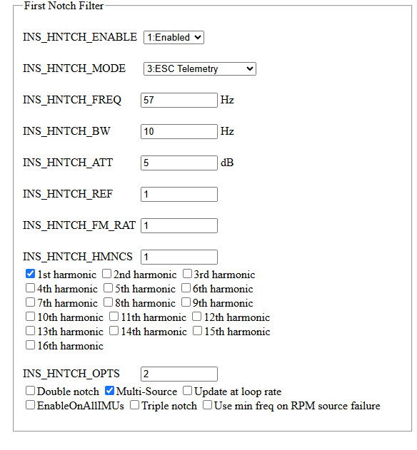

Change
INS_HNTCH_FREQ,40
INS_HNTCH_HMNCS,1

Yep, for me it’s also looks like the whole ESC stopped responding - it was looking like disarm - all motors stopped spinning after 3rd autotune wobble. The currents are not big, but the motors are 5210 with 18" props, can it be caused by voltage spike while motor breaking? But all 4 escs?

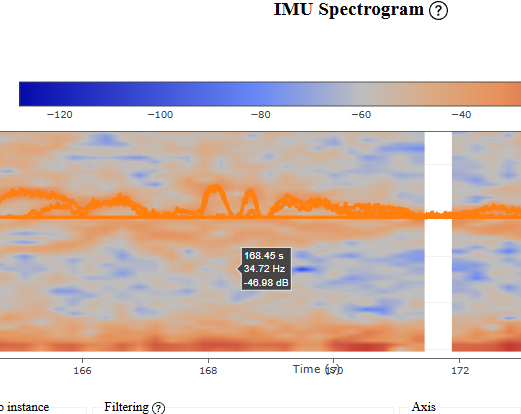

I see the noise at low as 35 hz, might be that setting it 57 hz cutoff is too high?
Are you saying to use “INS_HNTCH_FREQ,40” instead of 57hz because that’s where the noise beg point is?
Still learning…

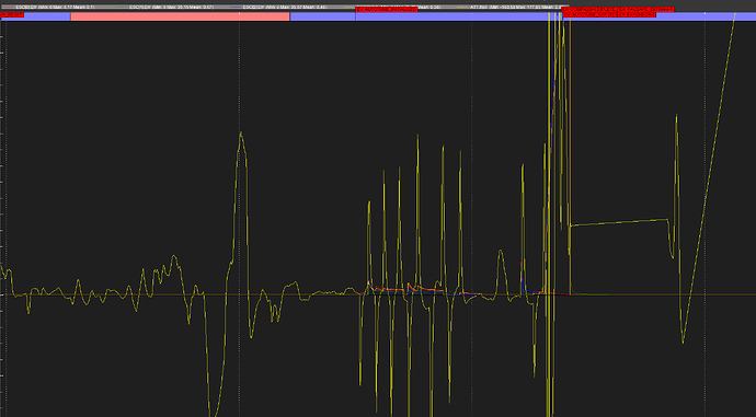

It didn’t stop responding, 2 of them were in error and down it goes. Why Dshot300? 600 is generally more reliable.
Good catch, thanks, what actually esc.err measuring?
I’m using cheap 4in1 esc running bluejay 0.21-rc1, it’s stated 70a 12s but not much truth in that, the wires are shortest they can be but still it’s 18". About dshot300/600 I thought that lower speed is more reliable.

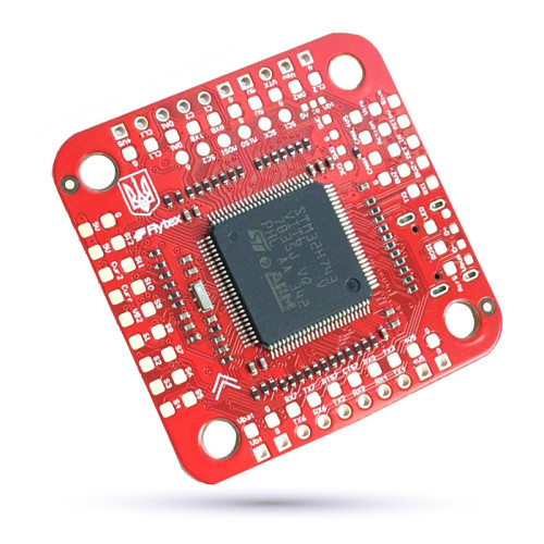

Graphs shows that errors on the beginning and than started to appear on autotune start. Can this errors be caused by FC? It’s some matek h743 clone, not original one.

That’s not 1to1 clone, it just have same components and pins layout, so it can use same firmware.
Can it be just overheating? Looks like the falling ESCs report highest temperature, but flight was very short. The current sensor is calibrated so the actual consumption was like 20a for whole rig, did not expect that such current can overheat esc.
If those temps are correct it’s not hot enough to be “to hot”.
Because 40Hz is about the lowest frequency, and the ESC telemetry option will scale up the harmonic notch frequency and bandwidth as required - but not down.
Gotcha, thank you for that information.
Agree, it’s not close to 80c, but by some reason exactly this 2 esc was hotter and they failed.
But rpm data is still looks strange, only 1 failing esc was reporting rpm that looks like real
@mike_tk that FC picture seams to contain a logo of the Ukranian army.
What is the application of your vehicle?
Flytex - a leading Ukrainian manufacturer of components for unmanned systems
