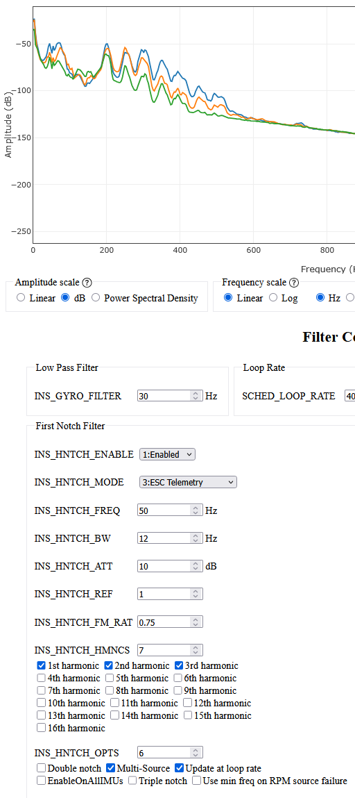

Filtering is much better in 1st flight, in 2nd you have too much delay from filtering.
Try filtering like that.
With multi notch the freq and and attenuation should be much reduced else it will give you too much delay, it’s stated here, yellow warning

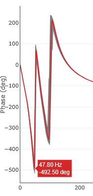

You get like 500 degree of phase delay at 48hz in last flight, which roughly translates like:
(if you assume that 1hz=1000ms)
1hz/48hz*(500degree/360degree)=~0.0289s=~29ms delay only in filters.

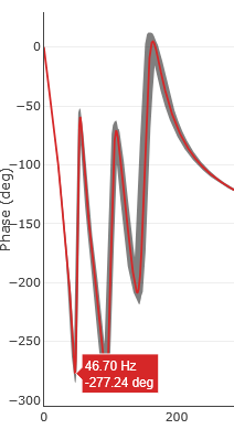

With proposed filtering you get 280 degree at 47hz
Which translates to ~16ms delay which is still high but much better that first one.

INS_RAW_LOG_OPT,10
Also check your throttle controller, It might have too small I
PSC_ACCZ_P, 0.45
PSC_ACCZ_I, 0.9
Finally in AM32 settings I’m not sure for Sinusoidal Startup, I always thought it for crawler rovers. I usually enable automatic timing advance.
It’s a common misconfiguration to enable these with the other parameters you have properly configured.
SERVO_BLH_MASK
SERVO_BLH_OTYPE

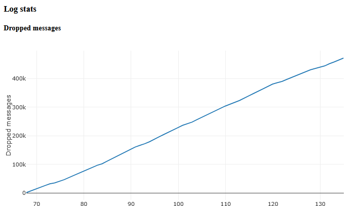

IMU Spectrum is all over the place, whats that about?
I reverted INS_RAW_LOG_OPT in case that was the issue: https://drive.google.com/file/d/1HS1J_1kRg4icjq_y10RR8bEDHgoviCL0/view?usp=sharing
Try disabling the bath sampler INS_LOG_BAT_MASK,0
What was the reason you are using Dshot300 and not 600? It’s probably in this thread somewhere
10 logs all gyros. A shitload of data with Raw Logging.
Ok, I tried disabling INS_LOG_BAT_MASK and reenabling INS_RAW_LOG_OPT to 10, same results… unreadable spectrogram.

Notch Filter looks OK. Did you re-check the Motor Ranges ? MOT_SPIN at 20% looks very high and why is Max at 65%? All else looks OK for where you are in the Tune process.

The reason can be too slow SD card or just too much logging, 3 gyros at 3.2khz are very much data, maybe switching to just batch logging is an option.

Filtering looks OK so I think you can try to do quicktune or autotune.
