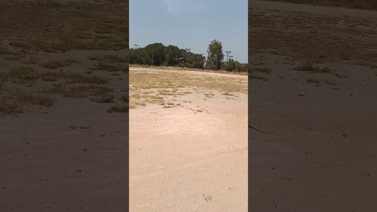

My apologies for the confusion earlier. I had some reservations, so I decided to test the Pixhawk 2.4.8 on a rover using the copter firmware, and surprisingly, it worked!
Encouraged by this, I then tested the Pixhawk 6X with the rover firmware, only to encounter the same issue:
Therefore, it appears that the issue does not stem from the Pixhawk hardware version but rather from the differences in the software between the rover and copter firmware.
